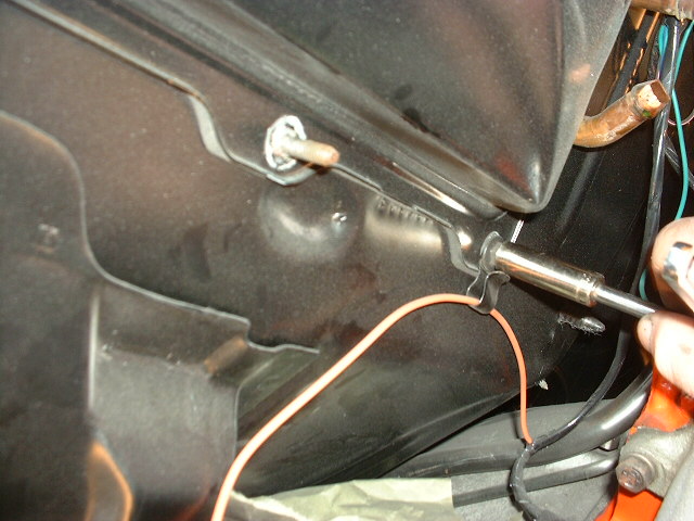

These are the stamps on the firewall of my red LS-6 convertible going to Barrett-Jackson. There is no Question on these. Look at the Vin it is partially visable under the heater box. Yes we dissassembled this car to get these pictures. With all the questions arissing on rebodies this was a smart move!!!!. Jim

This is the viev of the exposed numbers. Jim
