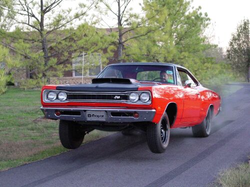

I see that SuperBees are going 12.08 at 113 now days. What gives? I wonder when the powers that be will step in and say enough is enough? Pure Stockers at 12.08 and the FAST guys can't even get them to go that fast! This may be the beginning of the end to anything close to the real deal! I'm waiting for even some of the MOPAR guys to scream foul but I may be holding my breath for a long time. ![]() JIM [/ QUOTE ] I'm sure that you're talking about the R4 Six Pack Bee that I raced in F.A.S.T. up at Musclepalooza. Let me say, that, the car that I raced is actually a lot closer to Pure Stock than F.A.S.T. I built that car before F.A.S.T. and the Pure Stock Events were around, so I built it my way. It's a .030 over, measured 11.9 to 1, 440 with a flat top piston .010 out of the hole, it's got a small solid cam from Straightline, roller rockers, the heads are stock with just gasket matching, and the intake is gasket matched. It has absolutely nothing trick. Up in New York, with non treated tires ![]() ![]() Check out the attached pic! Wayne

Yow!
![]() ![]() ![]() ![]() In yer driveway?? ![]() ![]() ![]() ![]()

Jeez thats some srious air ! What the hell you got in that trunk !!!
