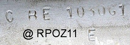

If that's a CBE1030 axle, I'd guess that it's a service part. Could be from a last week of 69 car, but it would be pushing it vs observed data.
Not sure what your question is in your last post.

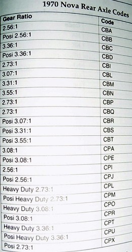

I have found this table, with these axle codes added:
(all were for the NOVA application of 1970)
CPO-"Heavy Duty"; change COC to CBQ; new codes CBI, CPL, CPM, CPT, CPU
The chart attatched provides what codes are known...
The Camaro codes seems to be in the COA-COZ & CRA-CRY order, so if you suggest a CBE, this would be...?

Here is what I have....

So, As I approach the list I provided, with added updates, and as I read the quote here above, the 4:10.1 was not on the list and should be a special order?
