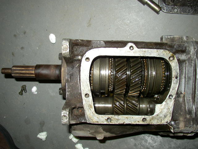

Some aftermarket input shafts do not have grooves to denote M20 or M21 ratio's. It may not be an original GM input shaft.

Like I said....Count the Teeth on the input GEAR, not the splines on the shaft. M-20 = 21. M-21/22 = 26.
The exception is the very early M-20 with 24 teeth.

Checkout Charleys M-22 pictures he's selling in the Parts for sale section.

looks like M21/M20 gear cut.
Looks like---
Is there a production #? A=M20,B=M21 -----ex. like on Charley's M22

Or do like Zman said count the teeth on the input gear---
