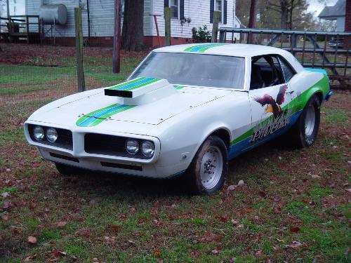

Having some fun with 11 second Bird.

Yep, strange looking, isn't it? This was the Royal Pontiac 350 F/S car that Royal prepped and ran using the 350 H.O., then later used the same car to test a RAV 400. The car has double hood tach nacelles too.
With the RAV, it ended up running 11.65 at 121 mph, and it was a tired test engine.
