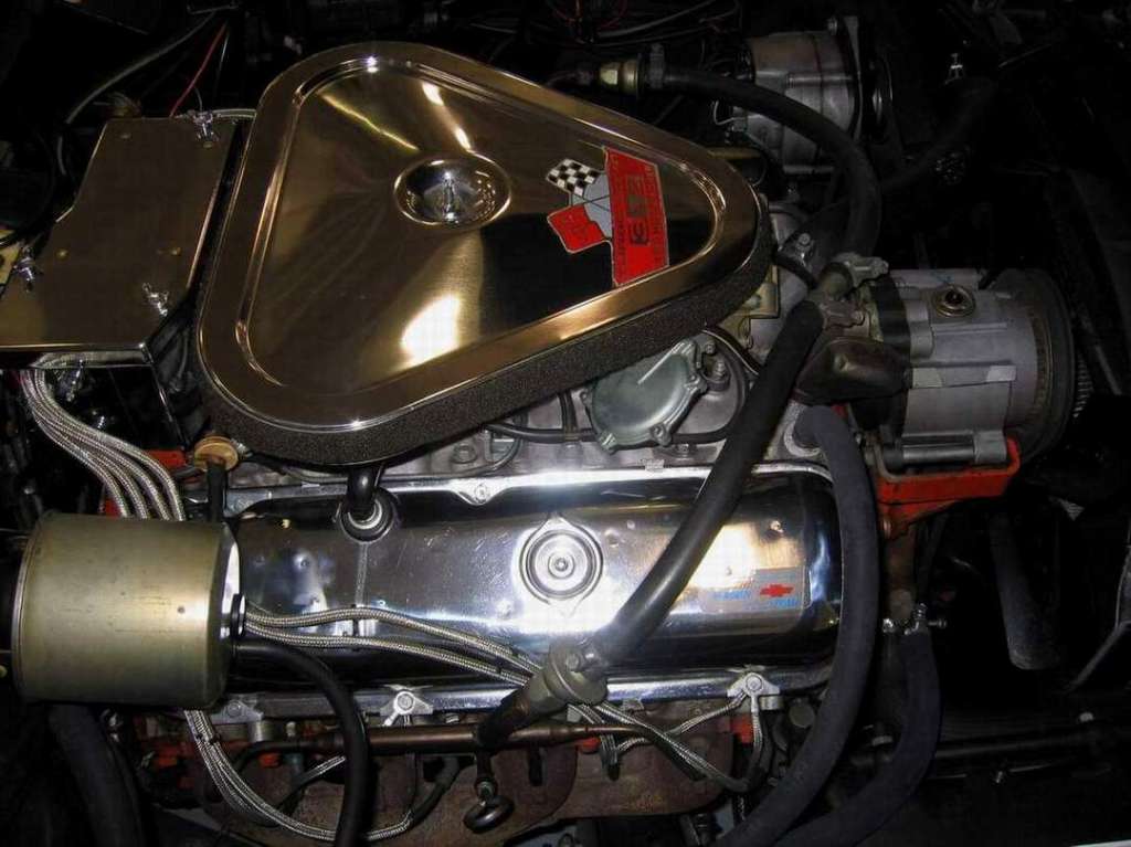

Pic of a low-mileage, Bow-Tie/Survivor '68 427/435 w/L89. Spot welds on the covers are very obvious here.
