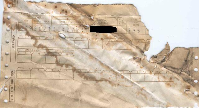

Was it a build sheet or a body broadcast sheet? I'd love to see a Nova build sheet, I thought they pulled them all out of the cars at Willow Run!! (Can I have a copy??)

JJ's 396/375 horse 69 Nova came with a sheet. What's the difference between a build sheet and broadcast sheet. I know what my Chevelle build sheet looks like, but the Nova's is smaller, but lists all the options. Is this what you call a broadcast sheet????

Default Re: 69 SS nova big block car ????
Pete;
Yes, the body broadcast sheet is approx. 5" x 8", and lists the frame sequence #, build date, body #, interior code, and then in the option boxes it lists some of the options - but not all of them. I think those options that relate to the body are listed, you usually don't find things like J50/J51 for power disc brakes, but will find N10 for dual exhaust (extra plate on frame rail), B84 for side moldings, M20 for the trans (different exit hole in firewall for speedo cable), and sometimes L78 for the engine - I haven't seen small block codes though. I am starting to think that there were different broadcast sheets for different areas of the car, but that is just a theory because when we find multiple broadcast sheets in a given car they have always matched each other. I'm always looking for more!

Sample of nova 69 Broadcast sheet found under the rear seat.
plain Jane 6cyl nova.
