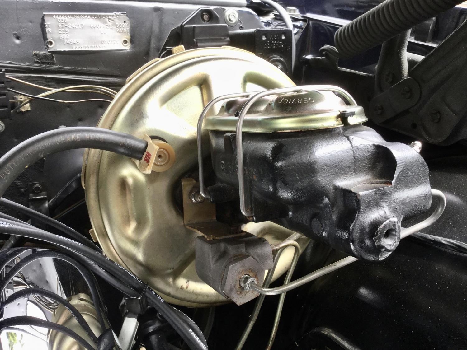

If you elect to keep this added disc brake option on your ‘67 I would SS sleeve everything front to back.
Four piston calipers
Master cylinder
Rear cylinders
Check the proportioning valve that’s circled in your photo.
The master cylinder is unique to 1967 disc brake as I show in the photo of the ‘67 HO I restored years ago.
BTW, your WT 335 HP has the added HO exhaust manifolds which require a completely different engine wiring harness.
But that’s another day.
Good luck on your project.
----That is a unique master. Can't remember ever seeing one....Bill S

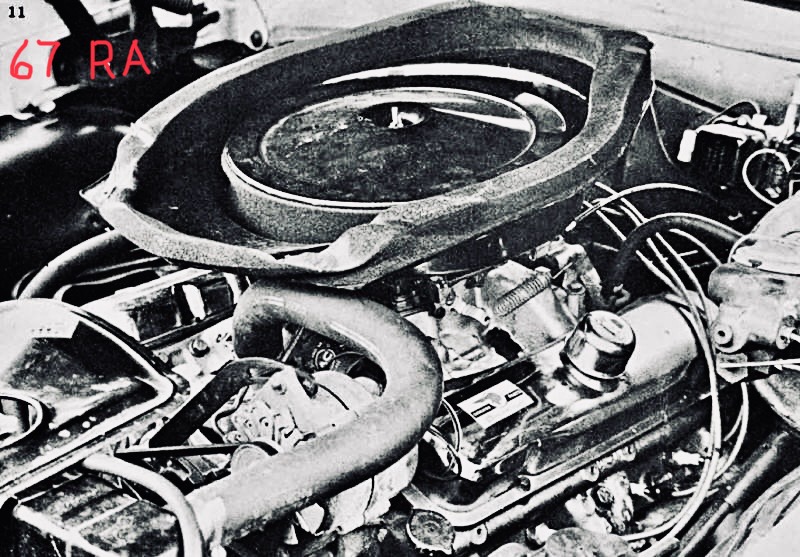

I had someone question me privately about my photo of the smooth rounded master cylinder on my restored ‘67 GTO that was built at the Fremont factory with power front disc brakes.
Here is a New ‘67 RA from a magazine test article showing the same M/C and Proportioning valve.

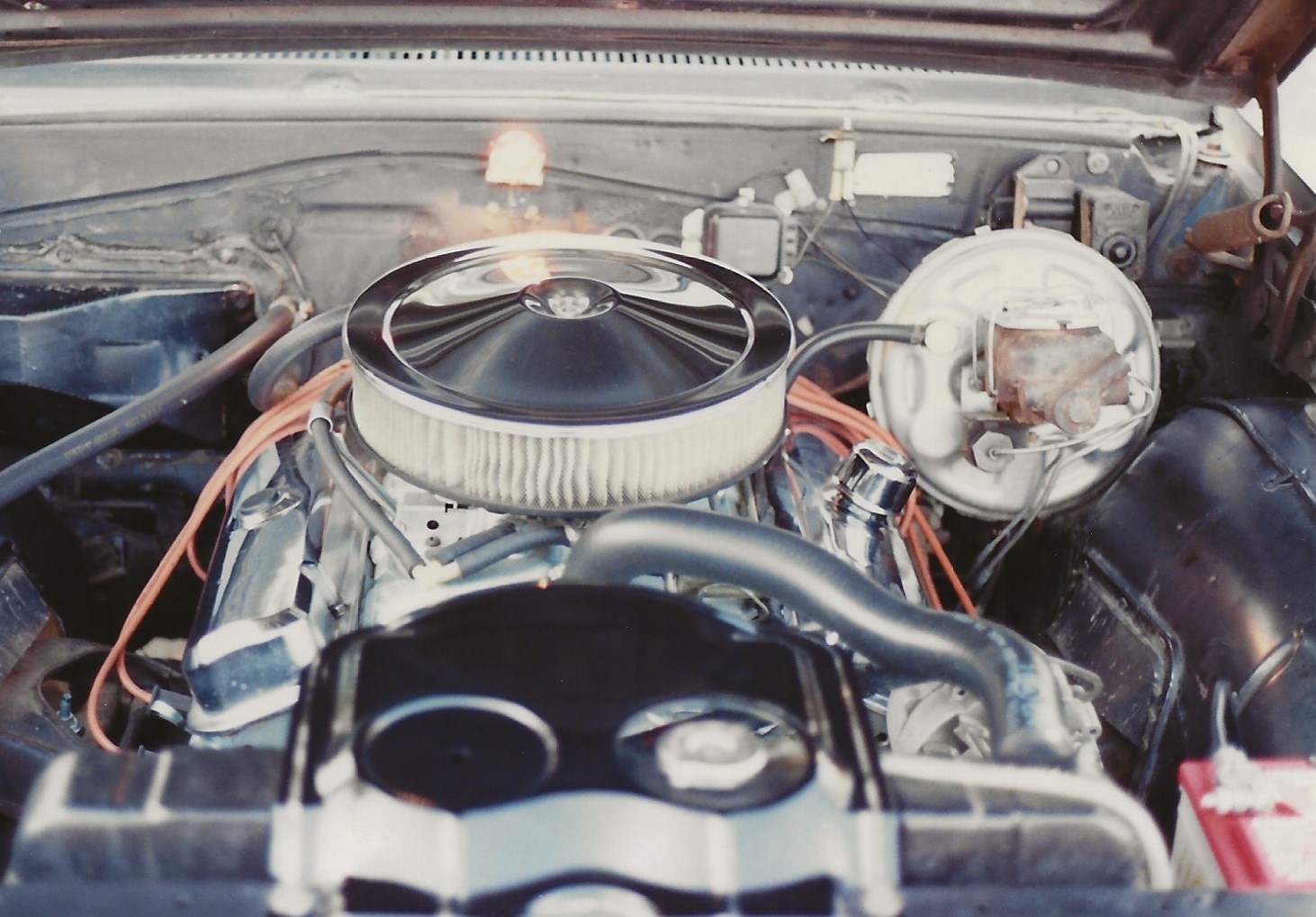

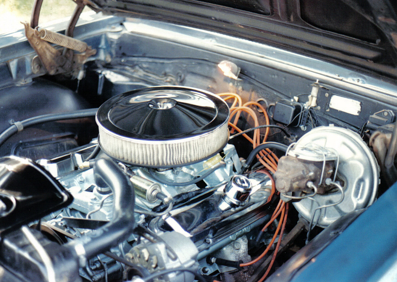

My old '67 had the same style master, not sure if it was the original to the car, but the disc brakes were.
