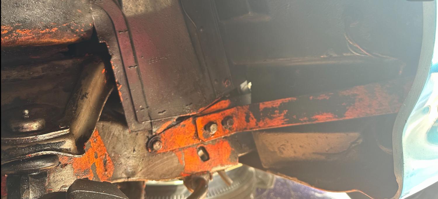

I purchased this Corvette from a friend that's on this site. Tim did a great job of representing the car and I was very happy when it arrived. One thing he made clear was that sometime in its life the entire undercarriage was painted orange and to correct this, someone painted black over the orange. This sounded like a nightmare, but I liked the car so much, I moved forward.
Here are some before and after of the chassis after 80 hours and lots of paint stripper, lacquer thinner, steel wool and mineral spirits. Everything took four coats of stripper to get the black and orange off. I was able to preserve much of the originality of the chassis.
Ice blasting would have been easier, but I figured it would have cost about $4,000.

As expected from a true fanatic, the result is astounding. I was drawn to that car like moth to flame when I saw it in Rochester. I was so surprised/excited when Tim WI announced he had bought it. The color combo, other than the black top, is about my favorite for that year. Knowing it came with white and you are correcting that makes it perfect.
My question is, at what point during this process did you question your sanity for NOT taking it for dry ice blasting... I feel certain that thought went thru the gray matter, maybe more than once. Been there, done that with processes I should have jobbed out.

Mitch, I have a friend that used Ice Blasting and they were a bit too agressive on a nice original '67. I wanted to control the porcess and I wanted to keep the cost in line. The sweat equity really bonds me to a car when I revive a chassis. I have a 17000 mile 1970 to approach next. It was undercoated from new and will be much like this project.
I questioned my sanity after working on the left rear for 10 hours one weekend and seeing good results, but wondering if I could get the same results on the rest of the car.
I can still go back and find more to do if I look. Everything was orange/black, control arms, front and rear springs, wheel wells, sway bars, half shafts, splash shields. The worst part was removing the gloss black paint to see bright orange, I felt worse as I progressed to see more orange.
