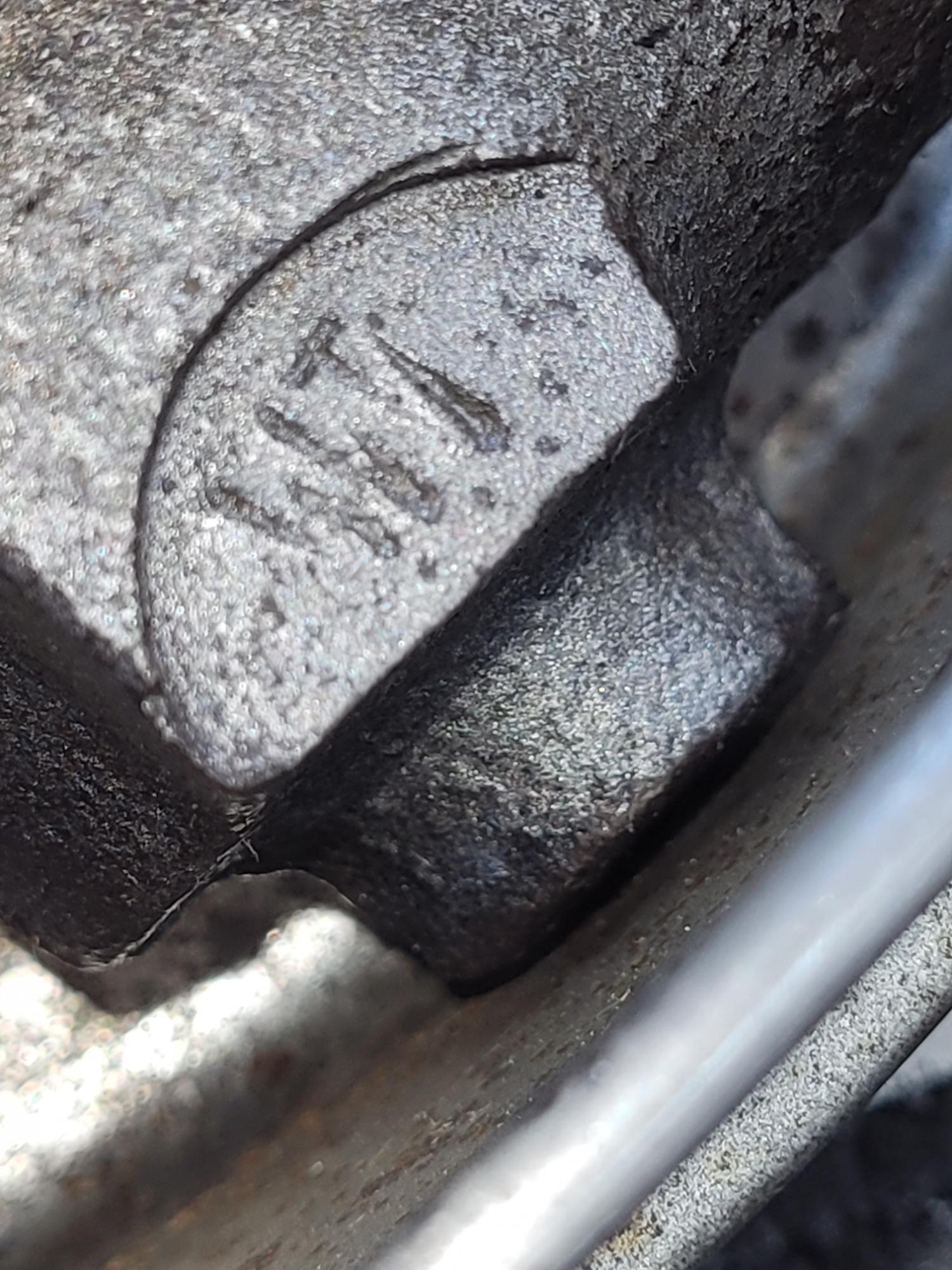

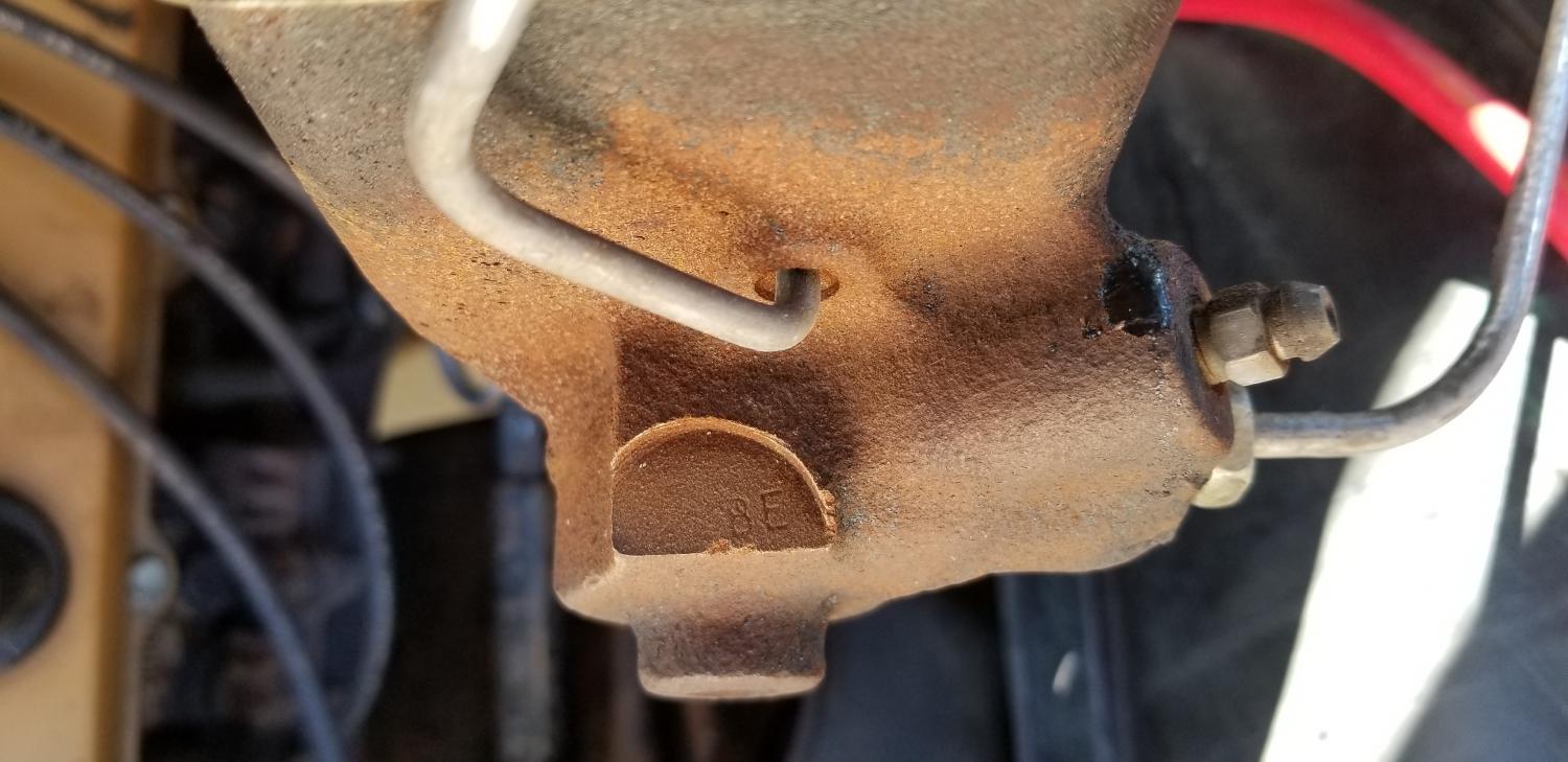

I thought a list of the different master cylinder codes could be helpful. The codes appear in the 68 and newer Buick, Pontiac, and Chevrolet chassis service manuals. Anyone able to add the Oldsmobile codes (section 5 of the manual) or the 1970 Chevy?
I kept the list short and simple, so there may be more info in the service manual.
