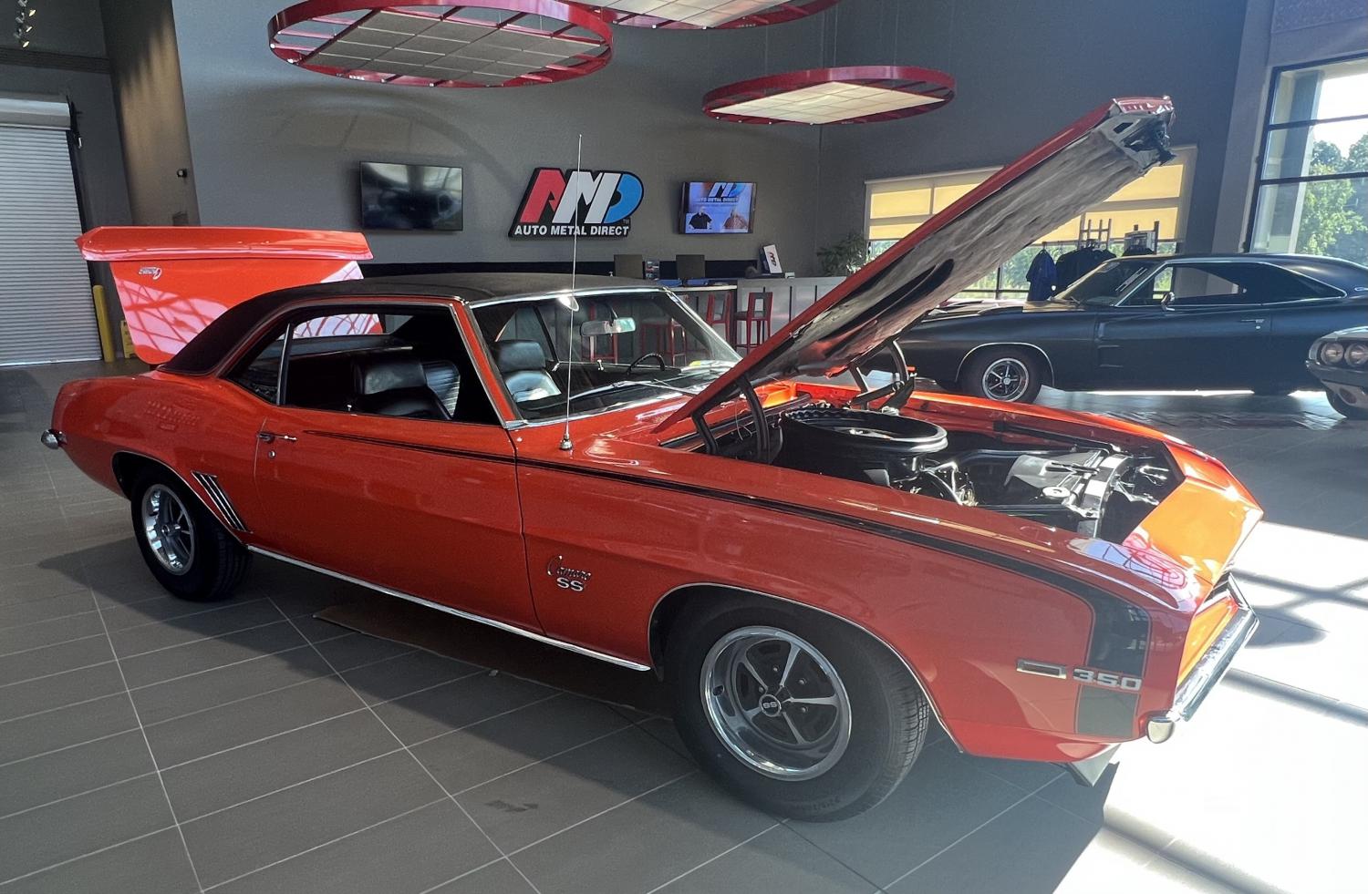

Progress! My crossmember was looking pretty rough, so I wire wheeled it, and shot it with some primer and paint to clean it up. I was able to get the flywheel resurfaced and balanced with the pressure plate. I started putting it back together, but one of the tabs on the clutch fork was broken and I thought I was done for the day at that point, but since I'm only 20 minutes from Auto Metal Direct I was able to source a new one and get the transmission back in. They had a sweet 69 Camaro SS350 automatic in the lobby, so it was a good excuse to go!
Still have to get the reverse lights hooked up, shifter handle/console plate reinstalled, driveshaft in, exhaust reconnected, and plug the distributor back in and re-time the engine, but I'm getting close now!
