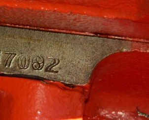

Here's an interesting one where they changed the 9 to a 6 on a 435 horse '67 Corvette.

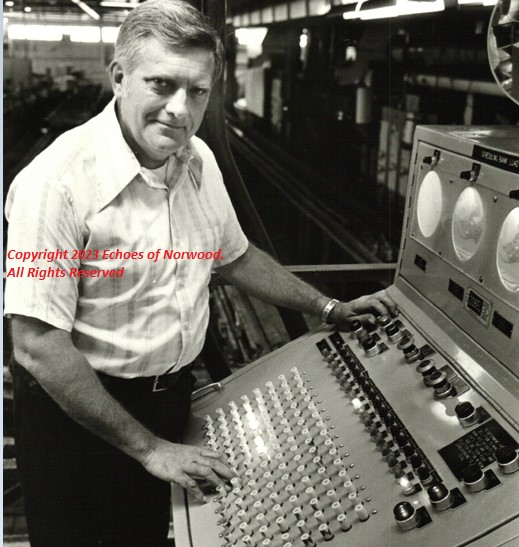

Keith,
Actually there were two. Fisher had the Surge bank and Chevrolet had the body receipt bank. When the plant ran on a two division format for operations- both were used.
By 1972 when GMAD took over the old Chevrolet body receipt bank was bypassed and abandoned. That general area was converted to a decal instillation space for a period of time.
GMAD expanded the Surge bank on the body shop side added a plant wide computer interface and controlled all accumulation from that point.
You can see the old Fisher surge Bank/GMAD accumulator rails pictured behind the operator in this image.

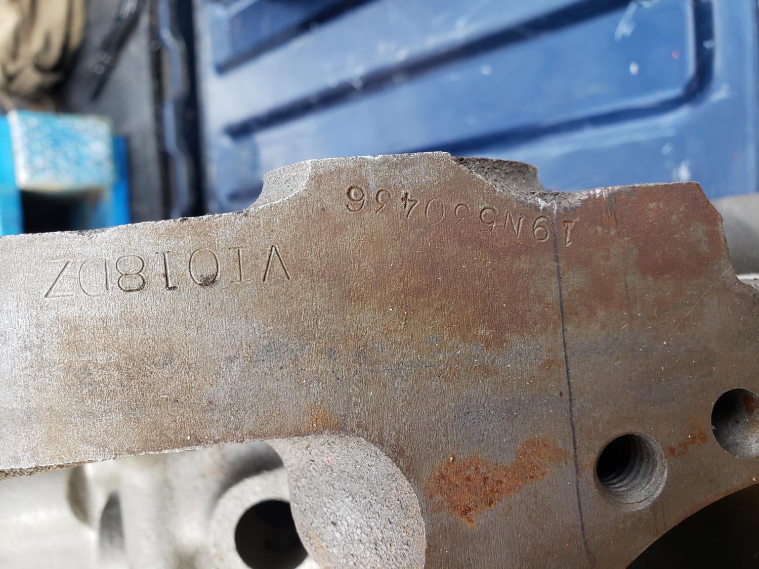

Thanks for all the information folks. I am going to post photos of stamp once the engine lands at my shop. Bare with me old, ugly and slow.
Chris Slawski
69 Nova
69 Malibu
69 Camaro RS
69 Camaro SS 396
  #30
Old 03-22-2023, 08:16 AM
chris slawski chris slawski is offline
Join Date: Mar 2012
Location: New Jersey
Posts: 398
Thanks: 185
Thanked 115 Times in 64 Posts
Block stamp
