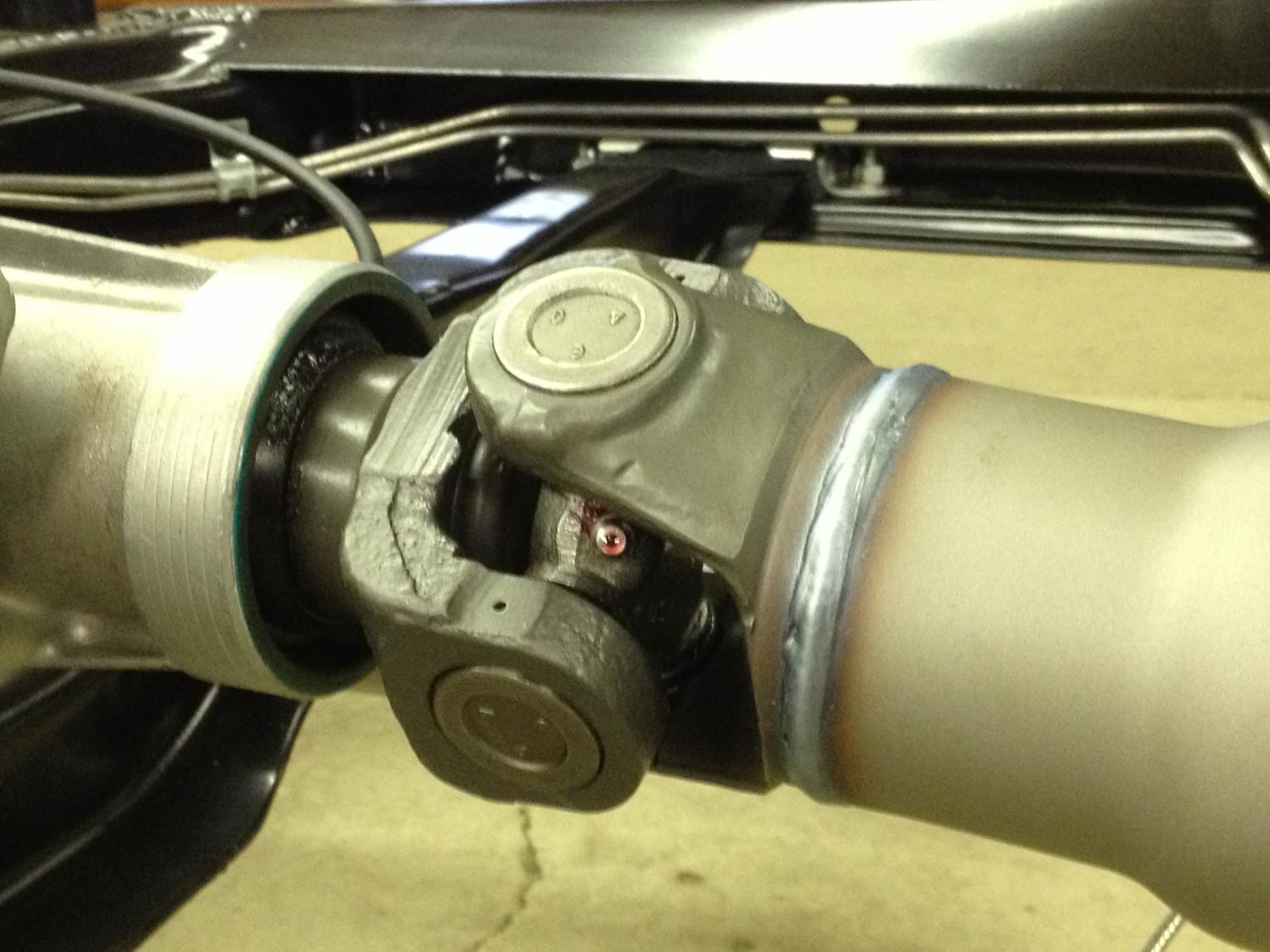

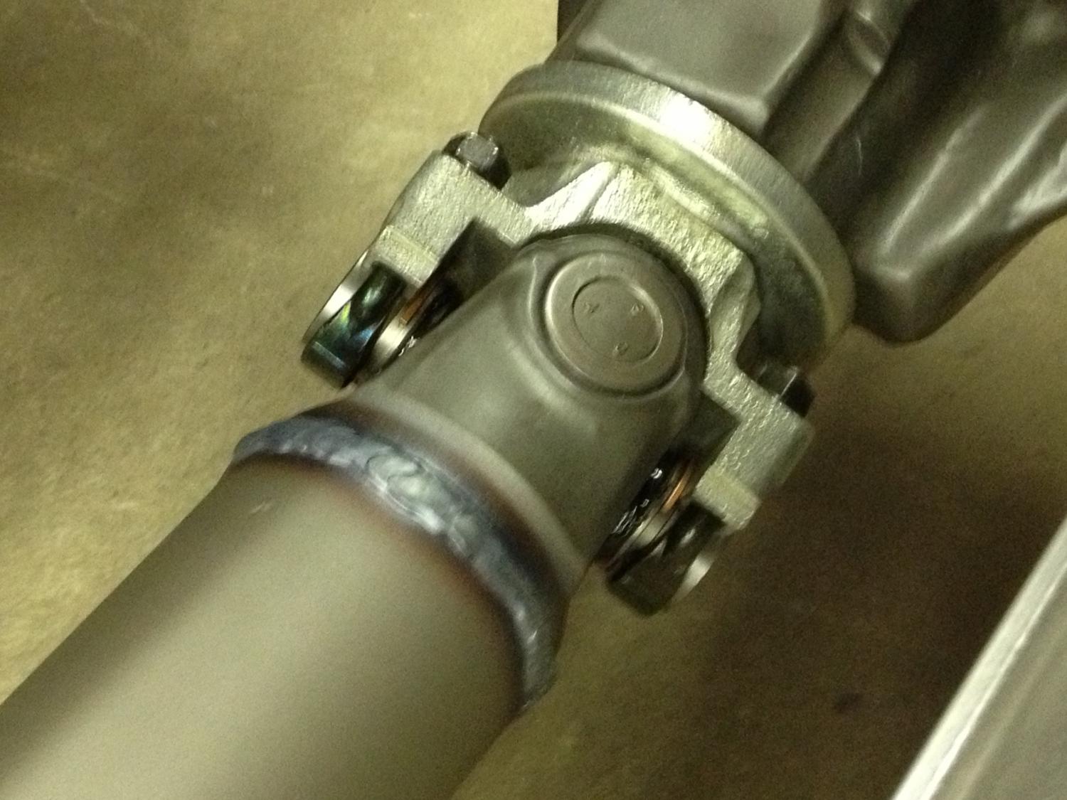

Yes, The "Welded" Look. Couldn't quickly locate any photos of the axles ive done but this is a Driveshaft f01 a 71 Judge that we Airbrushed the Welds. Impossible to tell that its not real

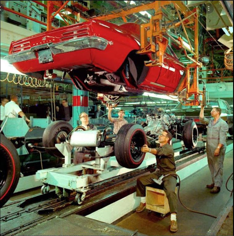

Amazing how shiny that Lacquer paint was back then

Very similar to how I did mine but went a little more champagne color on the weld itself otherwise identical .
