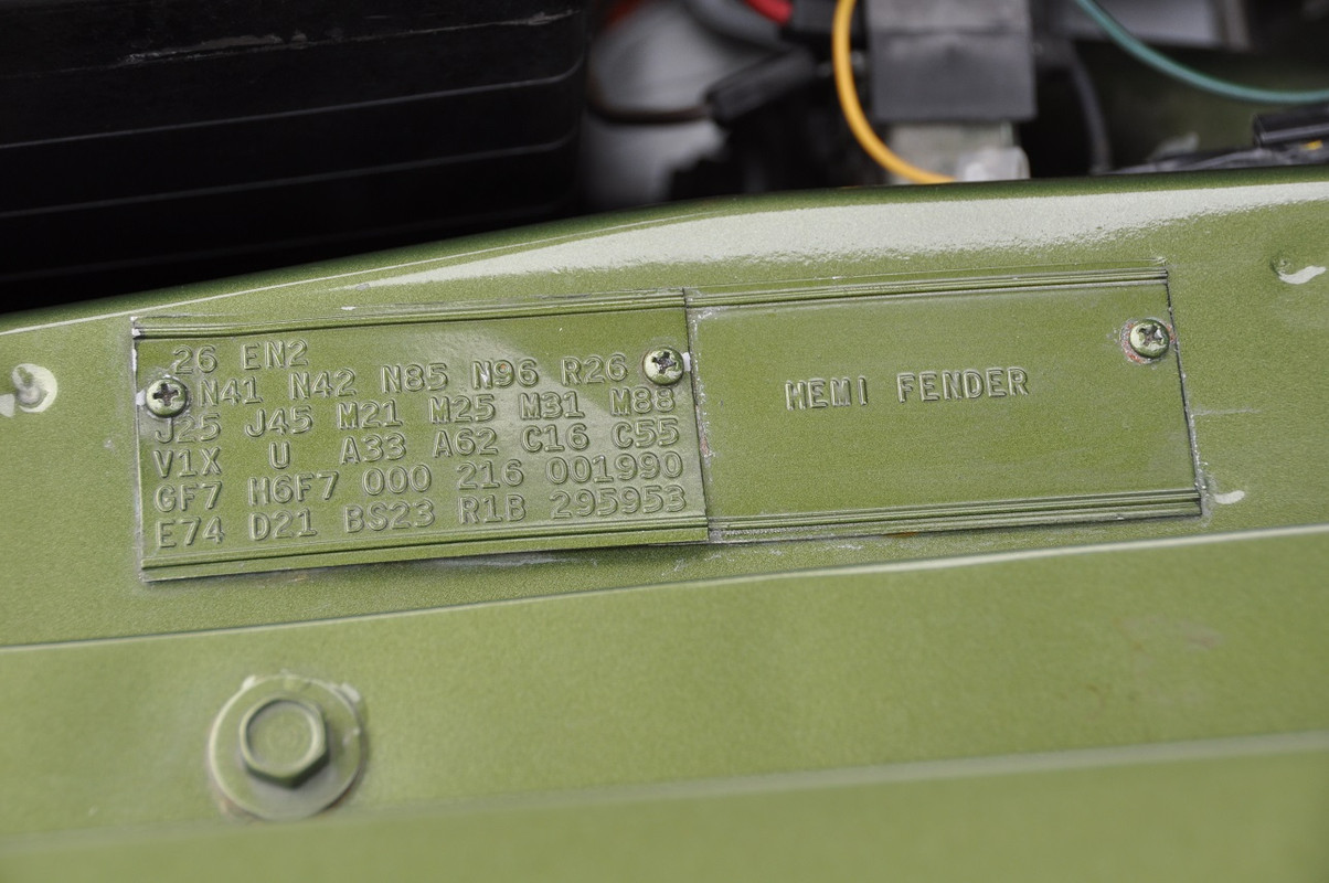

Absolutely they were rolled. The Hemi Challenger I bought from the OO and restored back in the 80's had them. Original fenders were rusted so I bought new ones direct from Chrysler. One side was still available with the rolled lip, the other side I had to have the body shop roll the lip to match. Must have been some really tight clearance such that an F60 required the rolled lip but the E60 did not.
BBBill, the F60s were part & parcel of the package you got when ordering the 426 Hemi engine. Apparently n/a with other engines so no need to list them as an option. Same deal with the tires that came with the AAR Cuda and T/A Challenger.

HEMI cars did not receive E60s, only F60s. Your 340 car would have received E60s, however I have seen 340 & 383 cars that were optionally equipped with 15-inch wheels get rolled fenders, even though not a Hemi car. Have a look at yours.

When the Challenger first came out there was an option called A66: Challenger 340 4-bbl Engine Package which cost $258.90. Included with this option were E60x15 RWL Polyglas tires on the new 15" Rallye Wheels. Later in the model year the E60s were dropped as standard equipment for the option.
Unfortunately many of these were converted to R/Ts so only the fender tag will tell what it is.
