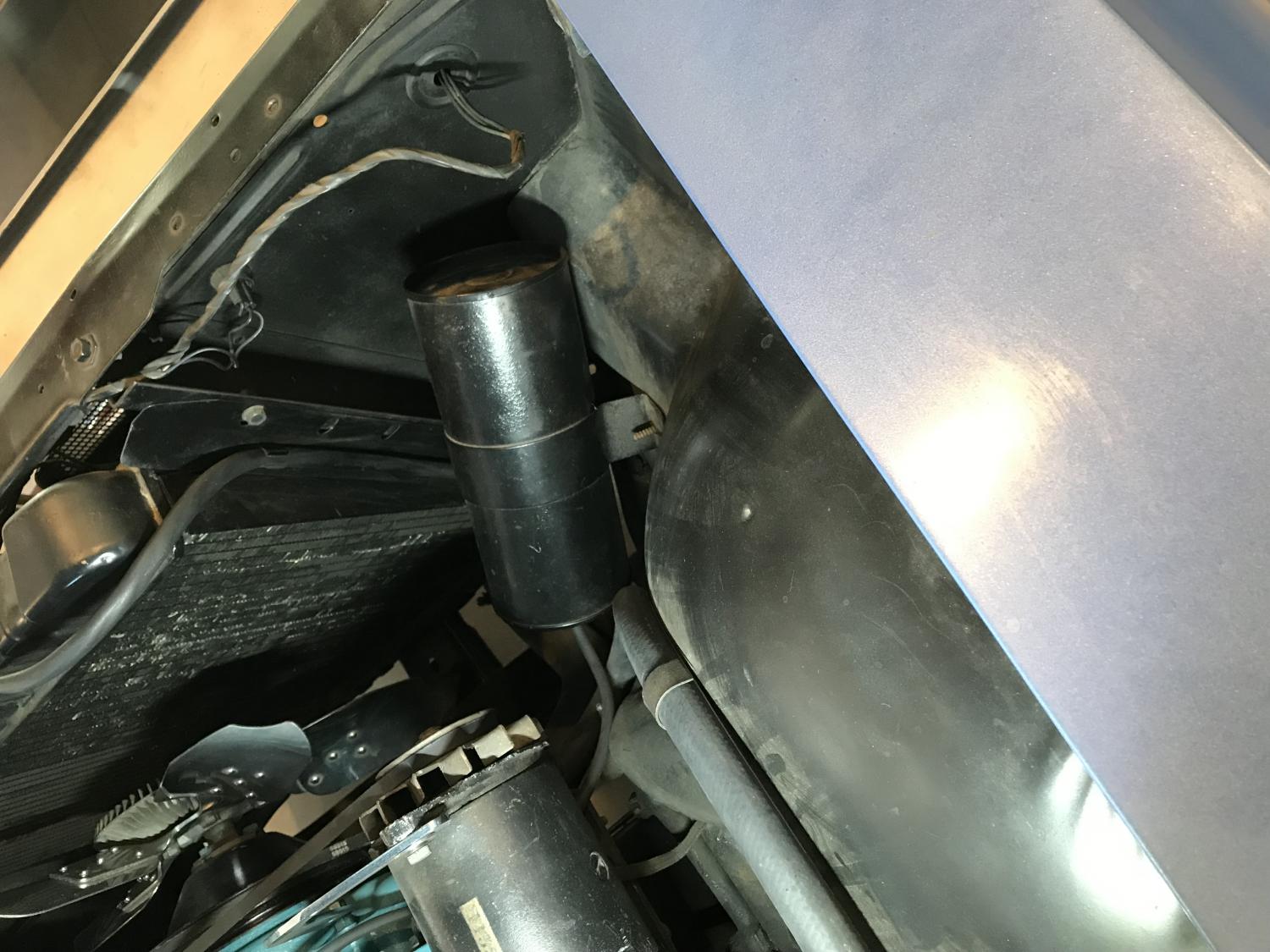

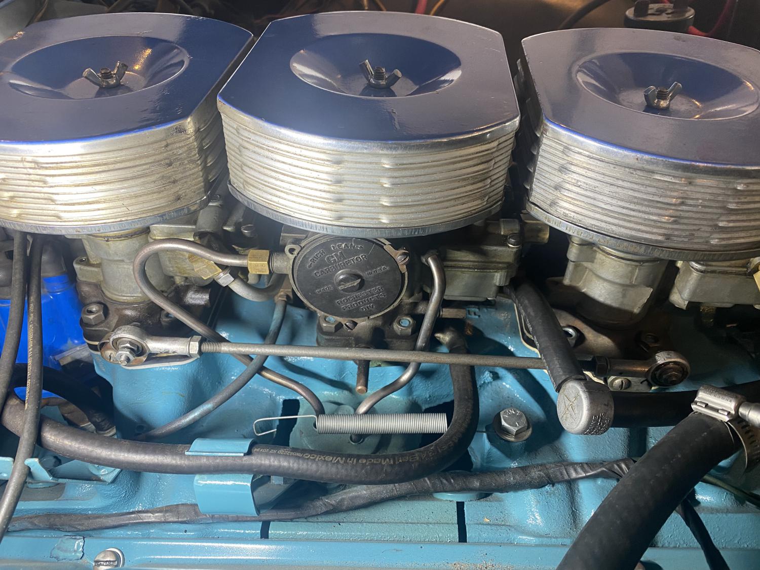

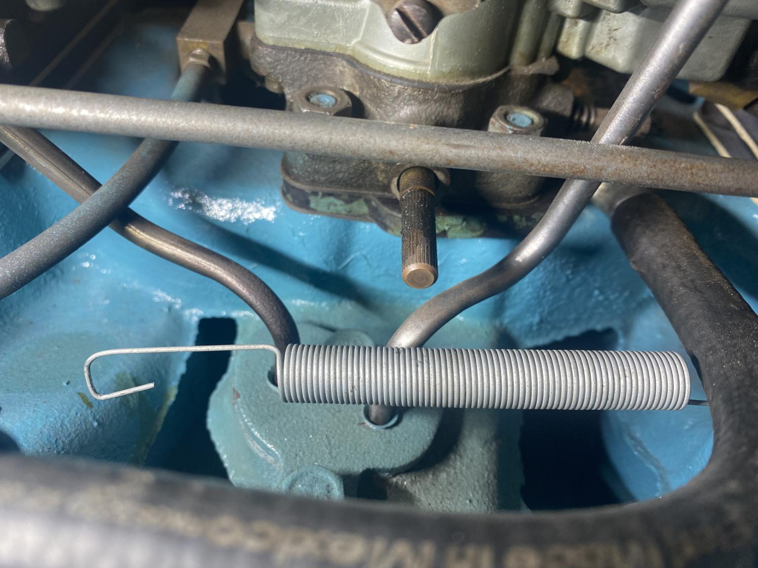

It was actually just a spring to counter act the vacuum that was added to disable the end carbs. Simply unhooked it. Runs great. Pretty elaborate setup of vacuum lines for the carbs.

I thought they had block off plates under the end carbs and then figured out it was just the spring.

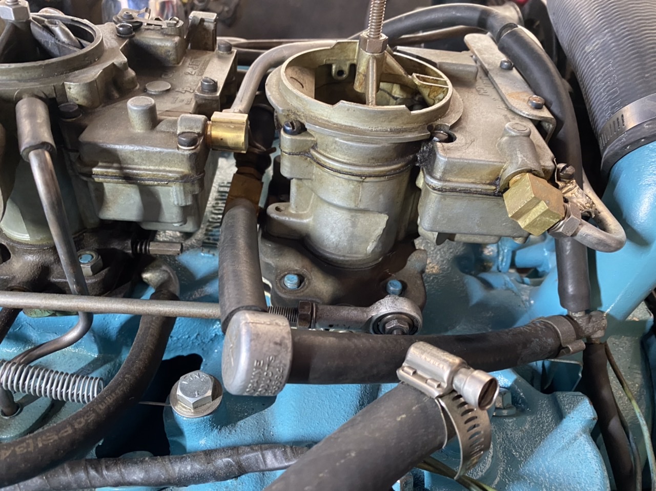

So the end carbs are actually controlled by vacuum ? I've never seen anything like that.

And apparently a really big vacuum tank.

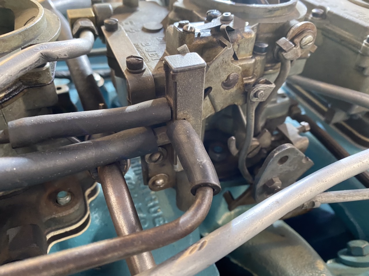

Or maybe something is missing off this shaft coming out of the center carb.

----I know that in 1964 GTO's with tri-power the outside carbs were vacuum operated so it stands to reason that earlier Tri-power cars were also vacuum operated. Progressive linkage was out there in speed shops and guys rapidly yanked the vacuum system off. It was gone on my 64 GP and I never put vacuum back on as the car ran fine without it. I believe that Pontiac saw the light in 65 as 65 GTO's came with progressive linkage. California Chris could proably explain it better than me.....Bill S
