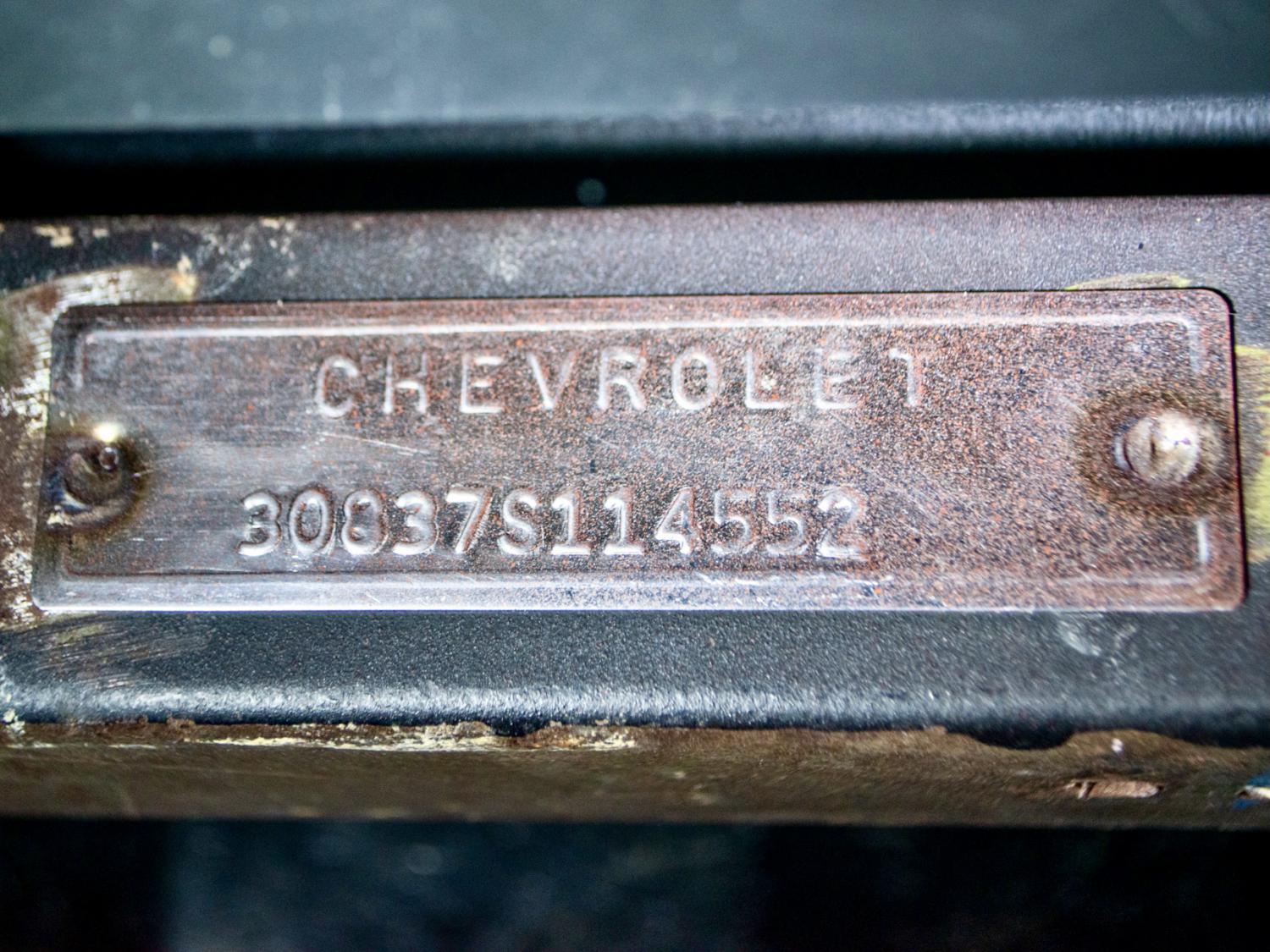

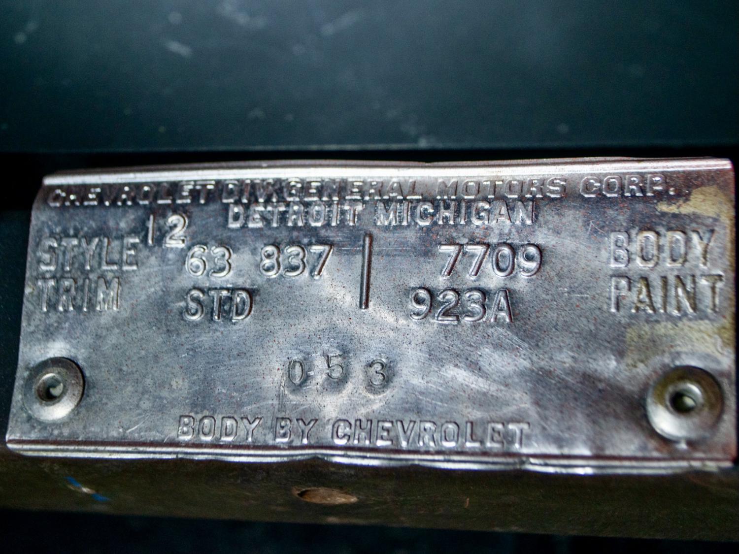

I'm very certain that the VIN tag is OEM although I'd like a better pic to confirm. The trim tag judgement cannot be made without a better quality photo.
For education purposes, what's the issue with the TT picture?
Bad quality. The best way to photograph a mid year Corvette trim tag or VIN tag is by holding the camera or phone upside down to allow the flash to hit the tag directly. This is only after a thorough wipe down with paint thinner/wax and grease remover/brake cleaner
