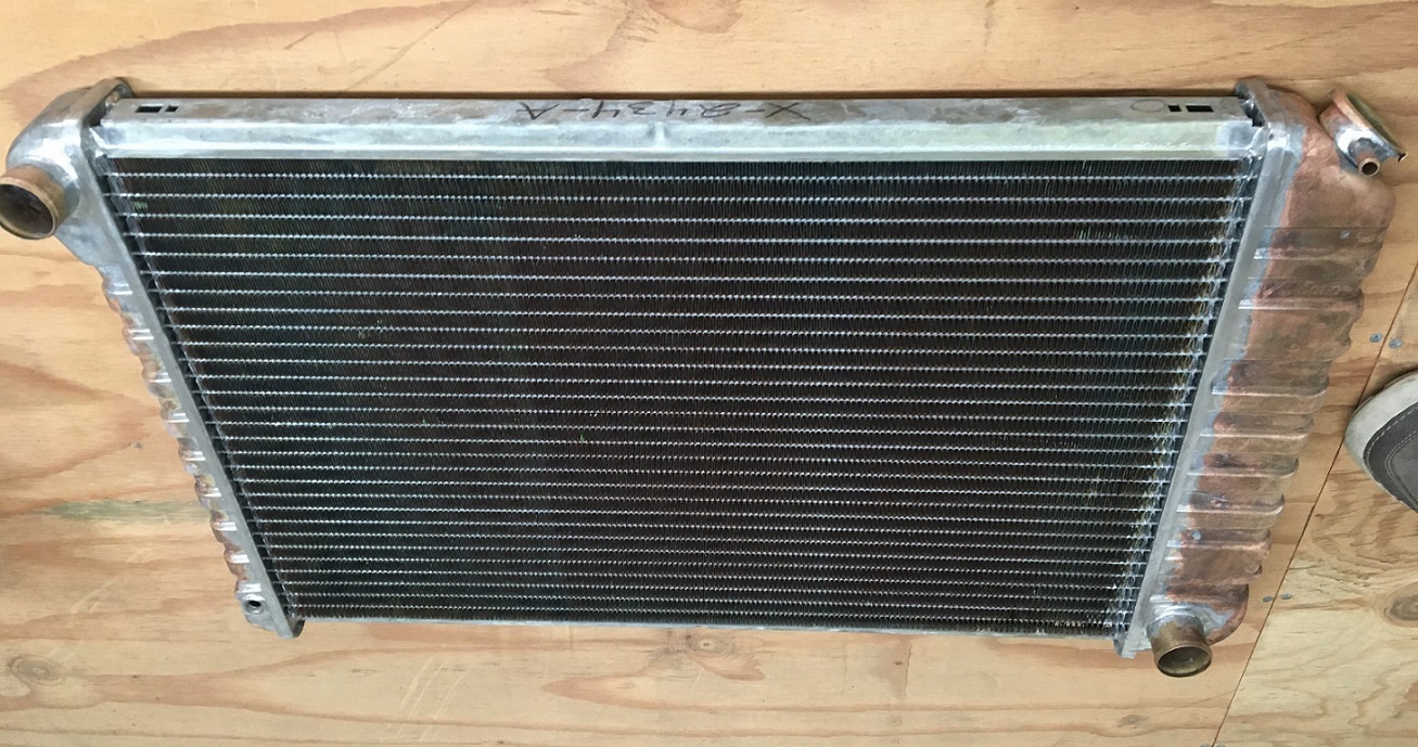

Had razzi in PA do one for me that came out pretty good
