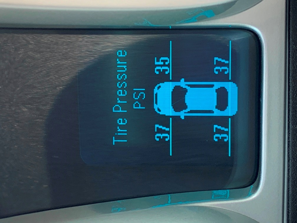

We went to my buddy’s garage last night and went to install the new tire sensors but his tire machine won’t handle the 20” rim. We did find out that the rims have sensors already but they are the 430 frequency units for 2016-17, and are not compatible with a 2014 system. So we still need to install the 315 frequency units I bought. I have an appointment with a reputable tire shop to install them and balance the set tomorrow morning.

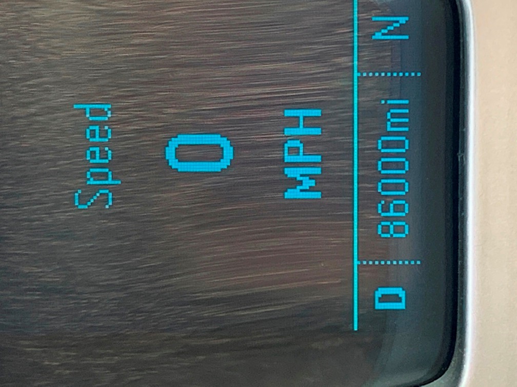

Success!. I went to the tire place today and they removed the old 430 MHz snsors and installed the 315 MHz sensors. They then removed the old stick-on weights and rebalanced the set. All the wheels then got calibrated according to their position on the car. So all is well now! And it turned 86,000 while I was pulling into the gas station to fill her up.
She sure does drive really nice now.
(and yes they all read 37 psi by the time I got home)
