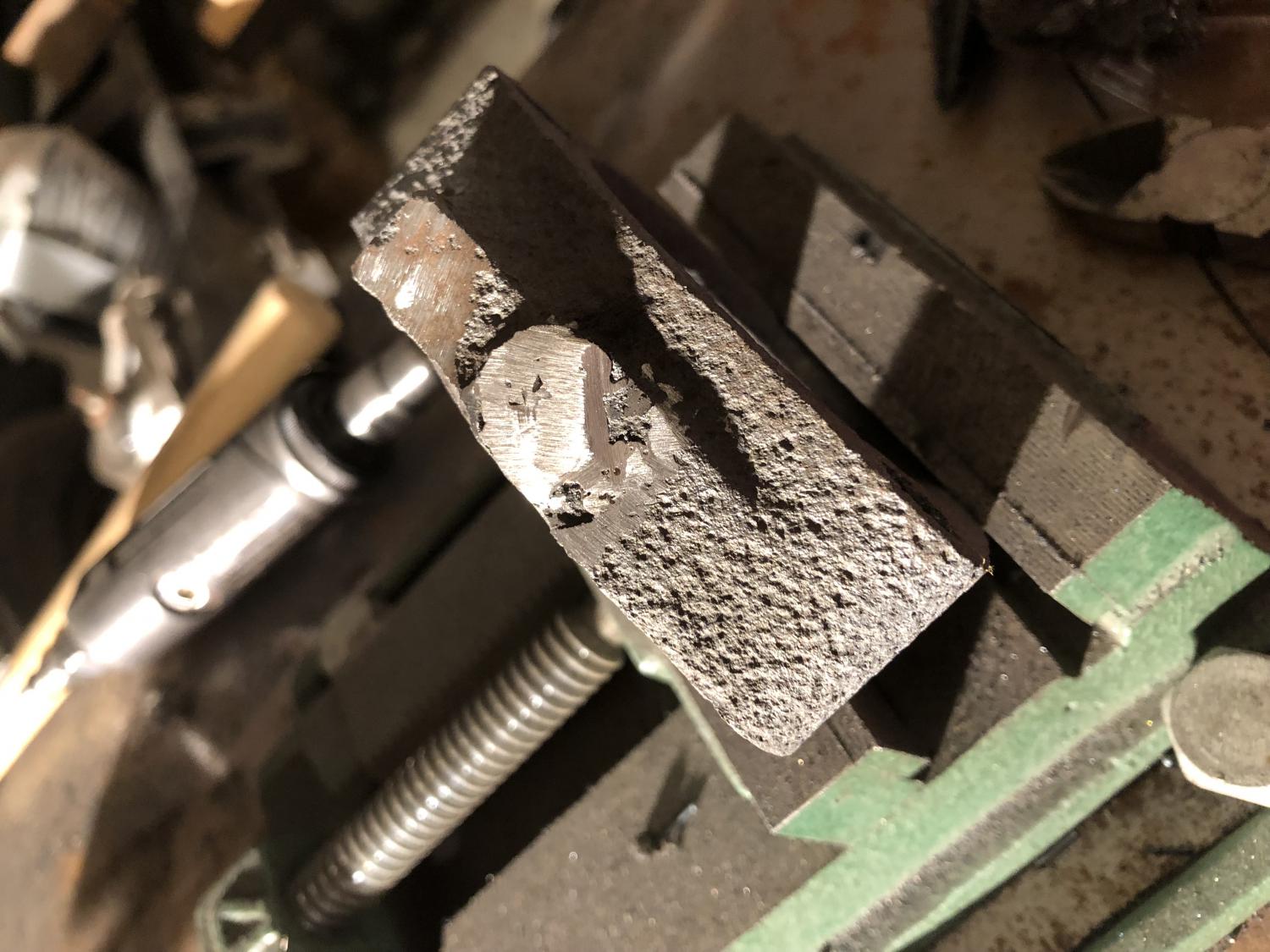

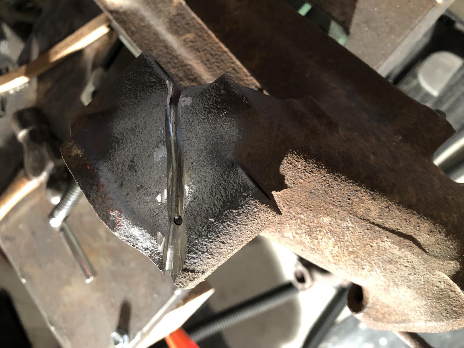

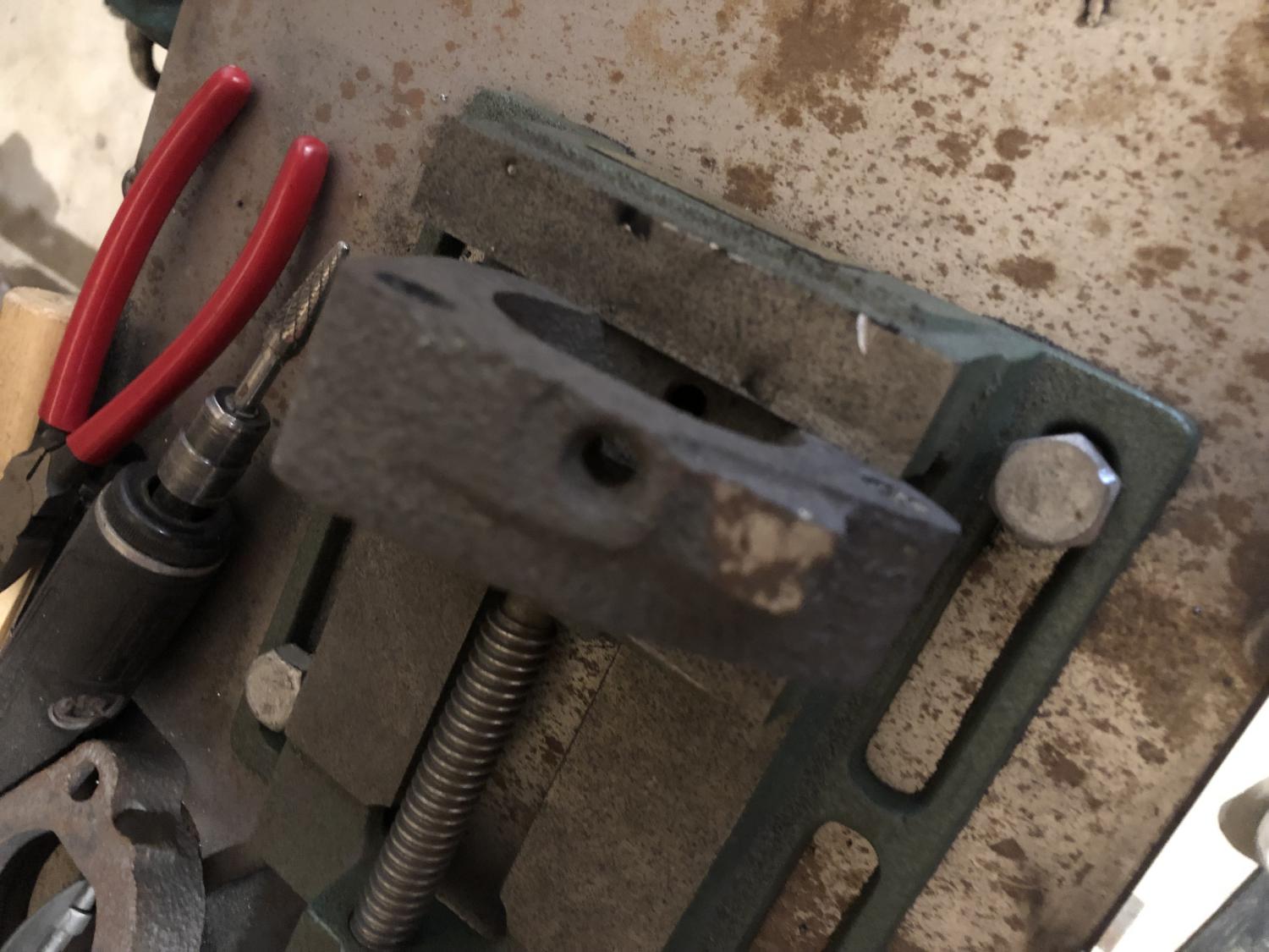

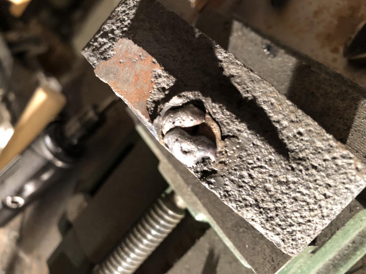

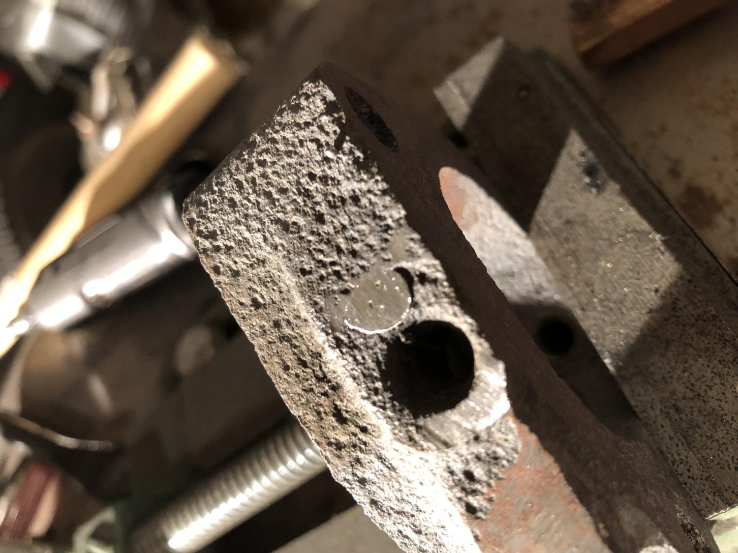

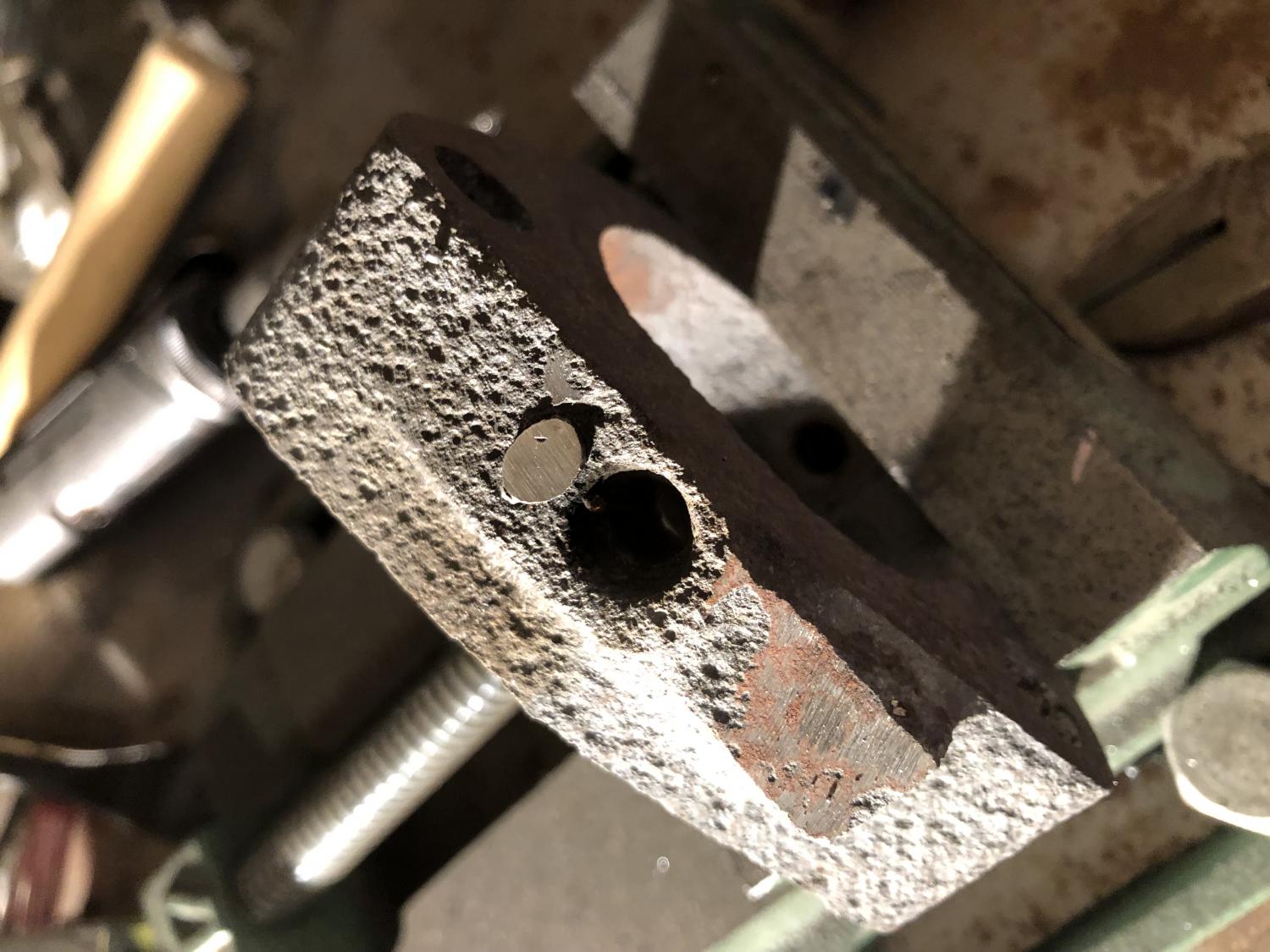

OK, sorry for the delay. Family stuff came 1st in priority
So I wanted to fill a hole in a riser for a blank. Here are the pics. Had some feed issues partway through, so some crappy welds. But good news, a cutoff wheel took the welds down with no issues.
Did a dollop of weld right on the cast surface (previously media blasted). Could not pry it off. Then did some grinding and smoothed out nice without any cracking that I could see. Did some chip hammering and it dented easy.
Then I filled the hole, no pre-heating of cooling. That amount of weld did not heat the part that much. Ground it smooth, easy-peesy
Next, will have to make a crack in a junk manifold, drill it and bevel and see how it goes.

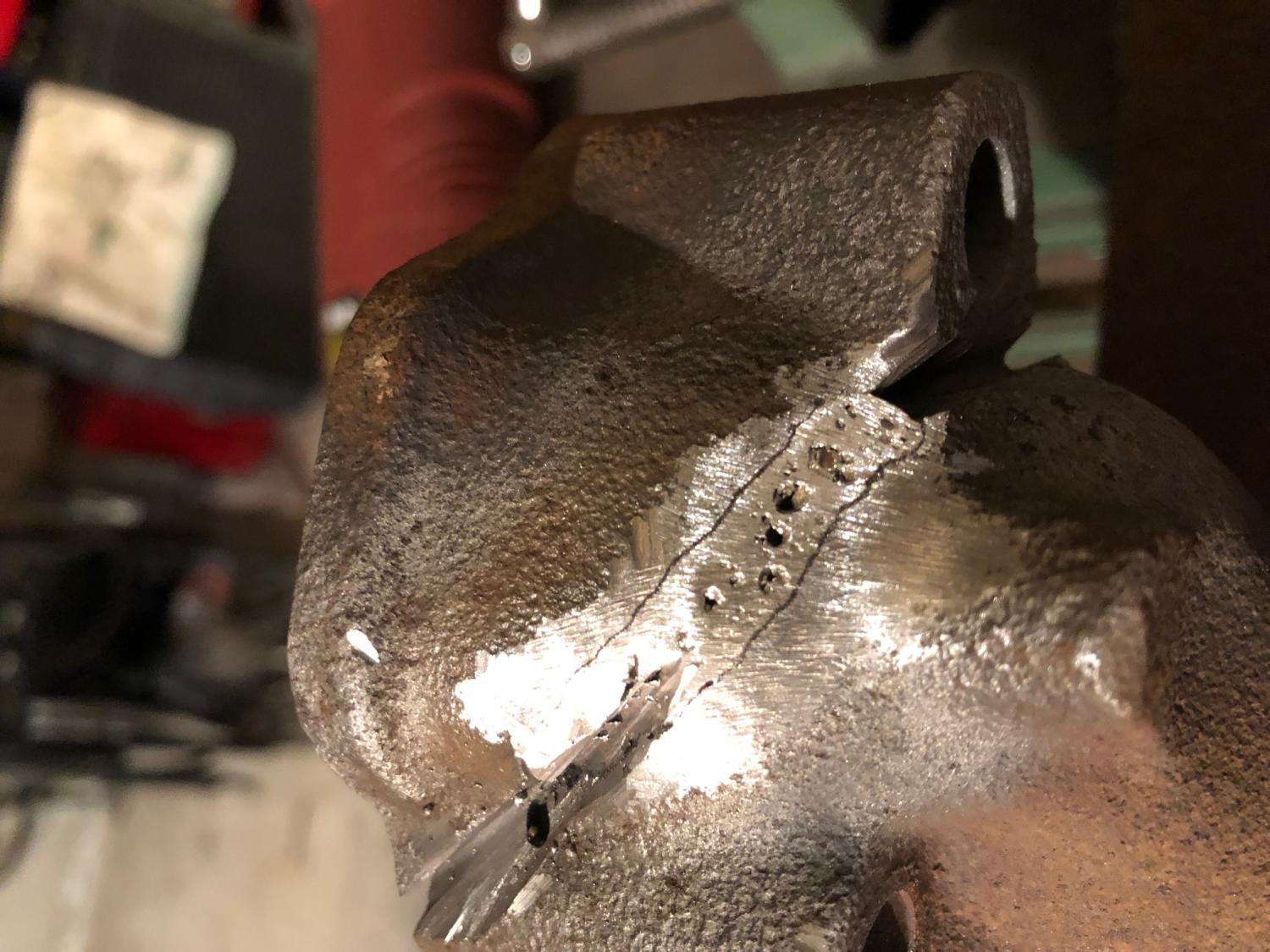

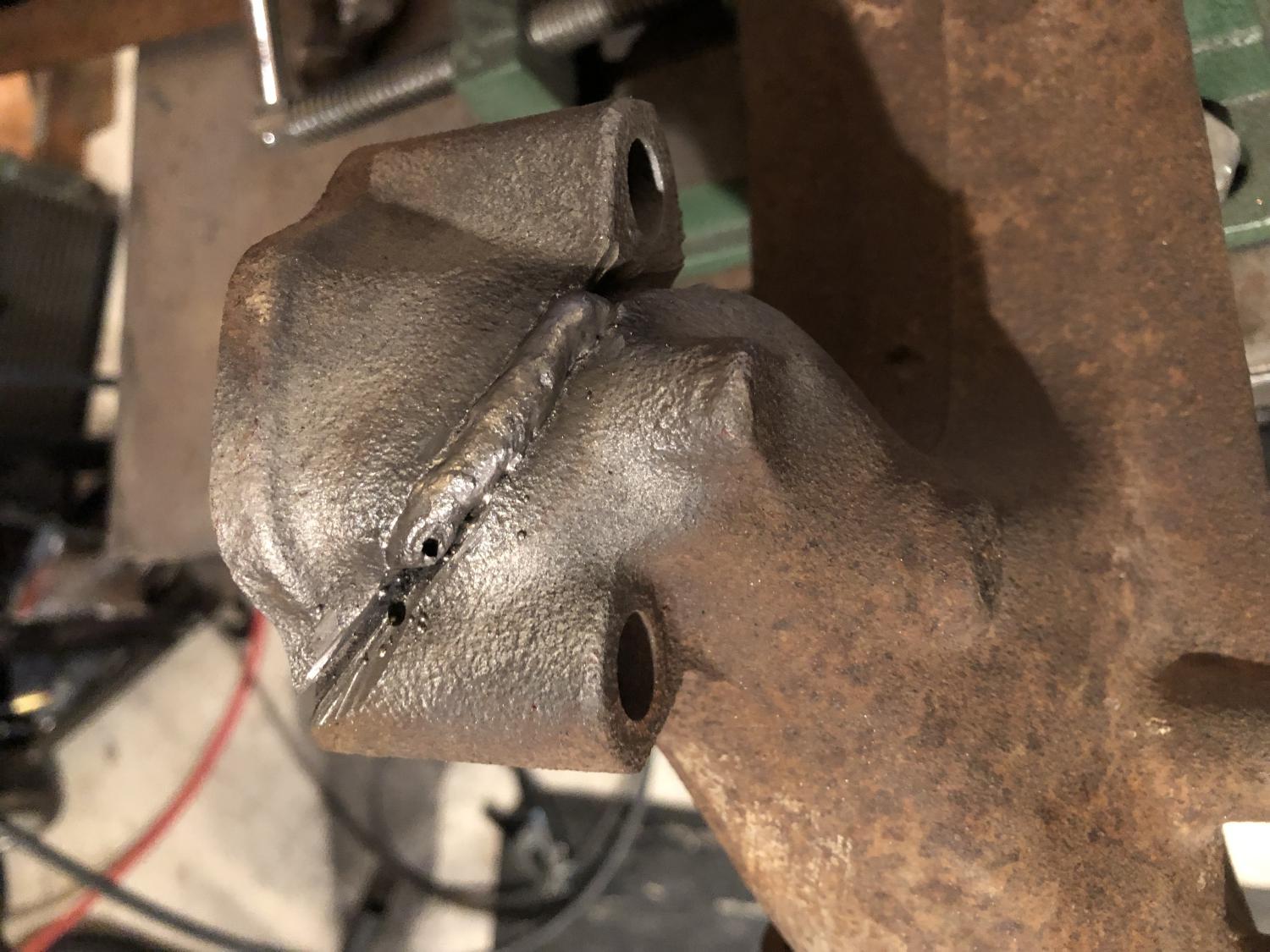

Alright! Lets work on an actual crack! On a test manifold
Drilled some holes at the end of the crack, but later saw it go further, so grinded past.

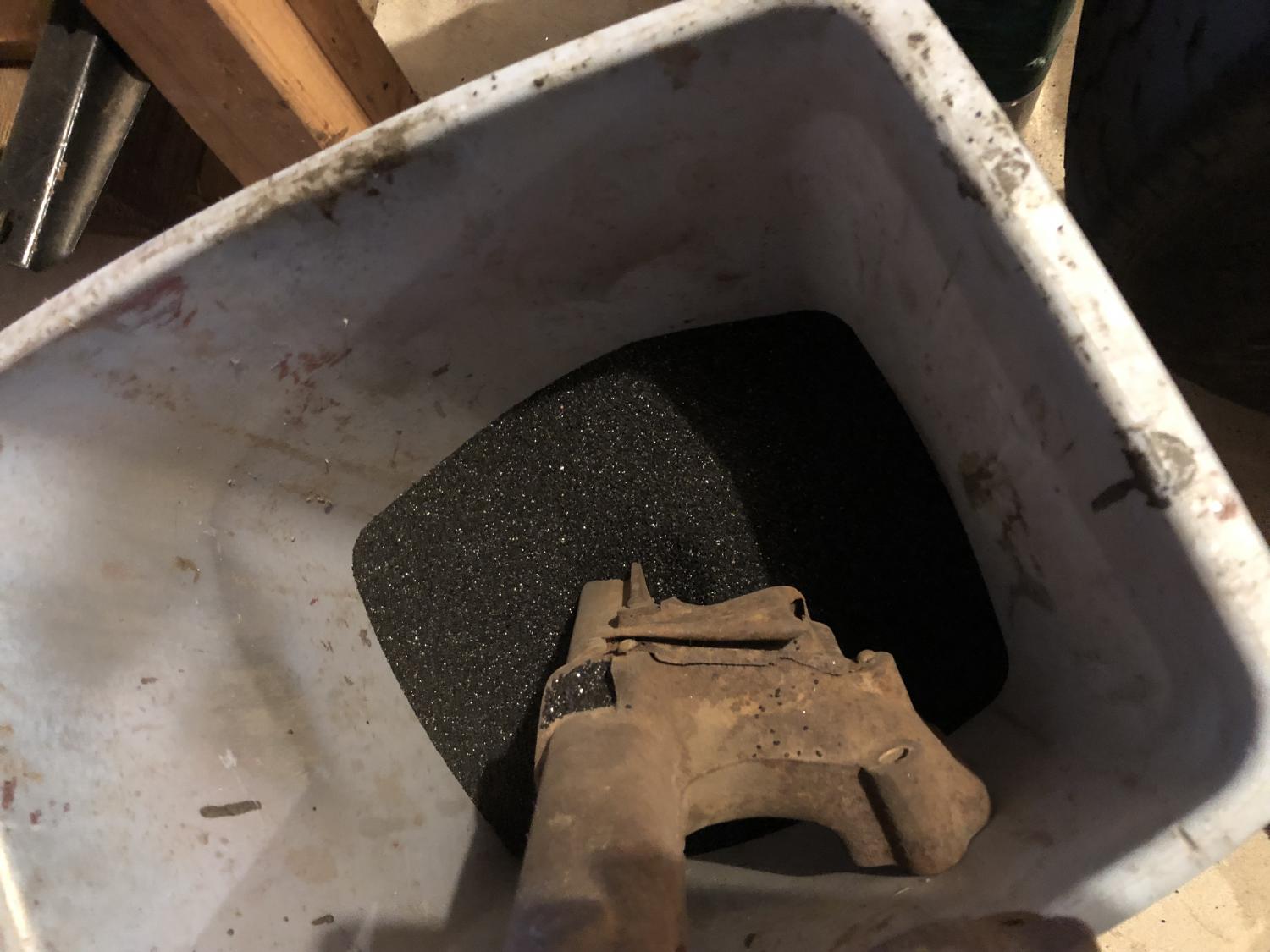

Cut a groove and ran a bead. Then put it in some media to slow cool it.
My feed issue is fixed, but I was not centered in the groove and it missed one edge. But still weld stuck well in the groove IMO.
Will still need grinding and some more passes, but I am happy with the result. Pinged it with hammer and it rang well.

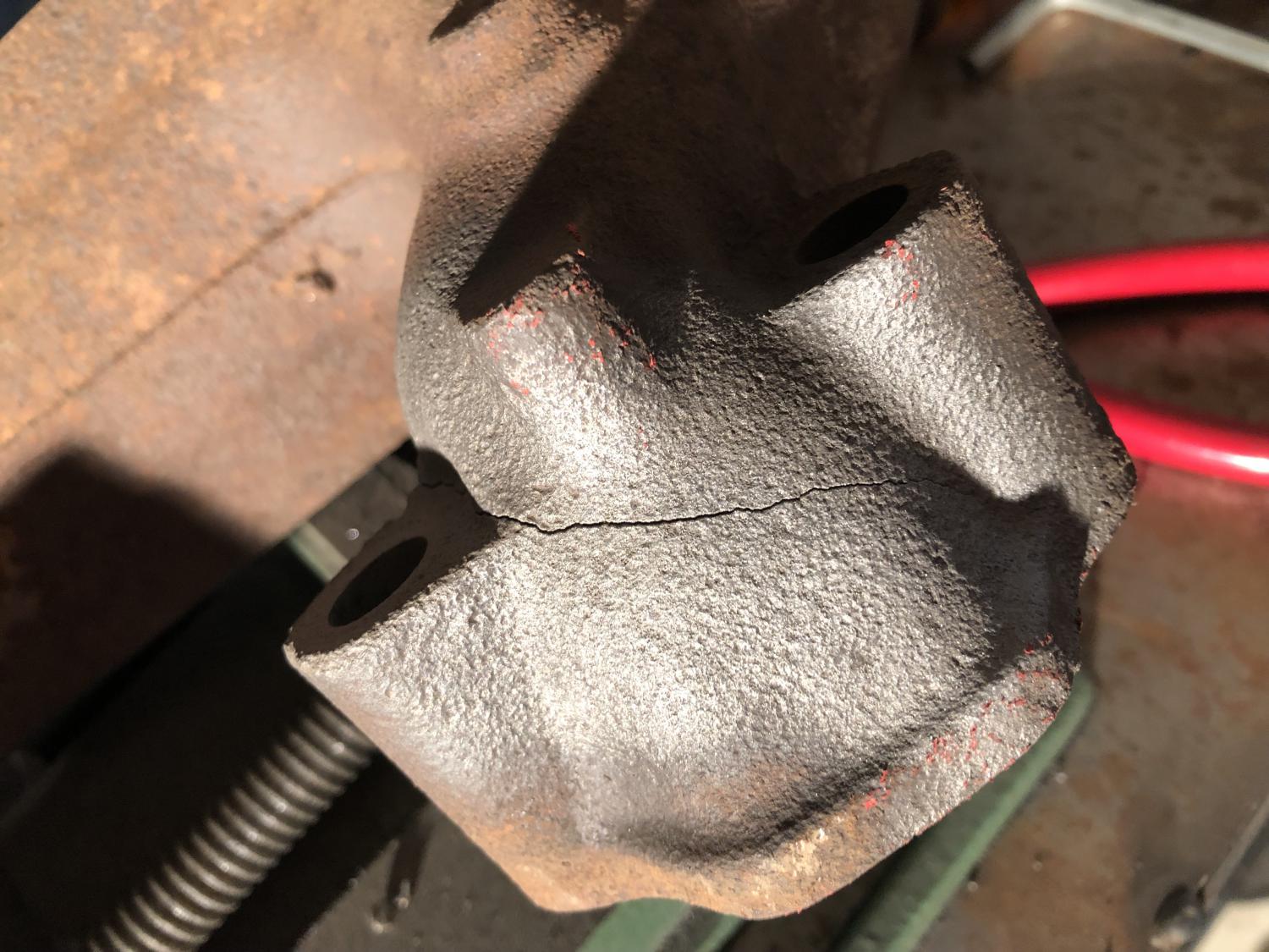

Well, that was a FAIL! Weld looked nice but did not adhere. Ground it flat, hit the edge of the manifold and the cracks appeared. Well this is why we test
Did the first pass over an inch, too much probably. Next test will be 350 deg preheated, only 1/2 inch passes, then stress relieve, then back in the heat. Also instead of 75% Argon, I will be going full Argon and bumping up the heat range of the welder.
