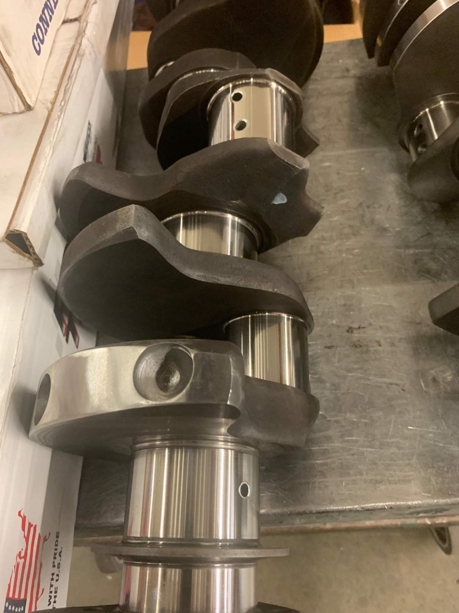

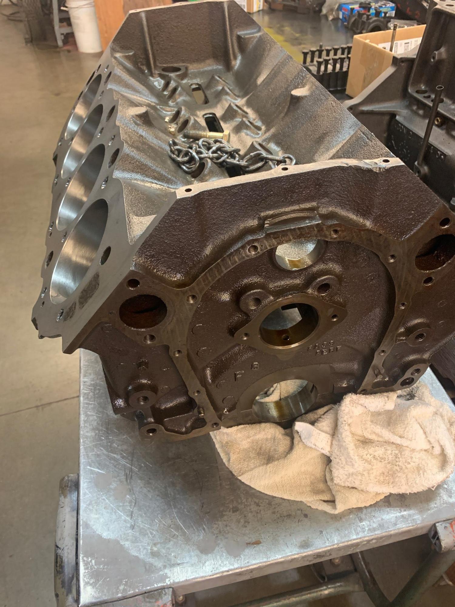

I've made a decision and decided to continue the journey with all of your help on this thread because I didn't want to hijack the Technical and Restoration Section. I have a zero mile 350/autogear 4 speed that will be in the car FOR NOW until I find the big block transplant for the car. However I have a lot of parts to sell to keep an eye on the classifieds.

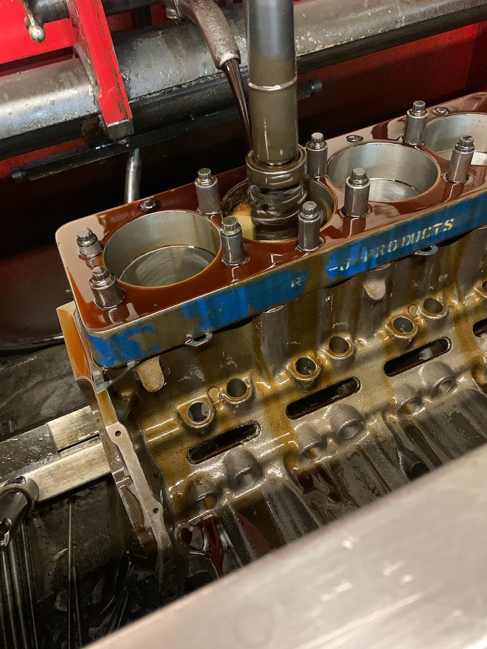

-Complete running big block preferably with accessories still attached
(Snowflake heads a must)

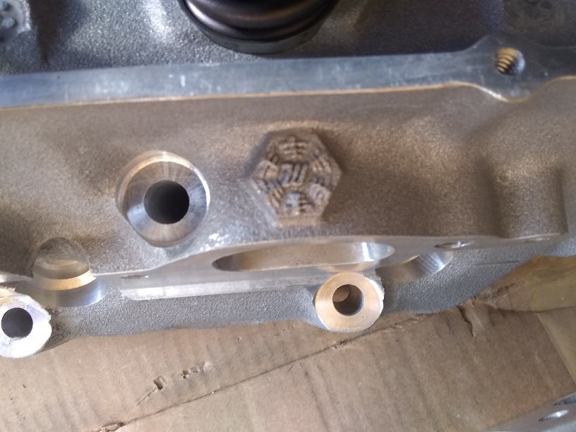

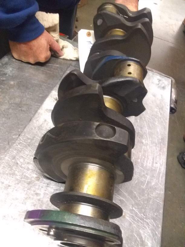

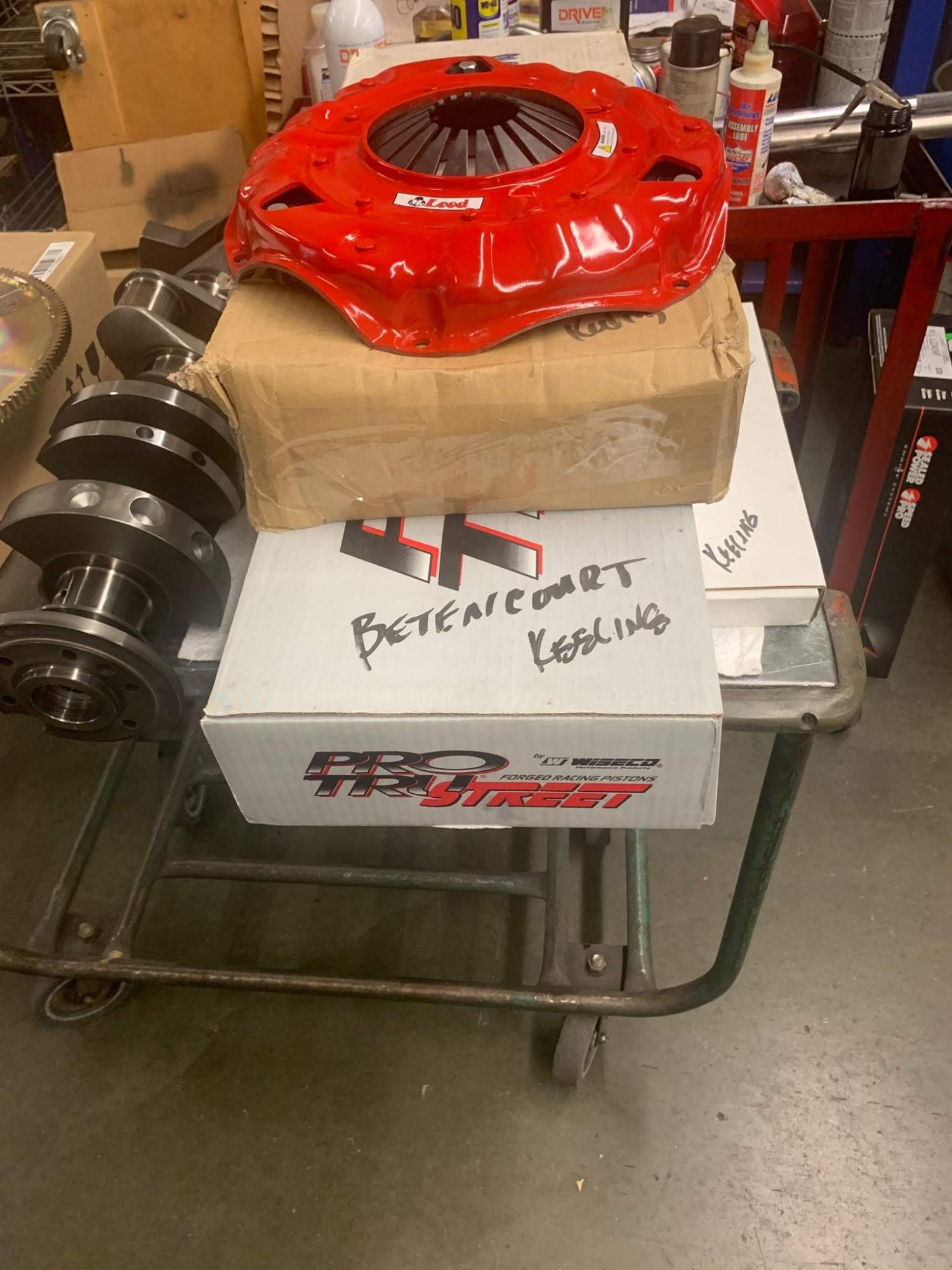

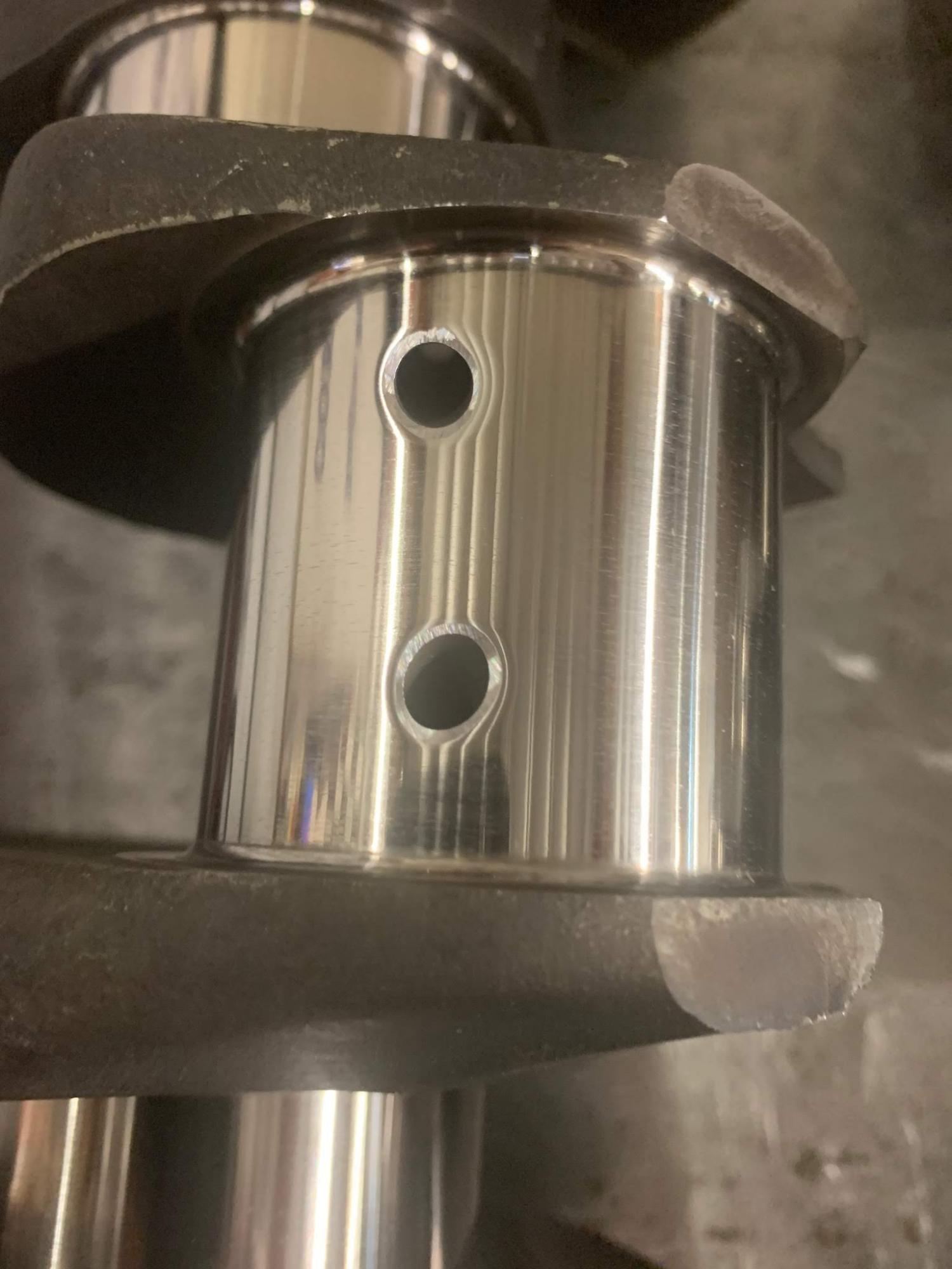

Update: Big Block being built, NOS 077 Heads
Update: Engine Done. studded 2 bolt 454, 077 heads, 198 intake, 4296 carb
