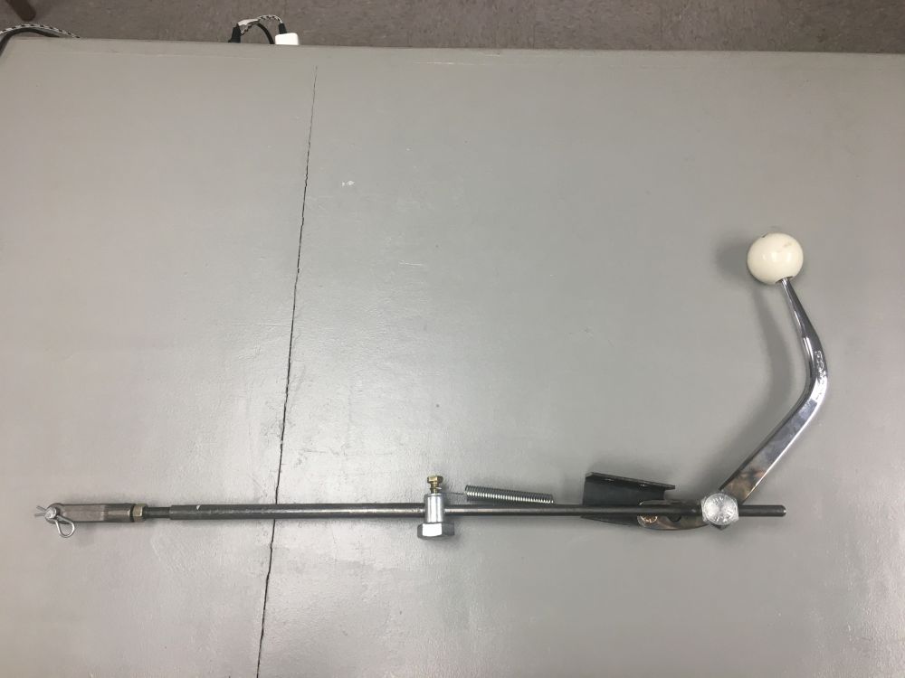

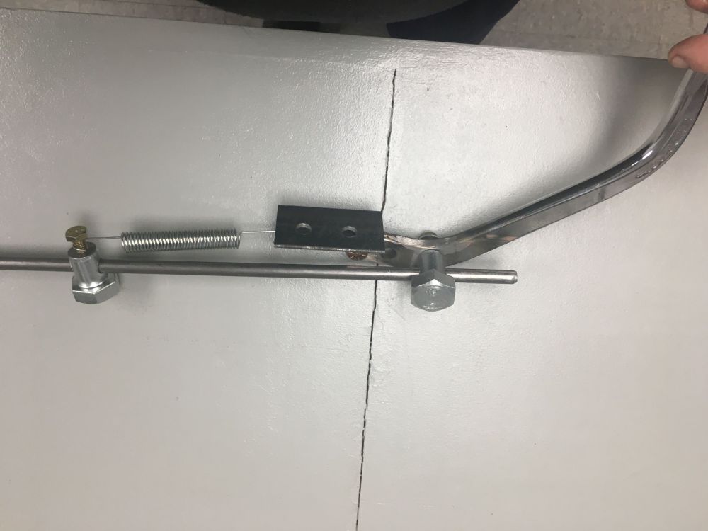

Here is the progress on my Hurst Drag Brake. The rods are adjustable and still need to be cut to length. After it is all fit I will paint the parts.

Nice work buddy

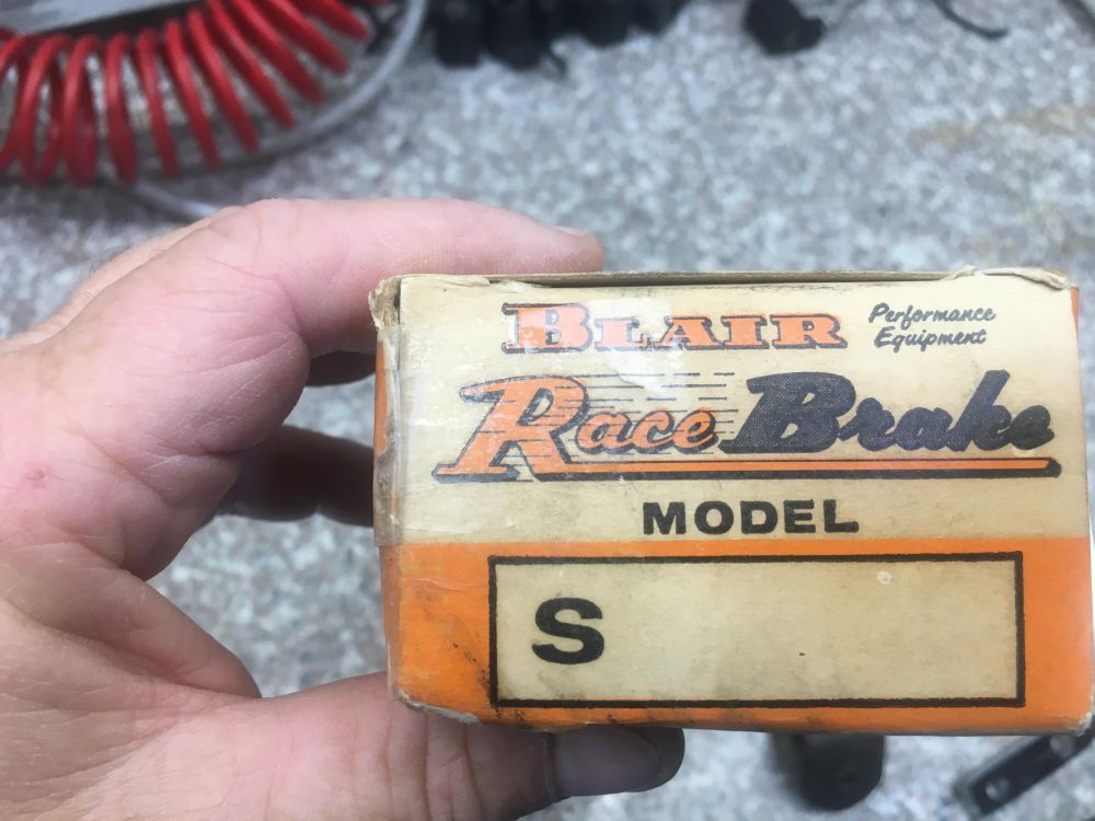

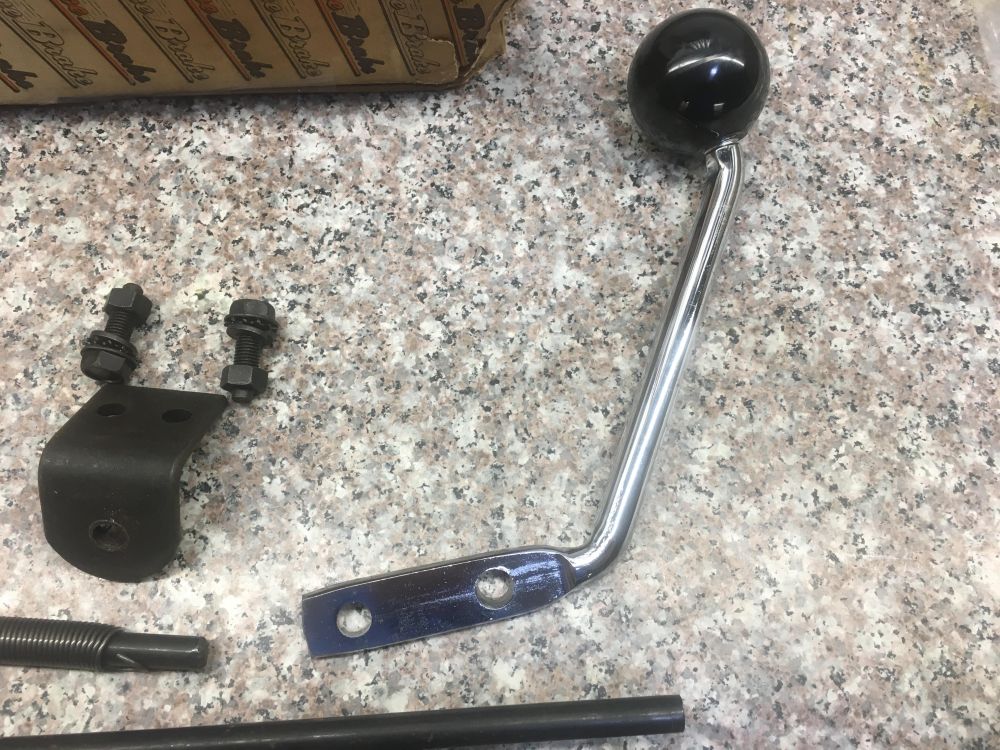

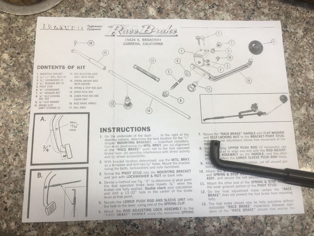

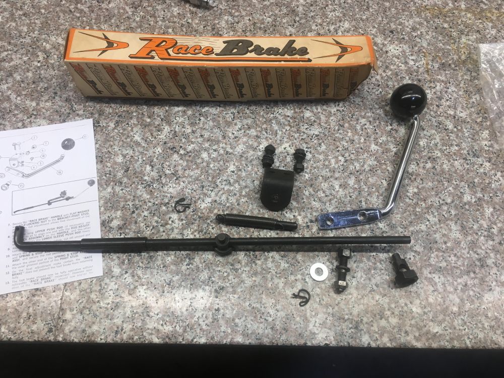

After years of searching I finally found a NOS one.

Did you buy it from a guy who found 2 NOS race brakes?
Can I borrow it to make drawings so I can replicate it?
I love shifters, but I think these are even more cool than the coolest shifter.

Sadly it was the only one, absolutely, see you at mcacn.

Very cool part to acquire Dan. Thanks for sharing the pics.

Now that is a cool item !!! Thanks for sharing!!!! Rob
