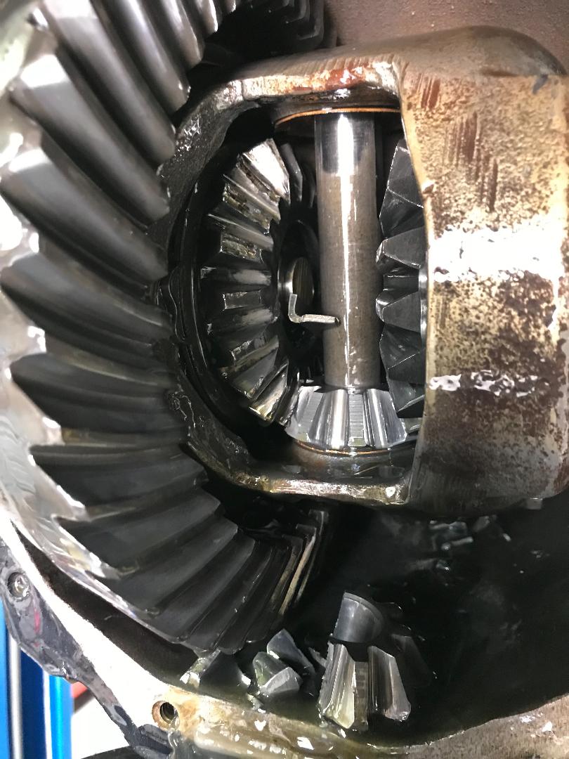

Friday was a blast. My best pass was a 12.91 @ 108 mph. Benny was a great crew chief and helped me get the starting line procedures down pat. He's a good man! Just as i was getting the hang of the car, the rear end let go! I've seen cars break and the track and now I know the feeling..lol. Oh well, all part of the experience.

Ouch...sad to see the pieces in there Jason.

Jason, let me know if you need any help with that. Tom's Differentials had special heat treated 17-10 gears once. I don't know if they still have them or not. It's been a few years since I got any from them. Looks like it still had the old bronze washers in it. The steel washers are stronger. You are going to need a set of springs and plates too. If you want to take it out and send it to me I can fix it and send it back. Did you inspect the ring & pinion gears?
