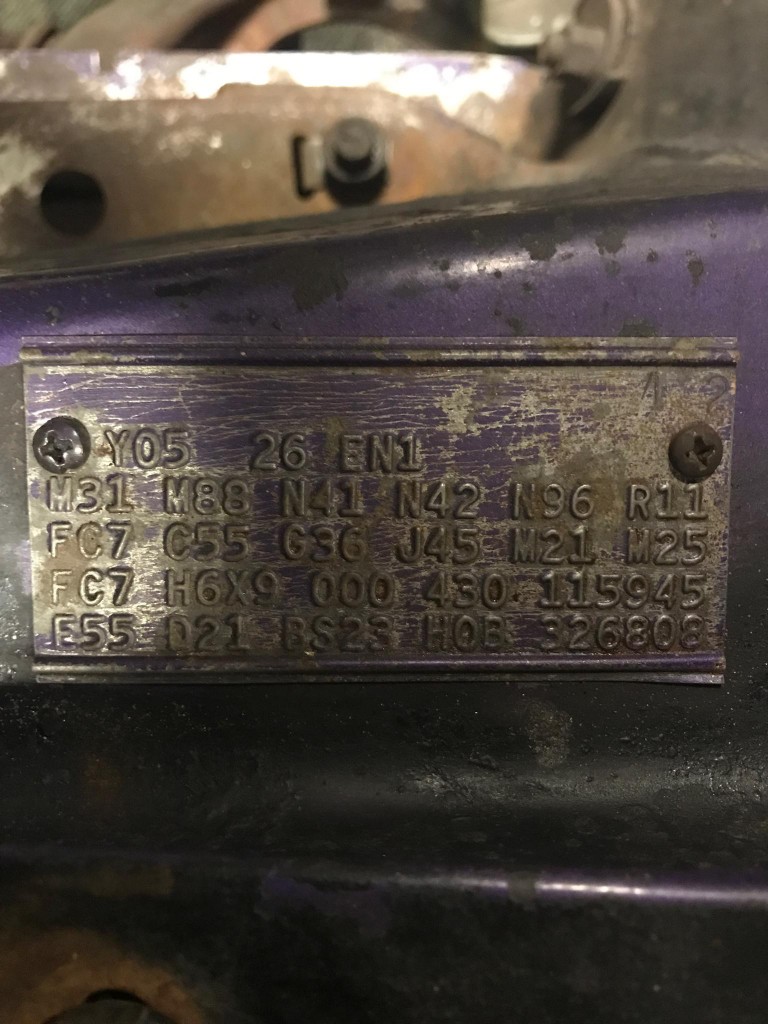

Dave:
Can you post a photo of the Fender Tag?

Thanks guys! Yep.... here's the tag and what all that jibberish means:
BS23: (B) Plymouth (S) Barracuda Special, 'Cuda (23) 2-Dr Hardtop
H0B: (H) 340 275HP 1-4BBL 8 CYL
(0) 1970 (B) Dodge Main, Hamtramck, MI, USA
326808: Sequence number
E55: 340 cid 4 barrel V8 275hp
D21: 4 Speed Manual Transmission
FC7: In Violet Metallic Exterior Color
H6X9: Trim - High, Vinyl Bucket Seats, Black
000: Full Door Panels
430: Build Date: April 30
115945: Order number
FC7: In Violet Metallic Top Color
C55: Bucket Seats
G36: OS Dual Racing Mirrors
J45: Hood Tie Down Pins
M21: Roof drip rail moldings
M25: Wide sill moldings
M31: Belt Moldings
M88: Decklid Moldings Treatment
N41: Dual Exhaust
N42: Chrome Exhaust Tips
N96: Fresh Air Hood (Shaker)
R11: Radio Solid State AM (2 Watts)
Y05: Build to USA Specs
26: 26in Radiator
EN1: End of Sales Codes
I've got pictures of the original ad on craigslist of the car, second/ third owner info as well. Second owner bought the car to part it out but realized the rarity being a factory 340 N96 car, and started collecting parts to restore. Sold it to the next guy who sold off most of the parts he had acquired to make money, then sold the car to James. James found just about all the missing parts (including the unobtanium 340 N96 base plate) so most ofthe hard detective work is done!
The car was repainted white way back in the day, so the ad shows White car. Guess In Violet wasn't a very popular color after the 70s fads faded.

Dave . . . do not give in to the dark side and add stripes (V6X). They weren't on the car as ordered. It is a very rare car because of the N96 Shaker Hood. Without it, it's just a 340 'Cuda and Plymouth built plenty of them:

Yep, correct. No stripe. I don't like them anyway and it's one less thing for me to screw up!
