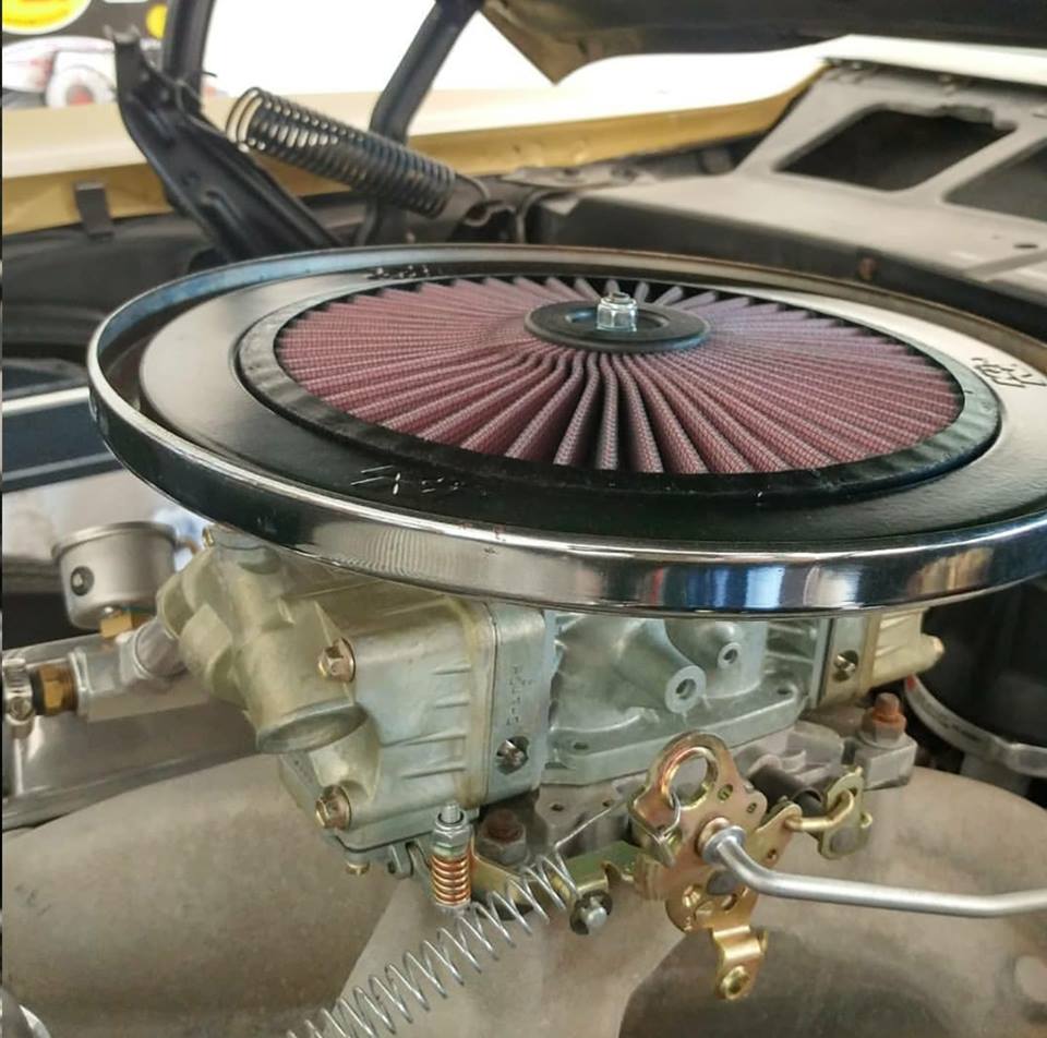

Check these out from Walker Performance. I bet you can give them a call and they will make something for you.
https://walkerperformancefiltration.com/
You can always take it off when showing the car. I heard about these after Mike Finnegan used one on his 1955 Chevy gasser named "Blasphemi".

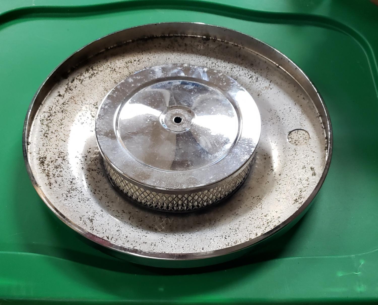

I was playing around with installing a small air filter inside of a fly eye.
It fits under the fly eye top screen
I was thinking of cutting the base of the small air filter to fit it inside the fly eye to hold everything in place but have not tried that yet.
