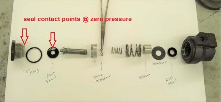

Does this help at all ? I would like to understand how pushing on ,(DEPRESSING ) the exposed piston rod moves anything when the valve seal is already seated ?
Joe , your valve is most likely OK. They are easy to take apart, just used the correct socket. Most I have restored I cleaned and re used the seals.
Hey Mike, you've raised another question!! I hear that the plunger needs to be "depressed" in order to bleed the front calipers. That has come from a few sources now. With all due respect, since you've actually taken one apart and know how they work, do you think the plunger actually moves but maybe just a very small amount?? In this case, I'm gonna be a "parts replacer" and see what happens. I think something is blocking the flow of brake fluid and this looks to be a good place to start?? The way the pedal was acting (going almost all the way to the floor!!) and the actually braking was performing (not coming to a stop very fast!!) it all points to just the rears doing all the work??!! Anyway, I found a new replacement on ebay for $54.50. I'll keep you all posted.

IMO, pushing on the shaft only increases the pressure on the piston seal, that is under spring pressure and seated and holding off flow. As the brakes are applied the rear brakes see pressure first, as pressure increases to about 40psi it overcomes the spring pressure in the ROUND HOLD OFF VALVE. Fluid flows into the line at the big nut , passed the piston seal, out the side fitting to the distribution valve, to the front brakes. Sometime watch the shaft move out as the brakes are applied by a helper.
If you wanted free flow through this valve it seems to me one would pull and hold the shaft open to unseat the piston seal.
Open to learning more if this sounds incorrect to others.
Mike
Okay, I see your point. So now I'm totally confused as to why it says in the manual....."The spring loaded end of the pressure metering valve must be depressed while bleeding. This can be done by depressing and holding the plunger in the end of the valve either by hand, or by clamping." Will doing that relieve the spring pressure somehow?? I've been trying to do this with a hand-held vacuum type bleeding tool which doesn't create enough vacuum (?) to overcome the spring pressure?? Some other instructions mention using a "pressure-type" bleeder. Not sure if that would make a difference or not?? I've ordered a new valve like I said and will let you know what I find. If it still doesn't work I'll have to find a "helper" to help me bleed the brakes the "old-fashioned" way by stepping on the brake pedal!! Thanks again for all your input Mike!!
