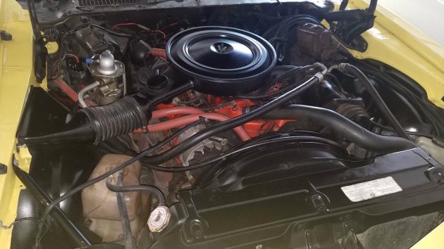

The indent was created as a punch-out for the 75 air cleaner duct (photo below) and from what I understand, entered production in late '74. Regardless of 74 or 75, it is long after the 70 model year ceased production.

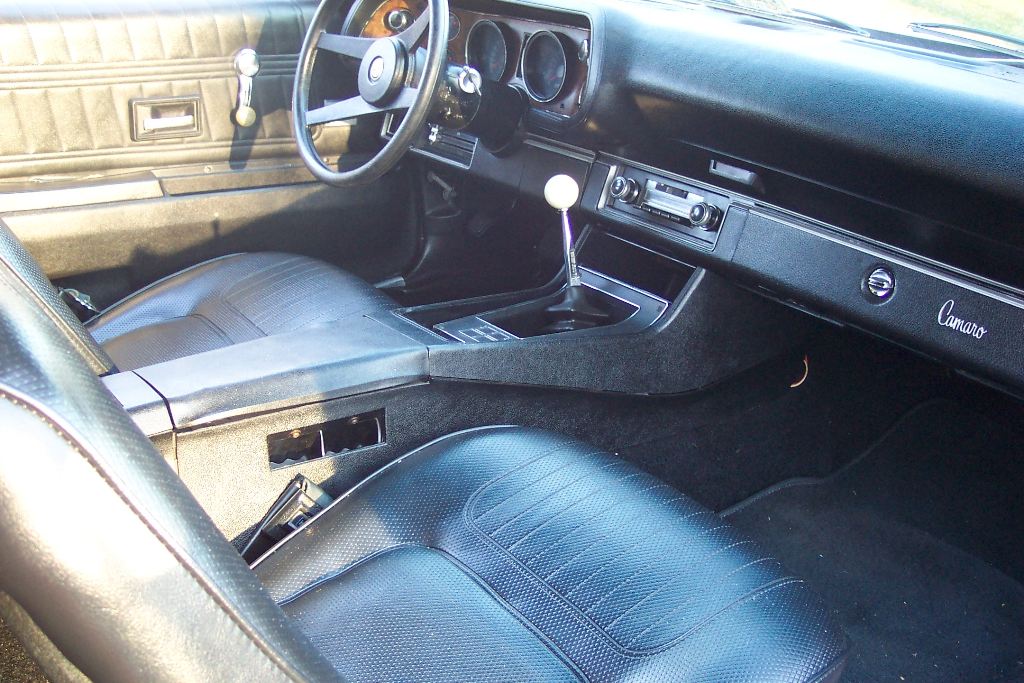

Assuming car had front end collision damage with misc non 70' replacement parts....hard to understand why interior is cobbled together with wrong year parts also......
Obviously it's a buyer's call at how he values this "driver" 70-Z28....
Depending upon the cost of new paint and whatever else you change or improve....you know have a $$$$ ????? driver that's worth how much to the next guy.

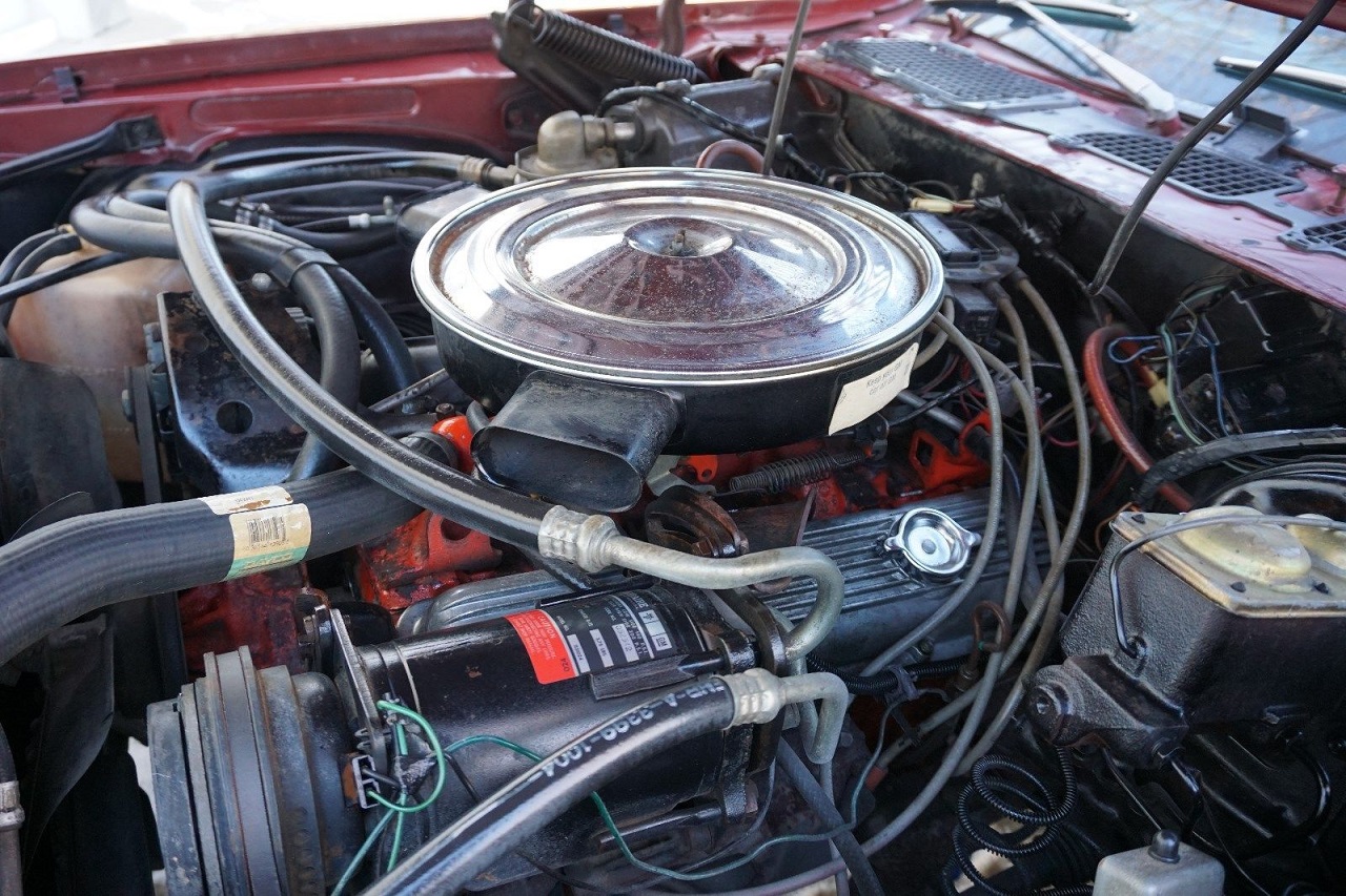

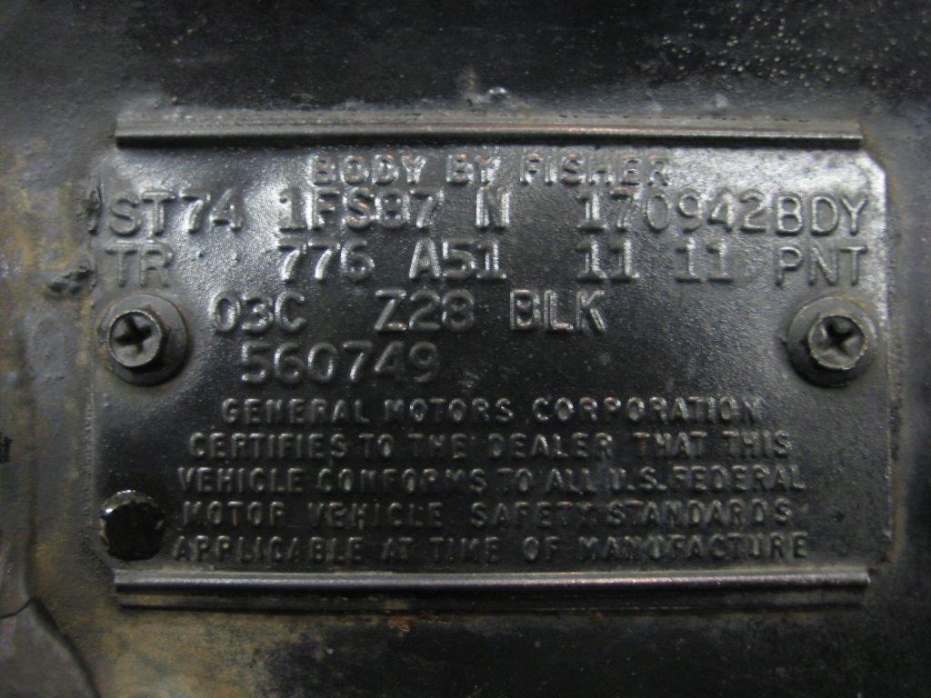

Just to add to the data pool, here's a photo of an 06A 74 Z28 showing the passenger fender indent.
