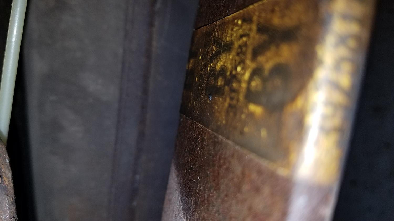

I was going through some old correspondences related to this car. This car was ordered with F41, front spring part# YJ 3912532 and rear BY 3925817. When I first acquired the car (1996) there was a question in ICC magazine related to tire size used on late 67 SS Camaros D70 or F70. I believe I answered that or at least added a data point. My car was built 7B (last week of production), L78 ,F41 and 456 axle ratio and still had it's original D70 spare in the trunk.
