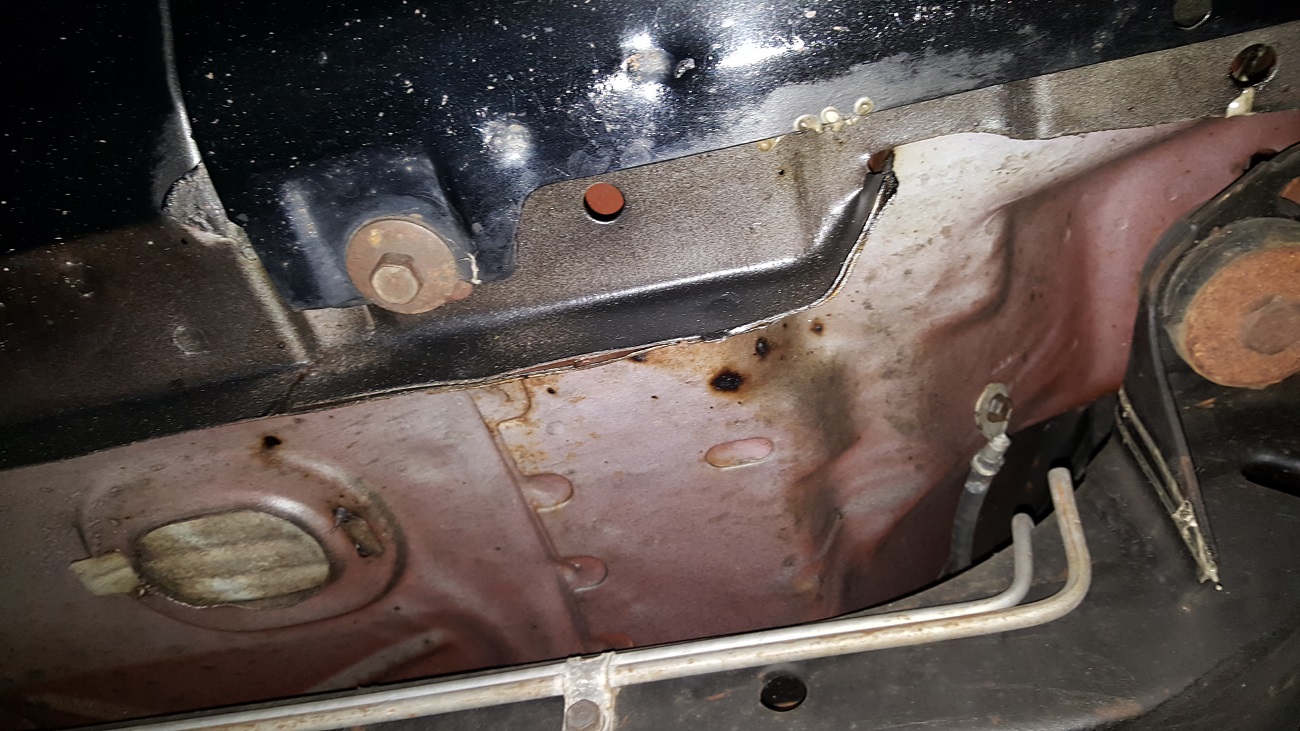

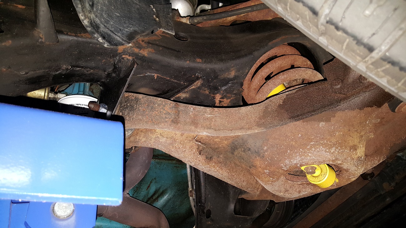

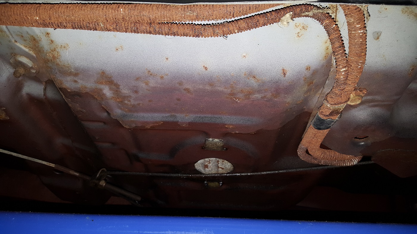

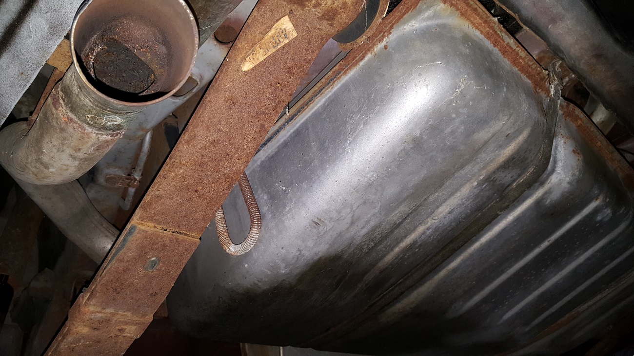

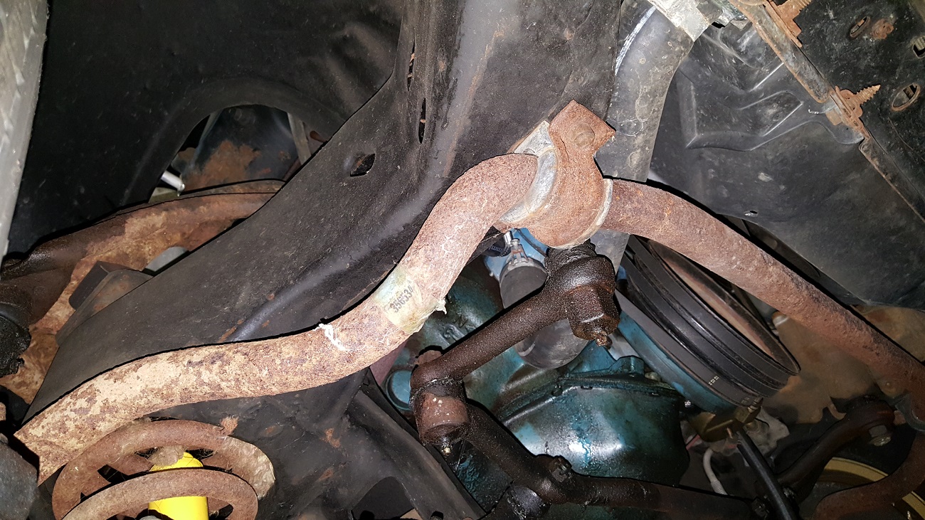

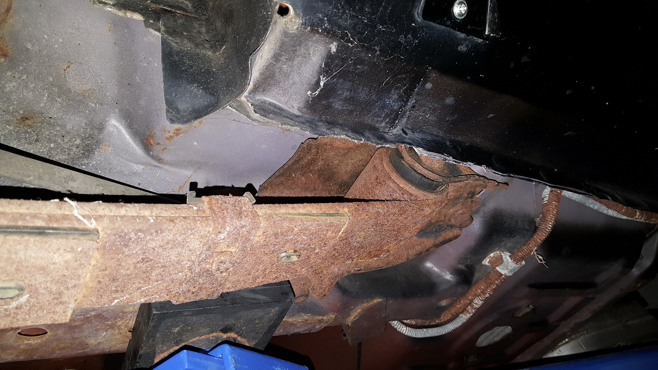

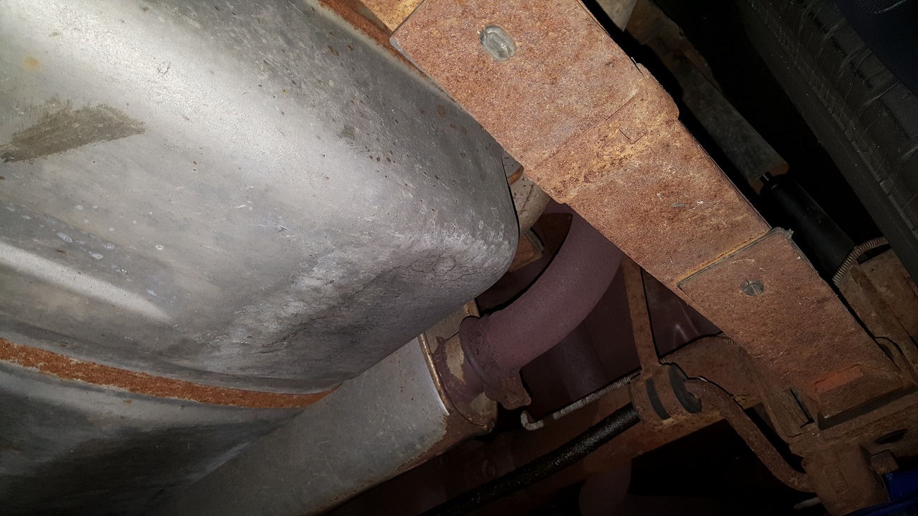

Okay guys here are a few pics of the rust on the underside of the Trans Am, looking for my best option here as it pertains to an original, low mile OHIO car. Remove the rust / replace the part / leave it alone? As always, THANKS FOR YOUR HELP!

Looks like I have a leaky pinion seal too.

Guys I'm looking for suggestions on what to do with the rusted parts under my car - Remove the rust / replace the part / leave it alone? As always, THANKS FOR YOUR HELP!

Set up a kiddie pool with plastic sheeting a sump pump and a sprayer and use the Safest Rust Remover or Evaporust solution and just let it spray. They problem is that it needs to be warm out for the stuff to work its best - like 80 degrees. I don't know if you have a heated garage, otherwise I'd wait til next spring.
It is amazing stuff. You also need to have it as grease and oil free as possible otherwise it contaminates the liquid and reduces its effectiveness.

Thanks Steve! I was just coming back to this thread to say "nevermind, I just read njsTeve's TA thread!" LOL
I'll wait til next spring I live here in MA - thank you sir!
