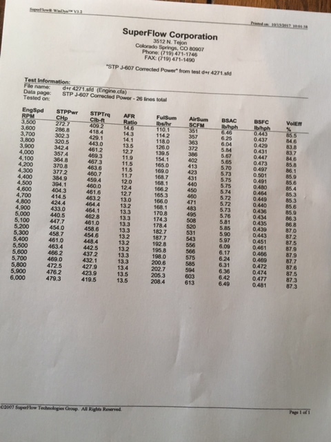

This is 427 Yenko engine same cam & lifters, +.030 TRW pistons & parts as the 396.
One dyno pull, ignore the figures bellow 4k RPM vac sec acted up.
