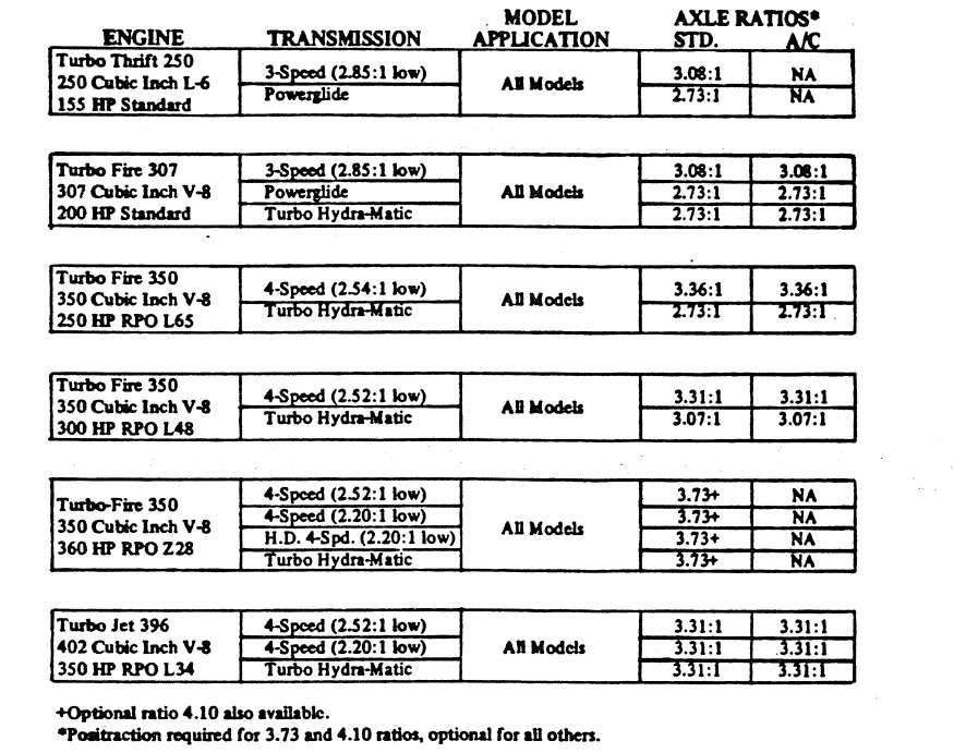

Interesting, in prior years you could always order a performance or economy ratio that was one gear up or one gear down.
Doesn't appear so in 70.
Also, they limited the 3-speed manual to the L6 and the base V8.
A lot less build combinations = less plant complexity.

Interesting: the chart does not include L78 combos. Added later in the model year?

I don't see a COW listed...and all the rears listed appear to be posi...thought the ratios aren't exactly the same from the Chevy list.
http://www.2gta.com/1970ta.html
The famed 12-bolt GM rear axle was only available in the 1970 Trans Am and was available with four popular axle ratios. The base axle ratio for all engine/transmissions except the 4-speed Ram Air IV was a 3.55:1 Teamed with the RA III, an automatic transmission, and air conditioning, a 3.08 axle was optional. When equipped with a manual transmission RAIII and air conditioning, the buyer could order up a 3.31 axle ratio. Finally, the Ram Air IV's with manuals or any other non air cars could be built with a 3.73 axle.

But... the chart above doesn't list ANY THING for an L78, but there ARE some 70 L78 cars out there. I would suspect the standard rear for an L78 to be 3:55.

I don't think the L78 was even listed in any literature...maybe the salesperson's order price guide would be the only place...you had to know to 'ask for it'.
