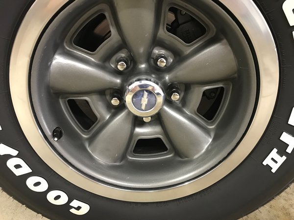

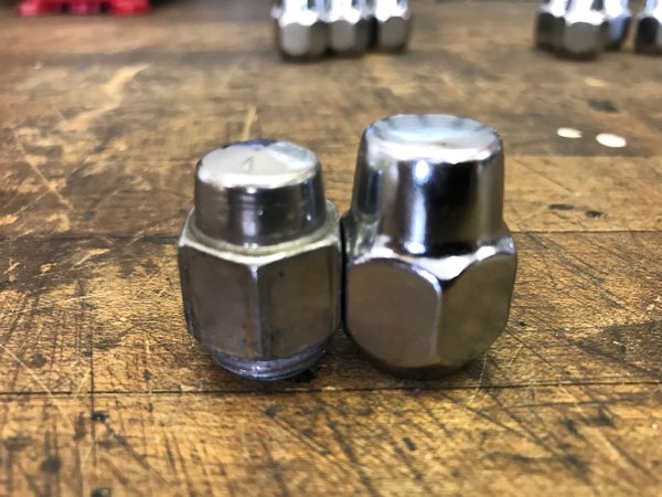

As a follow up on this I received the Inline Tube lug nuts over the weekend and installed them. Problem solved. They don't look bad on the car either.
Originals on left, Inline Tube on right for both comparison pictures. 3rd picture is Inline Tube ones installed.

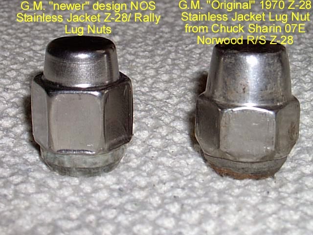

The stainless capped ones shown as "originals" are the low crown 74 up lug nut... (the first mention I have found them is in the Spring of 1973 with the turbine wheel parts list in the Camaro Assembly manual -the wheel I believe was actually introduced in 1974.)
The inline tube lugs are closer (in appearance - not at all technically) to the original GM open faced lug nuts than any of the capped ones which are currently available.
Chuck's photo illustrates the difference -
I have researched the correct lugs extensively as I have been tinkering with reproducing them (original tall crown crimped on stainless caps) and have submitted the technical drawings and specs to a couple of manufacturers in the last few months for quotes so we shall see...

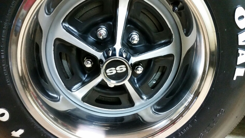

I bought these GM lug nuts. They work awesome. Photo of them installed
