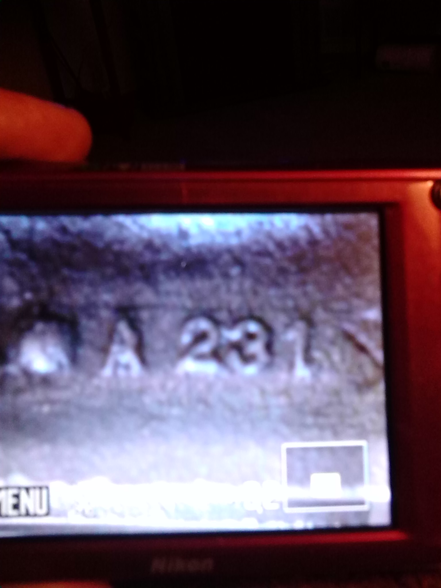

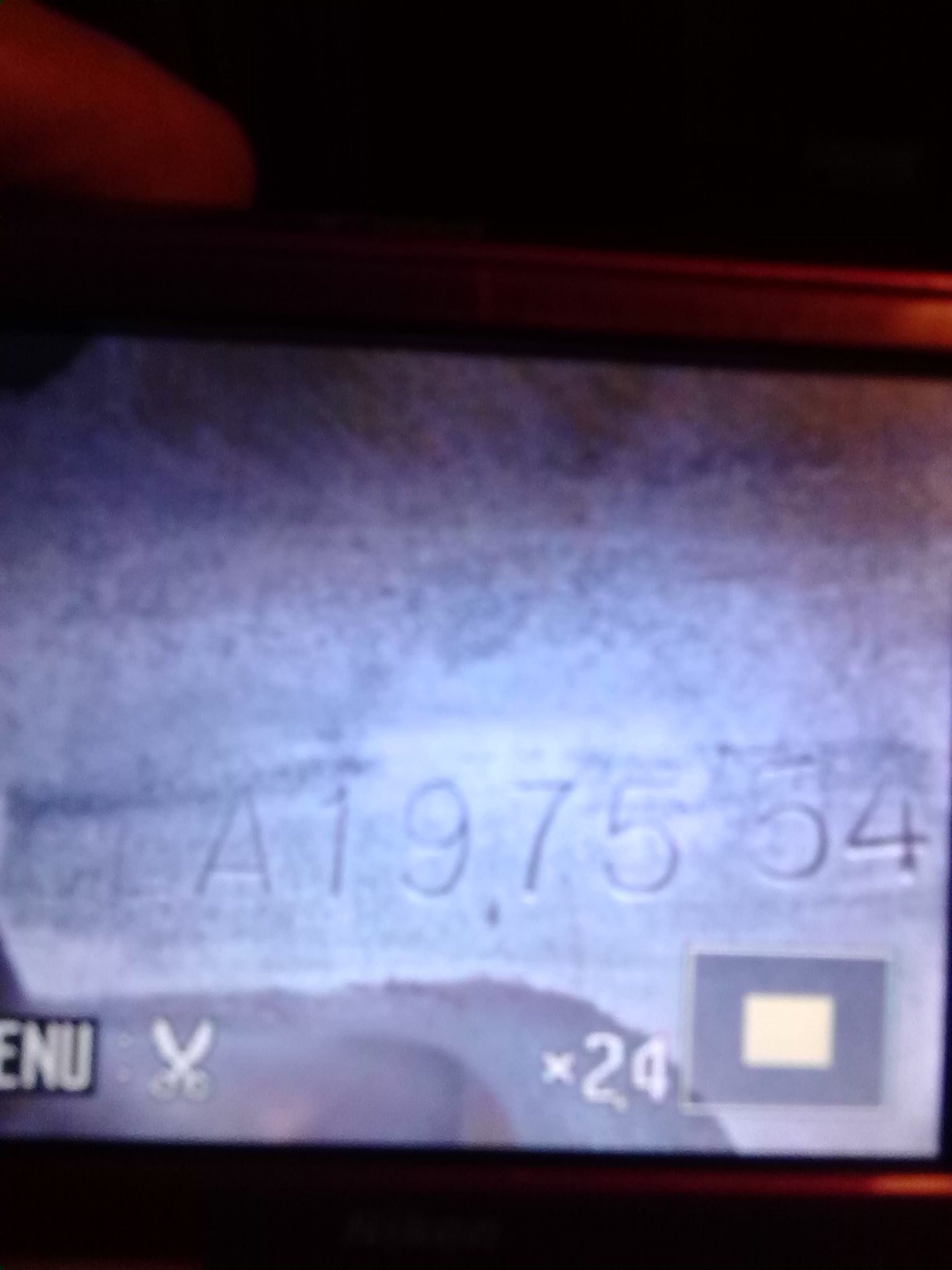

NOS DZ 302 CRATE MOTOR with Floaters.
Was Painted in brush strokes Pink, White , Purple
Cast A 23 1 ...January 23 1971....CEA 1975 54
A Is 2nd. Run of CE Sequence .
Carries the Chevrolet Special Performance Catalog part # as Short Block 1969 302 as it's' a Full Floater , Tuftrided , 4&quot; Bore.
I found and bought the crate motor in summer of 1986 ....I saved the crate , part# tag, pull tag &amp; ship release from Chevrolet Special Performance .
