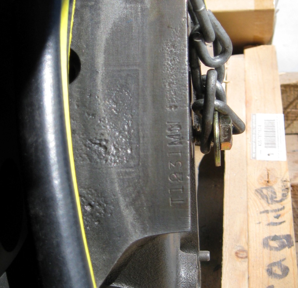

i am sure some of the experts will chime in. is this a known date for an MN block? seems early

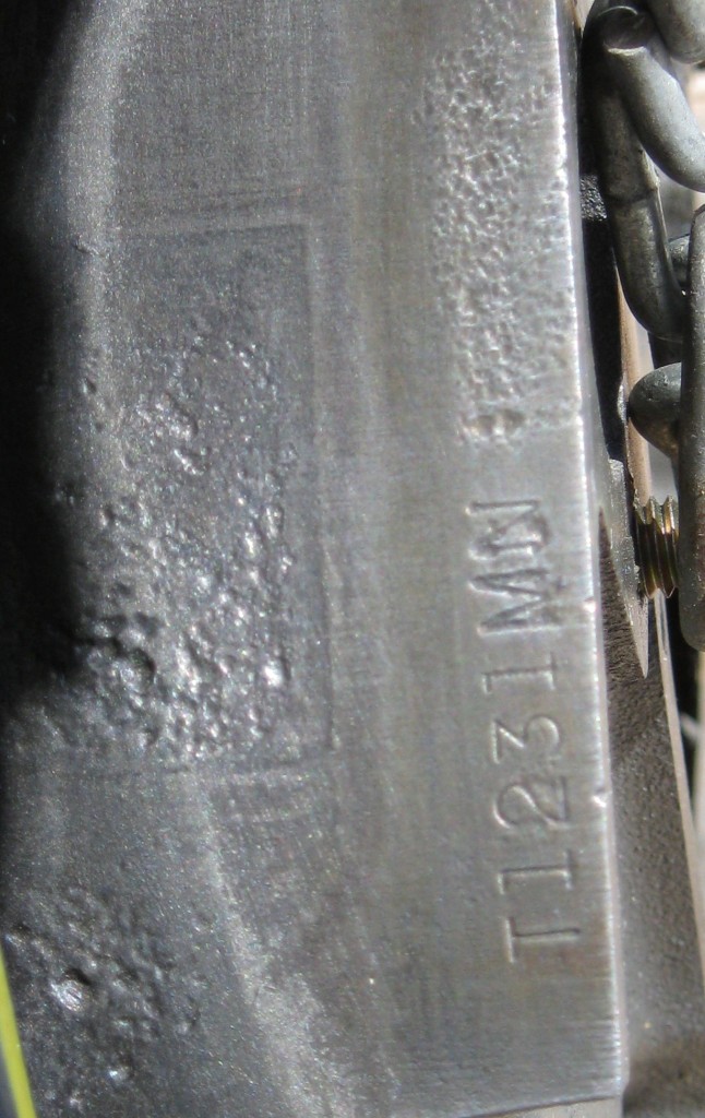

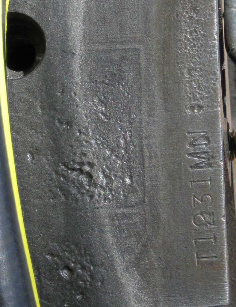

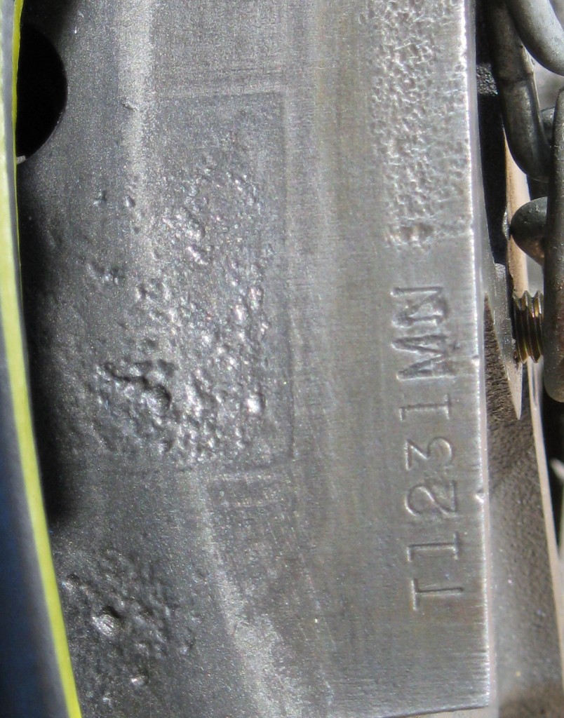

Looks like a restamp to me that acid was added to give it an aged look. Look at the stamping still present over the top of the bottom of the number 3.

used just a cheap canon camera took about 20 pics to get any that were in focus had to crop the heck out of them to get below the 1.0 MB limit 1 pic was 1.1 MB and it wouldnt post.
I will try again Thanks for all your help Lynn

Very poor restamp - IMO

Here are some more pics hope these came out better.
Lynn I put a striaght edge across the pad middle of the numbers there is no dip in the pad its
even all the way across Thanks again Kevin

<div class="ubbcode-block"><div class="ubbcode-header">Originally Posted By: bergy</div><div class="ubbcode-body">Very poor restamp - IMO </div></div>
Yep.

anyone have a pic of a real nearby dated MN block to compare?

This pad has some serious rust pits/holes, or someone threw too much acid on it, never saw a block pad look like that,
