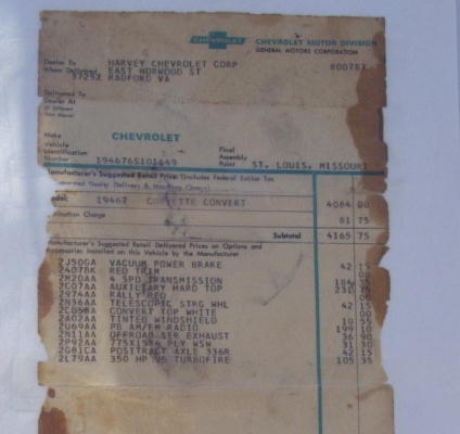

Very early cars can have the VIN completly typed. I've seen this with Corvettes. I believe they could not release a window sticker before a certain date as the cars could not be sold before a certain date. The window stickers were mailed to the dealer when the cars could be sold. I've also seen a few later window stickers with the typed VIN. I don't know of a reason for those, though.
The fonts arent correct on this WS, though.

The window sticker in the ad is for Park Circle Chevrolet which is gone. Jerry MacNeish and I grew up in Baltimore and we both still live relatively close. The name on the warranty and P-O-P is Jerome Bennett---I don't know him, but MacNeish may and may remember the car. If I can I'll call and ask him if he knows about the guy or the car.

Back when the car was on ebay in 2000, it had no docs.
Decked block - acid revealed T04___L - L78 code. Looks like a new block grew with some magic beans. And some docs too.....

What I've seen is that early WS's often had errors on them and pricing might not been fixed - thus, were mailed to the dealer.
It couldn't all be due to the sales date cause I see a car shipped over a week after Sept 19th, 68 that has a typed VIN.
