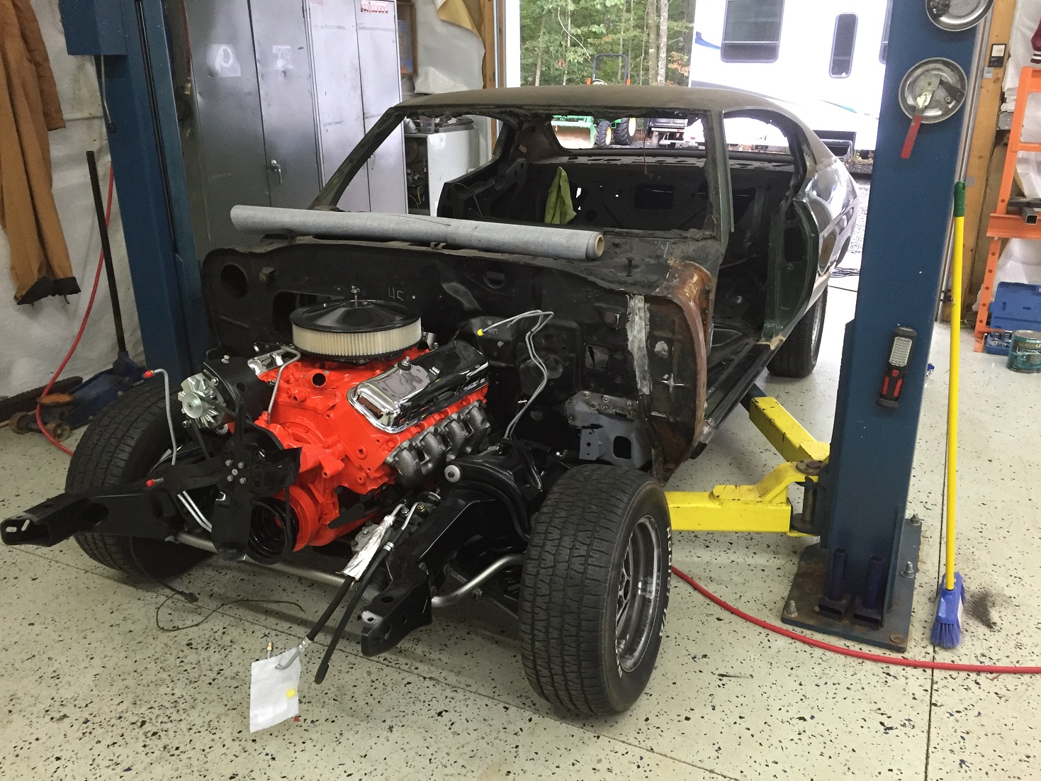

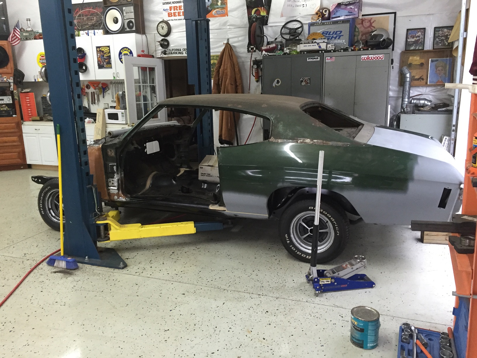

  #29
Old 09-27-2015, 01:26 PM
Luis Luis is offline
Join Date: Dec 2011
Location: MD
Posts: 361
Thanked 8 Times in 8 Posts

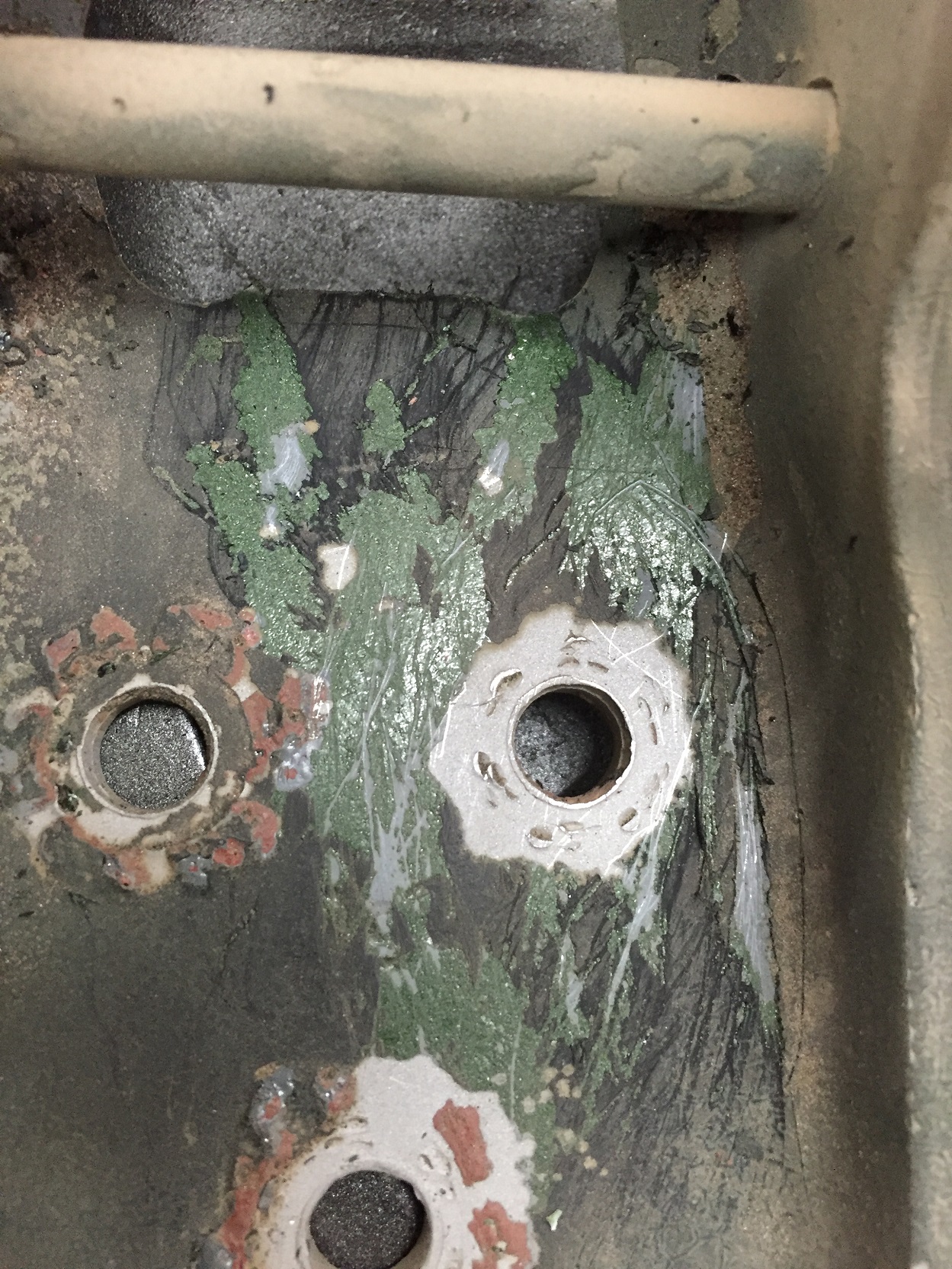

Default Re: 1970 Canadian Built Chevelle Extremely Documented
So body back on the chassis for test fitting doors, hood, fenders, etc. Once fitting has been completed back off the chassis. The reason for the door hinges pic is there have been occasions when points have been deducted when cars have been judged. Judge claims not painted...owner yes they were painted. Clearly these have the original paint. Having a friend restore then.
Funny feeling...it actually looks like a car.

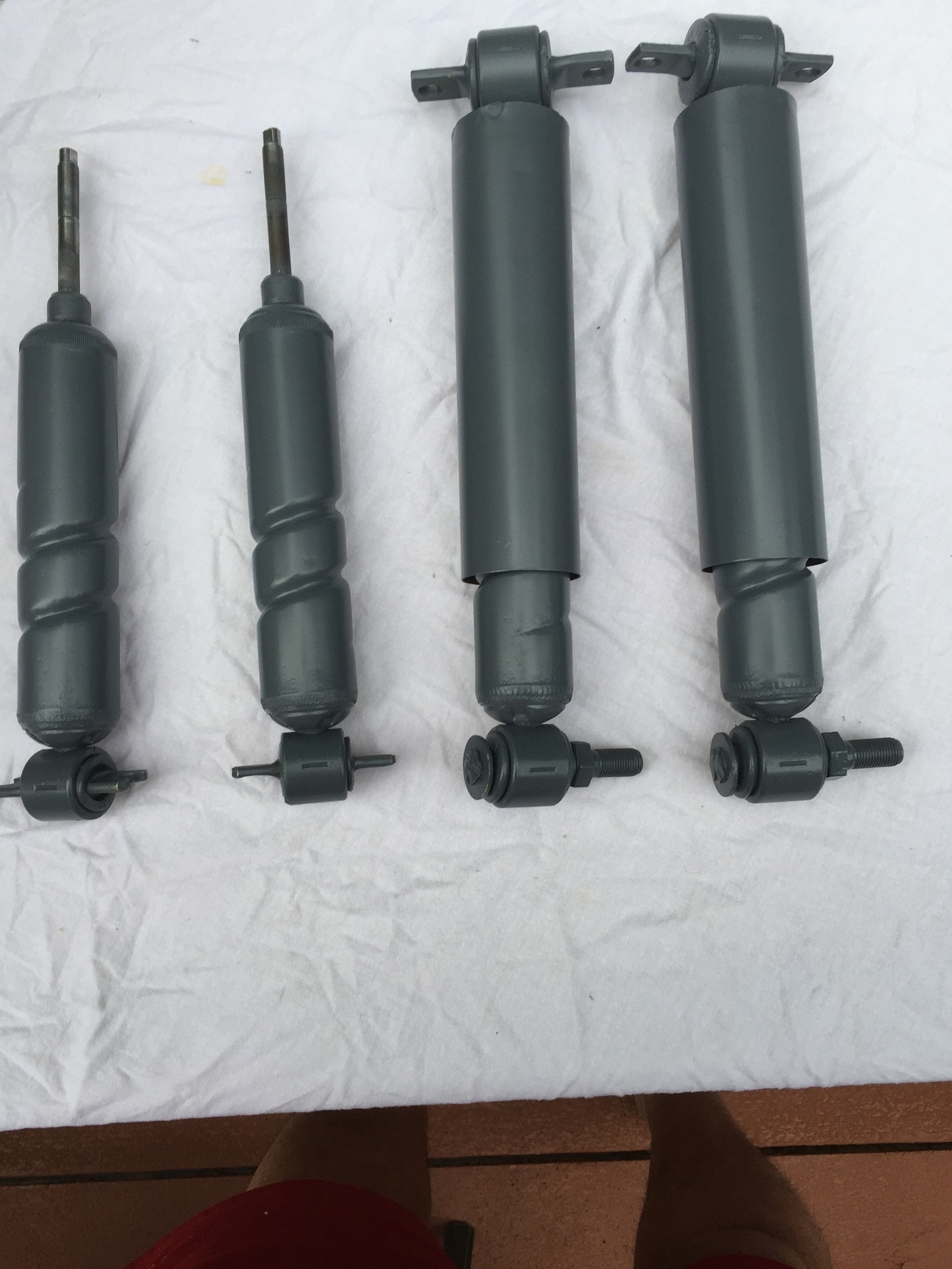

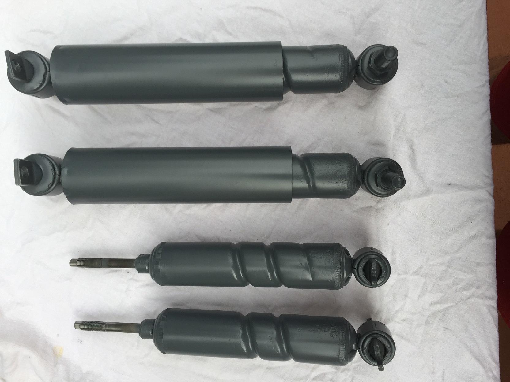

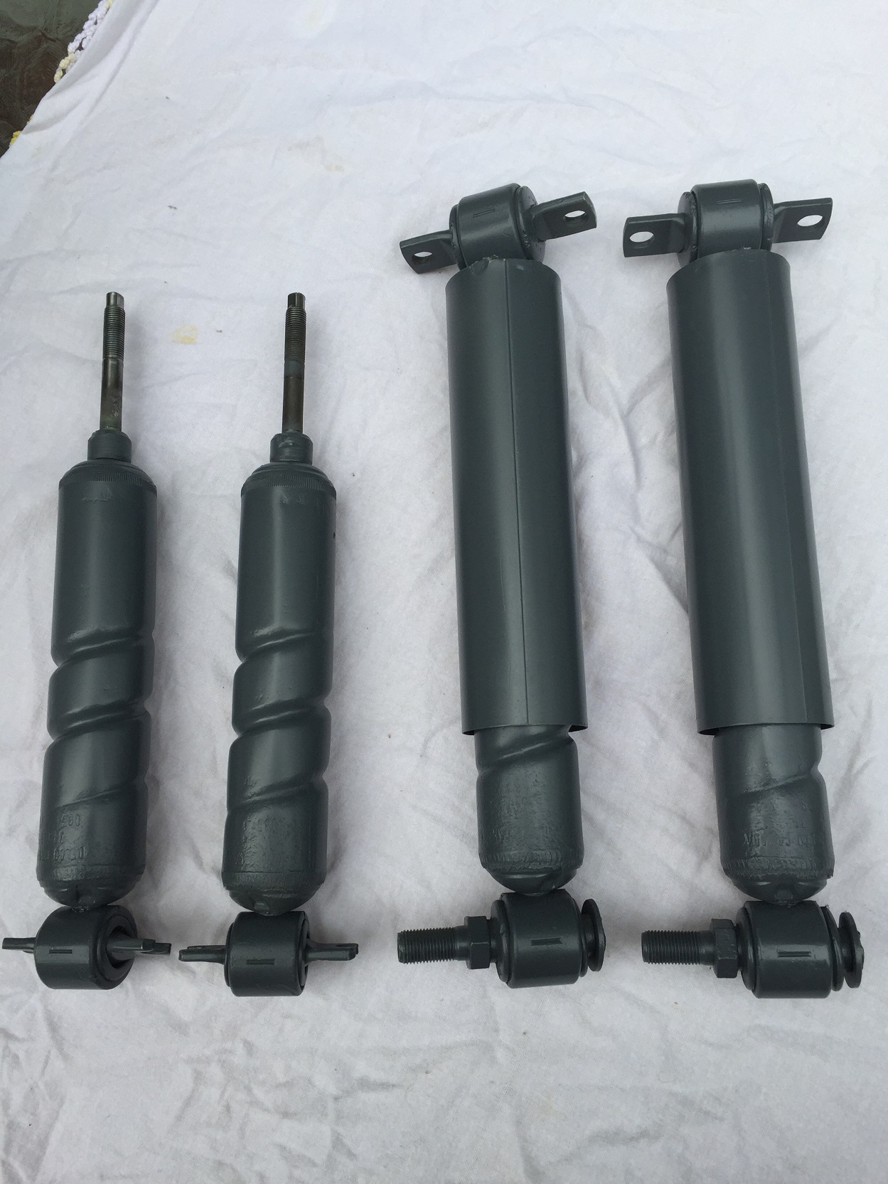

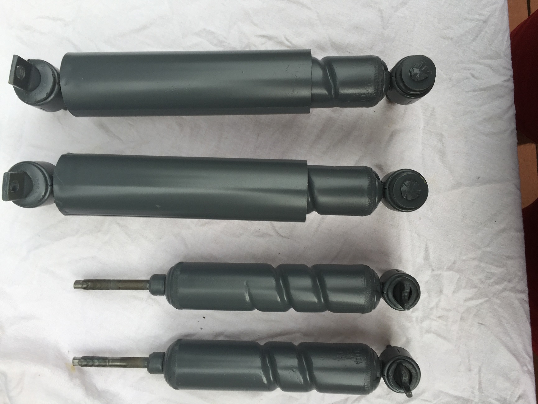

  #30
Old 09-27-2015, 02:11 PM
Join Date: Dec 2011
Location: MD
Posts: 361
Here are pics of the restored shocks.
