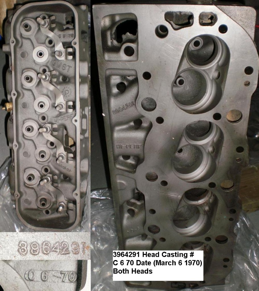

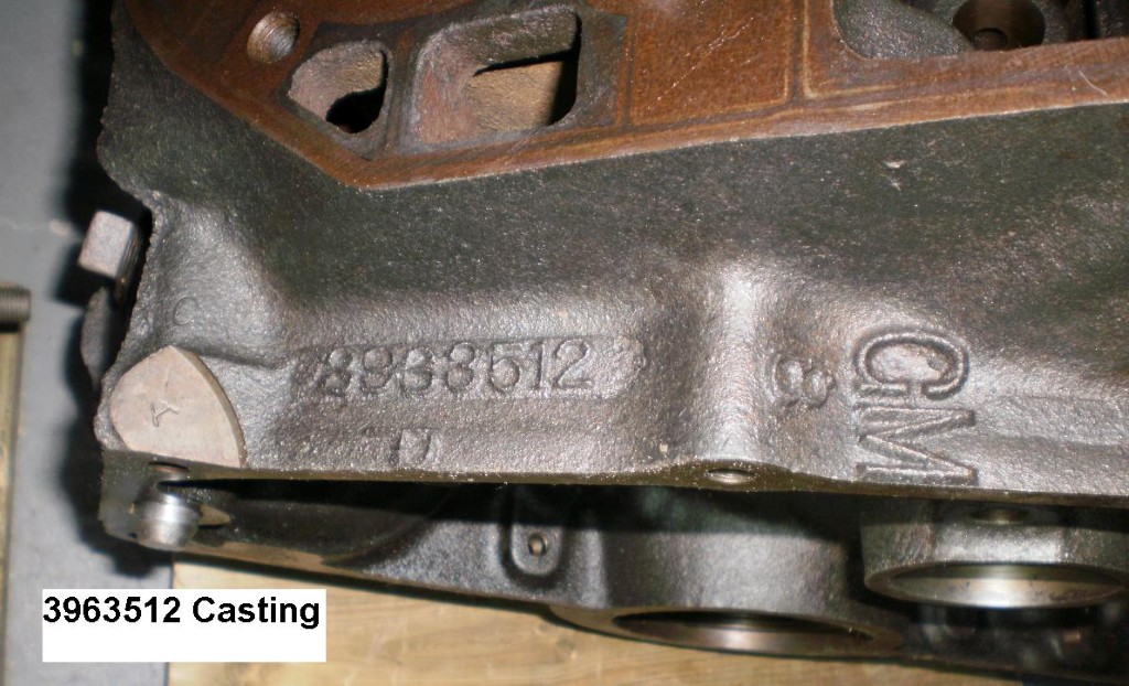

Block is at .30 over and heads are bone stock, crank is a stock 7416 piece.
