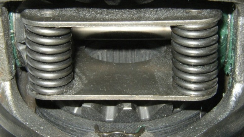

This was requested posi rebuilt I think those are the correct springs?
4:88 GM gears by date im guessing they were installed in 70?

That looks like a HD offroad unit. It isn't a COPO 234 unit. Those gears appear to be the 17 tooth axle gears and the springs/plates are either 400 or 800 pound preload parts. It also appears to have the notched pin for 5.13+ gears. Hope this helps.

I sent it out to be rebuilt the internals are new, the other springs looked about the same to me

COPO unit.

Eric, I will have to ask my friend Mike his shop did it I told him it was a heavy duty unit and rebuild it as that I will see if he has the stuff that came out of it, he throws nothing away, the other side of the housing is different than I have seen just a small hole
