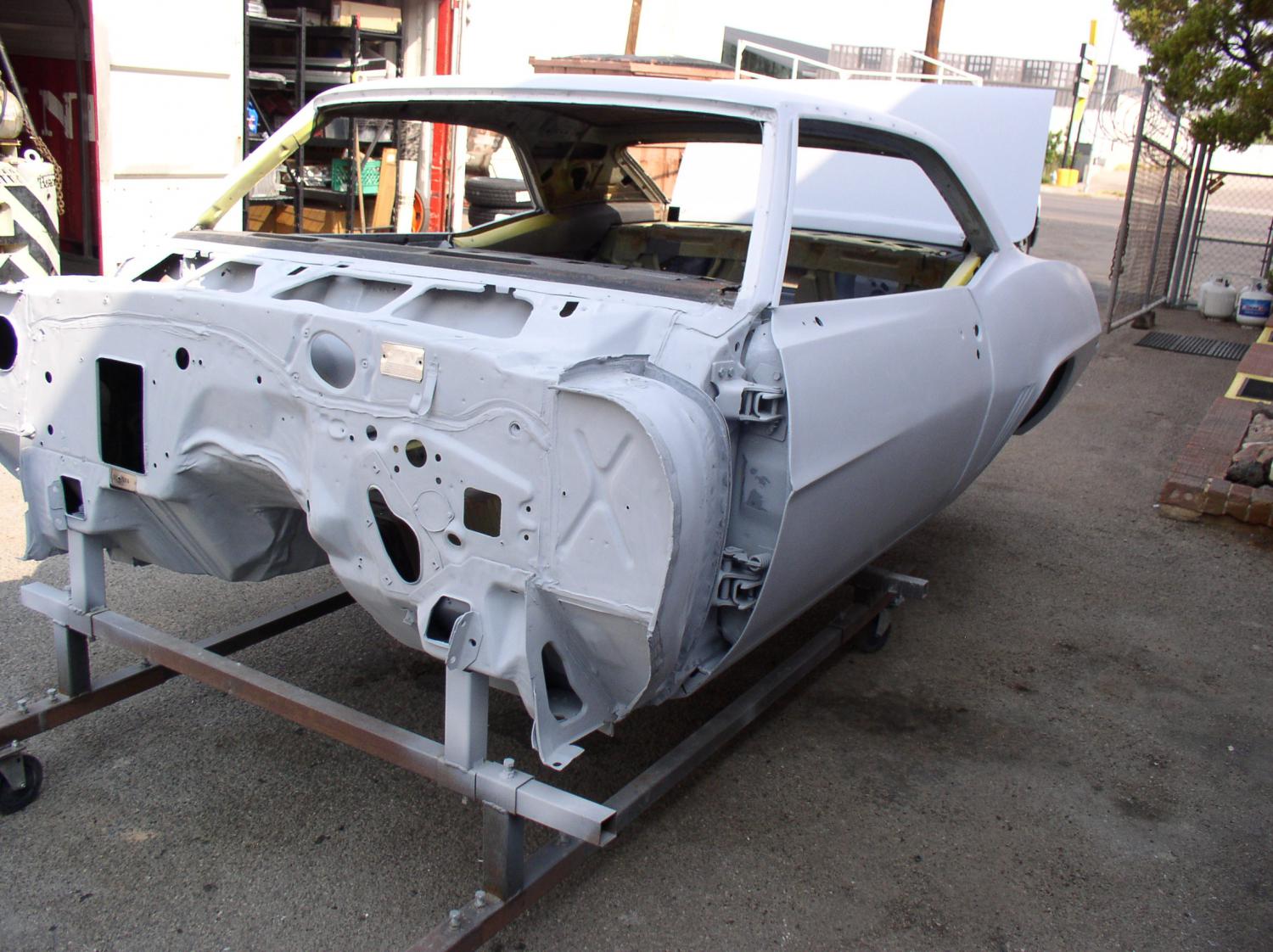

They all have the hole Graeme. Don't fill it. Here's a picture of mine before paint. I don't have remote mirror....Joe
Looks like some screw holes on the passenger door for a RH mirror. But thats the yellow door? So the orange one is ok

I didn't know that hole was there on all doors or that it would be covered by a standard mirror. Just knew the door was from another car so thought it was an option. Learned something new today. Cheers

Rob, one of the former owners or perhaps a dealer may have added the right side mirror as it was on when this picture was taken back in the '80s. Not sure when it was installed but I will leave it there as I like having one on the right.

There is a metal tab also, inside the door near the hinge. It holds the remote cable away from the window.
