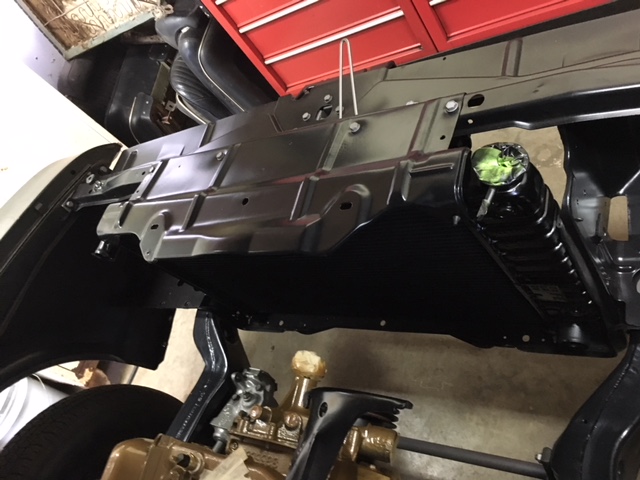

I think my inner fender plates are done:-)
I started mounting up the bumper brackets.

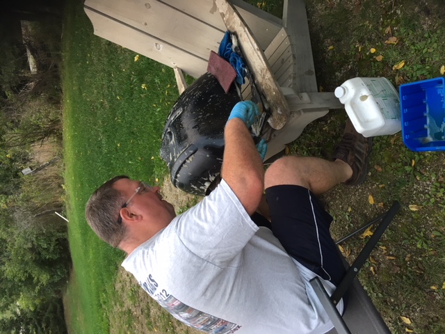

I started restoring the fan, huge ugly defects... the paint doesn’t like the blades... I will have to try again...

Assuming it has/had a fan clutch - probably getting some fish eyes due to silicone leaking from the fan clutch over the years. Fairly common restoration issue if I recall. May take a couple/several coats of paint with sanding in between to smooth out the fish eyes.

I think so, I media blasted it, lightly, lightly, then washed it in solvent, then washed it in Acetone.... and expected no residue. (Looks like huge fish eye craters)
Second coat of paint looks much better... may sand or may start over, or maybe it will be ok as is. TBD.
