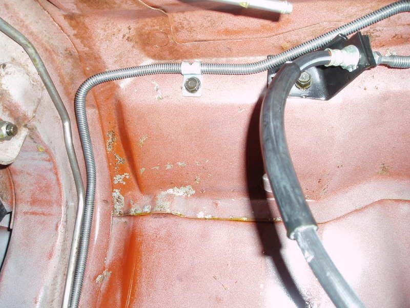

And here's the rocker panel area before:
and after about 45 minutes:

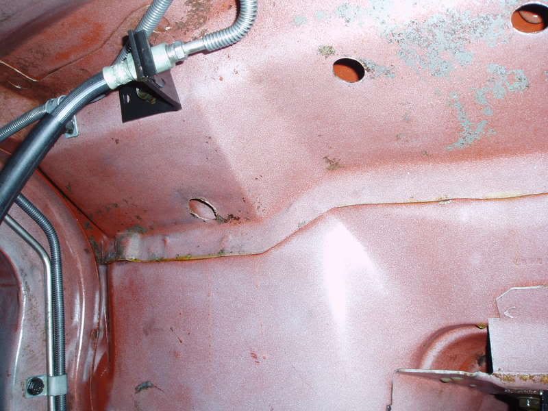

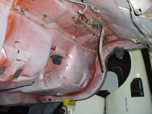

Passenger side before and after:

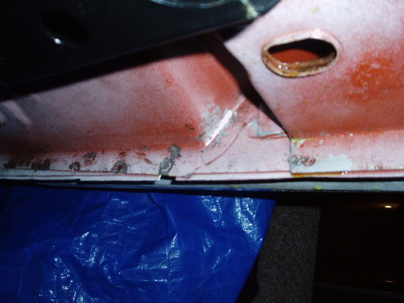

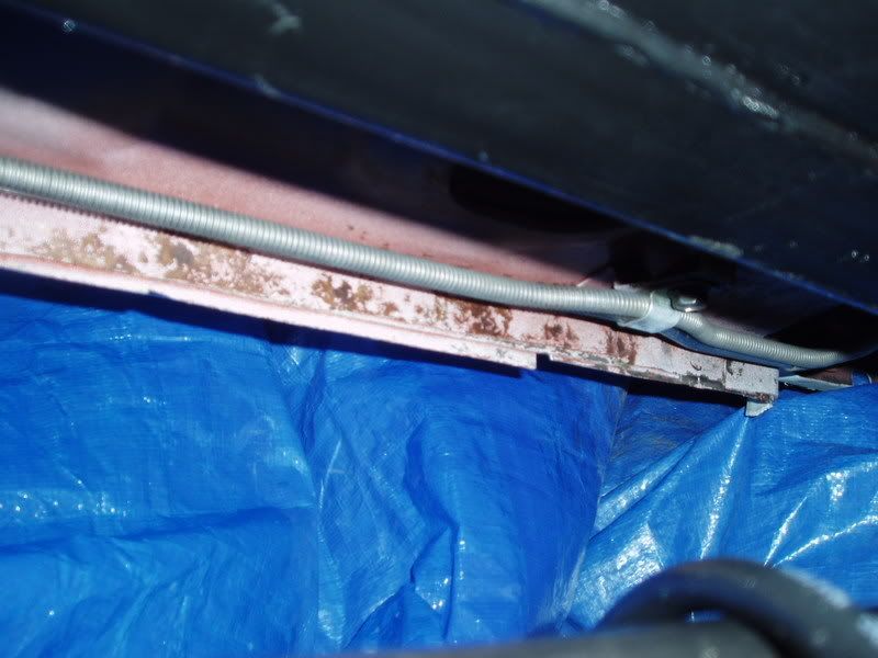

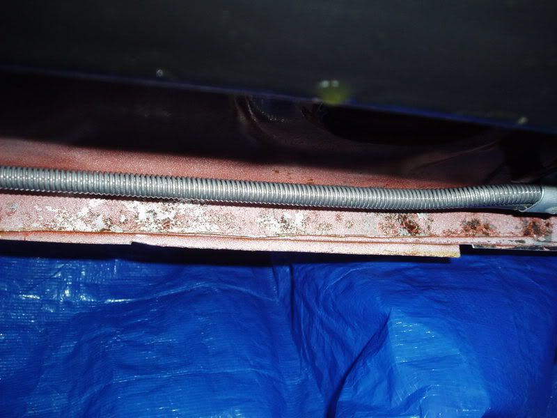

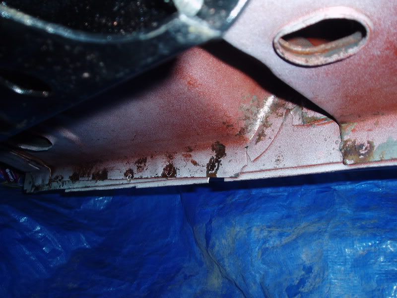

And here is the rear bulkhead area above the rear differential. It had a lot of darkened, rusty areas that cleaned up rather nicely in about an hour. It was a mess to do this area, though. I had to place a kiddy pool under the bucket to catch all the dripping fluid so it wouldn't go to waste (at $25 a gallon it's pretty valuable).

How are you going to treat those areas now? Do you try to reproduce the red oxide primer with overspray?

The rust removal stuff when dry, gives you some degree of protection for a couple months. That will give me a little time to do some careful touch up on the various spots. Since the center of the trunk floor needs to be replaced we will end up fogging in the areas behind the rear valance. The gas tank braces were the most scaly parts of the car anyway and they will need to be refinished along with the trunk floor.
By the way, here is how the rear bulkhead area looked before the rust dissolver stuff was used:

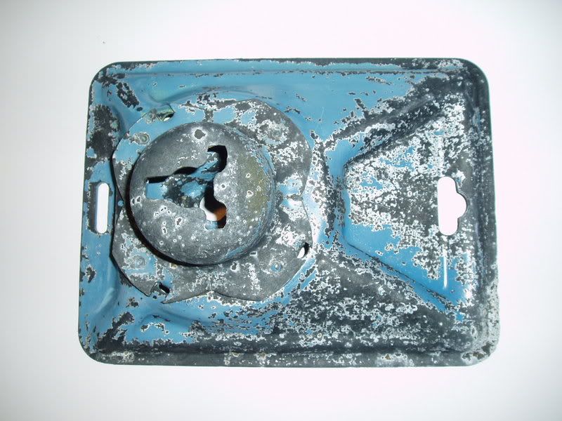

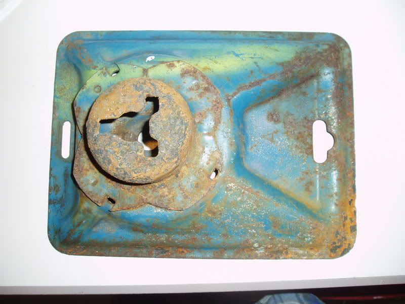

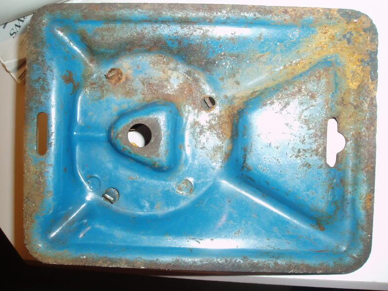

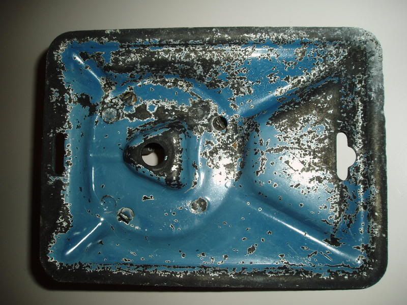

BTW, here is what that derusting stuff can do for hard metal pieces: here is the jack base from the car:
Topside before:
Topside after 2 days of soaking:
Bottom before:
Bottom after:

If you mean the underside finish, it isn't faded, that's all the original assembly line white paint overspray on the red oxide e-coat primer. I will probably try to match the finish somehow on the under trunk area as we have to replace the bottom of the trunk floor and may end up painting the underside panel up to the upper rear dif area bulkhead. I guess we'll have to prime it and then fog in some white overspray to match.
