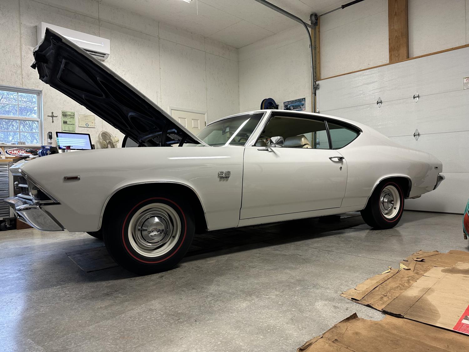

please show us how it sits with 2" lowering springs and what brand and PN on springs

Sure Zman1969. The springs are BMR SP015R. There is also a revision code letter at the end of the part number on the spring (it doesn't show up when ordering) - I don't remember right off the top of my head what it was on my springs.
