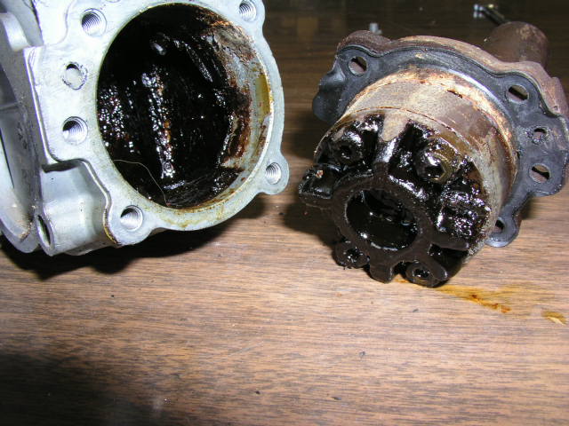

Pulled the high pressure pump out of the float bowl. It is built like a oil pump and was stuck from all the gunk. It is driven by a cable from the distributor.

The drive cable is broken and I probably did it when I tried to start it. I think I have a spare somewhere in my toolbox though.

They will darn sure snap the cable if the pump is locked up. You can have a cable made at a spedo shop in a pinch to get you home. (Guess How I knew that)

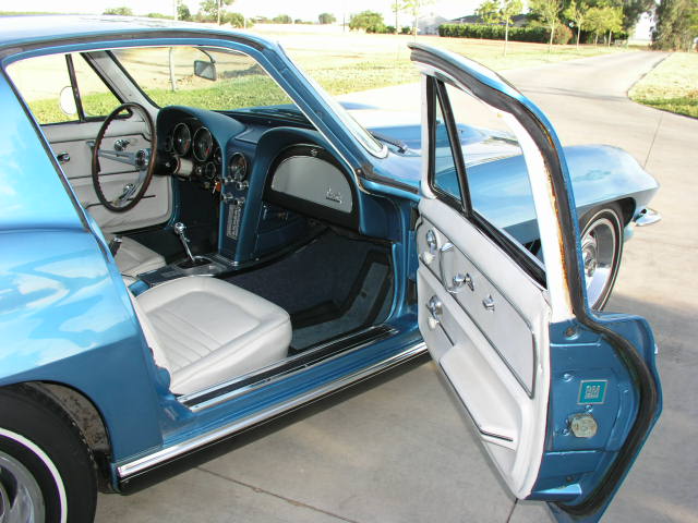

Thanks Bill. The Fuel Injection and the Silver 67 have morphed into a 67 Marina Blue, One owner till about a month ago, All orig paint, 427 390 hp car.

White Stinger

White and Blue interior.
