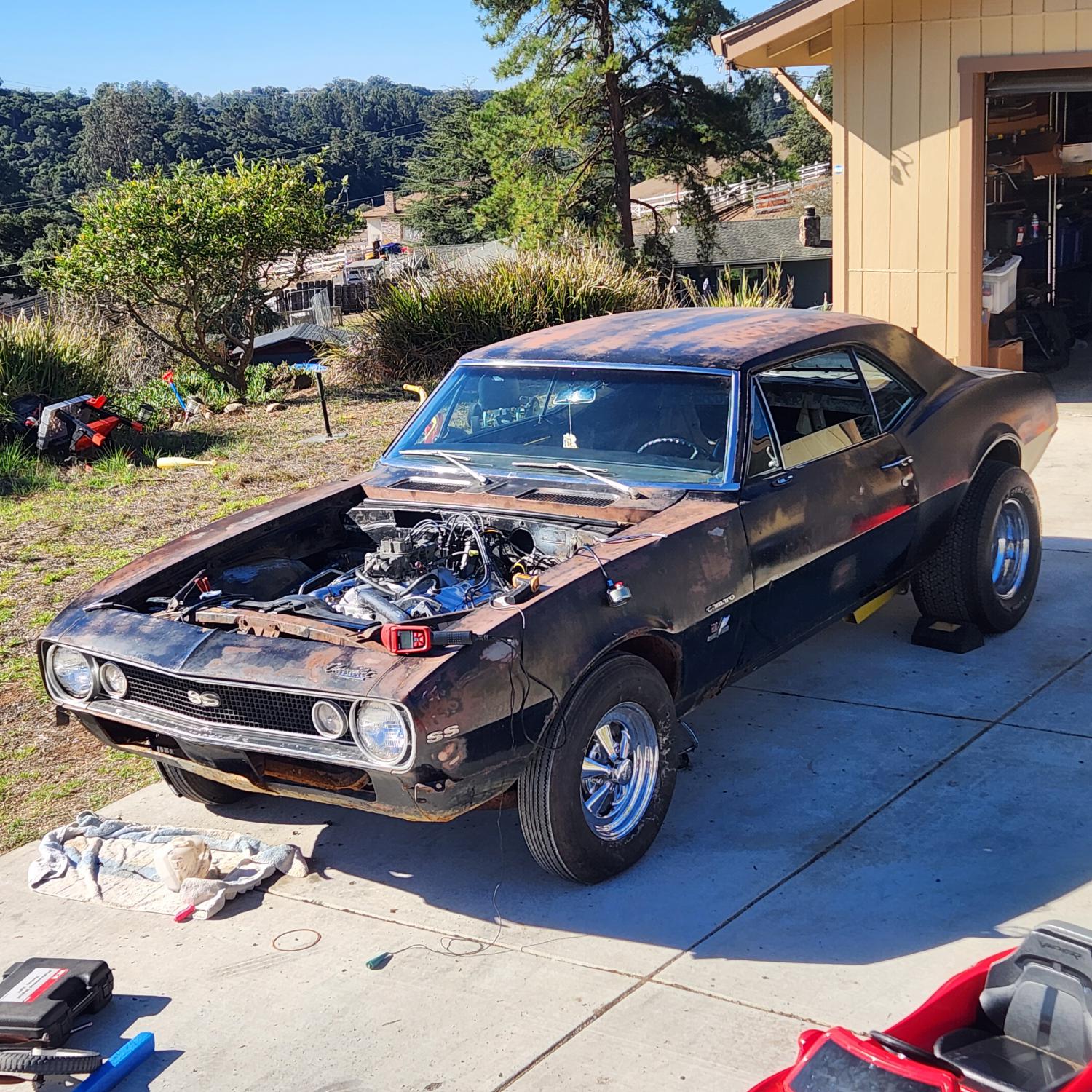

I temporarily installed the front clip and it feels good to see it resemble a car again. It will come off to install the emblems and button up the engine bay before firing it up.

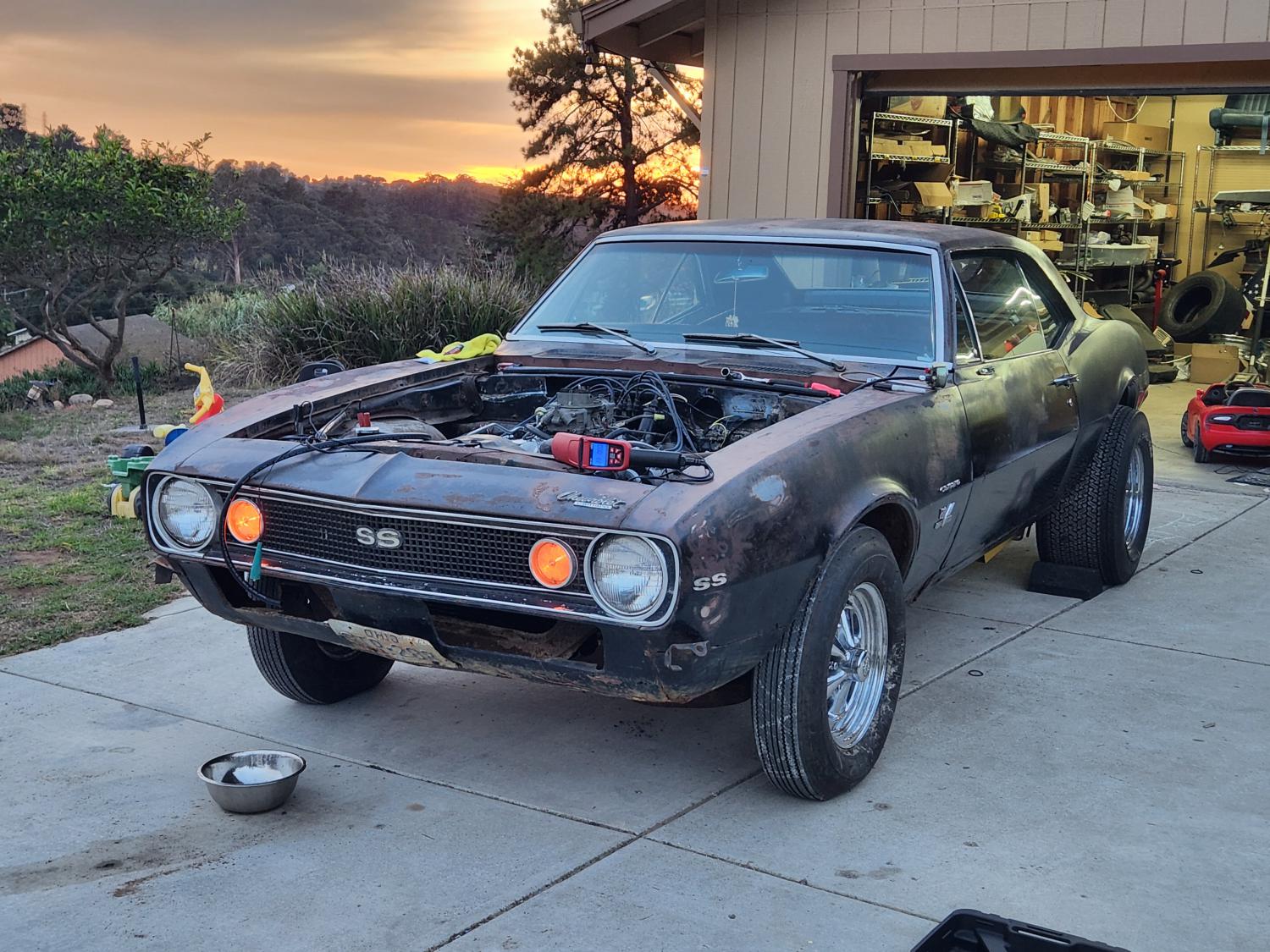

I bought another car from a member here Fred Yates. So I've been cleaning up and making room for the El Camino and parts.
This is the first time the Camaro has been outside in a while. The small parts I needed to start the car have arrived now it's just a matter of labor.

Cooling system installed, correct driveshaft installed. I swapped the yoke to fit the larger output of the '70 M22. This driveshaft was removed from an L78 race car. I also removed the correct early shroud from the same car.

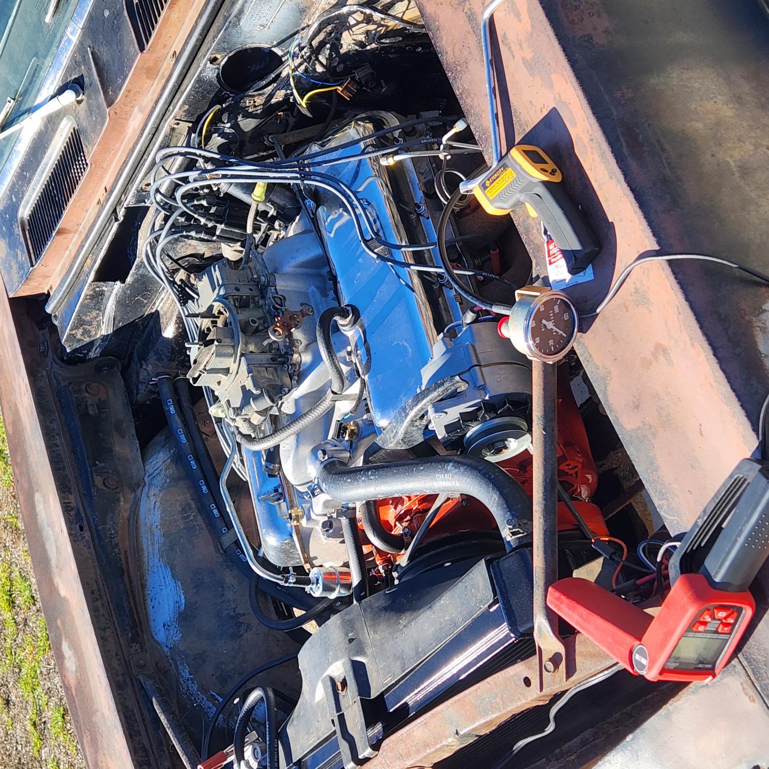

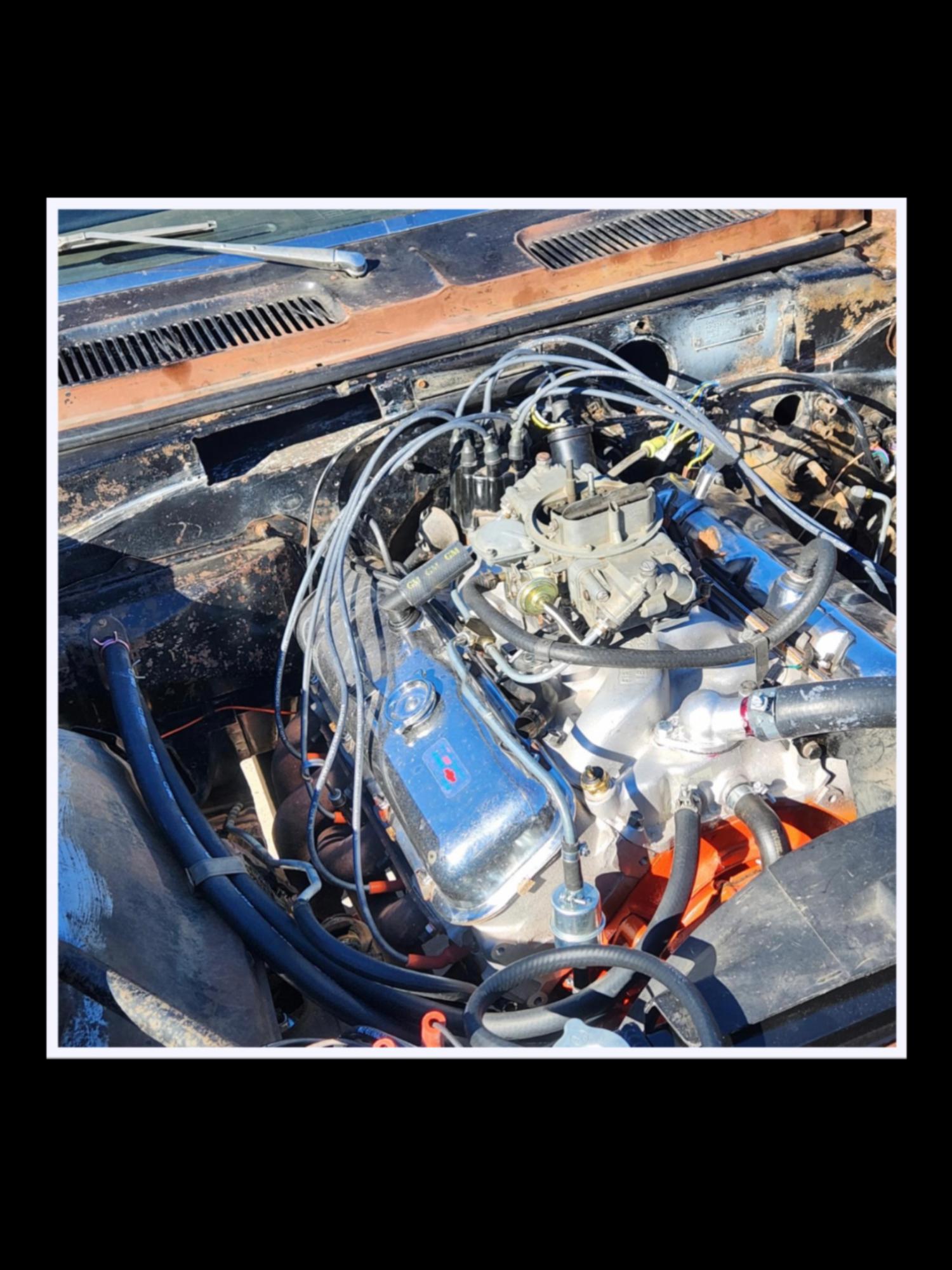

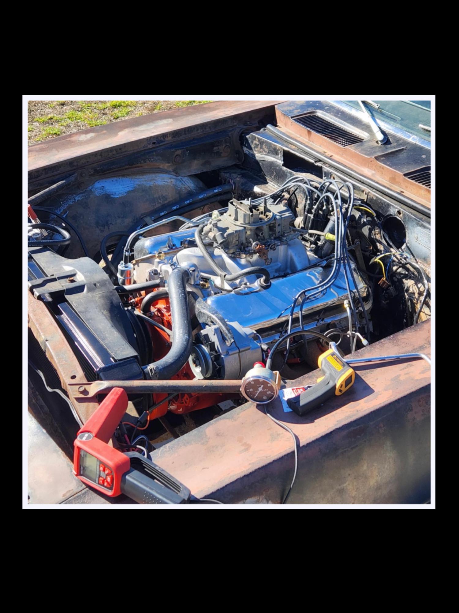

It's alive! I used the 10 10 10 method for break in. Nothing broke, no leaks, steady oil pressure at 65psi. I still need to tune it. This is the first time since '83 this car had a running engine.

After some adjustments. Getting closer!
