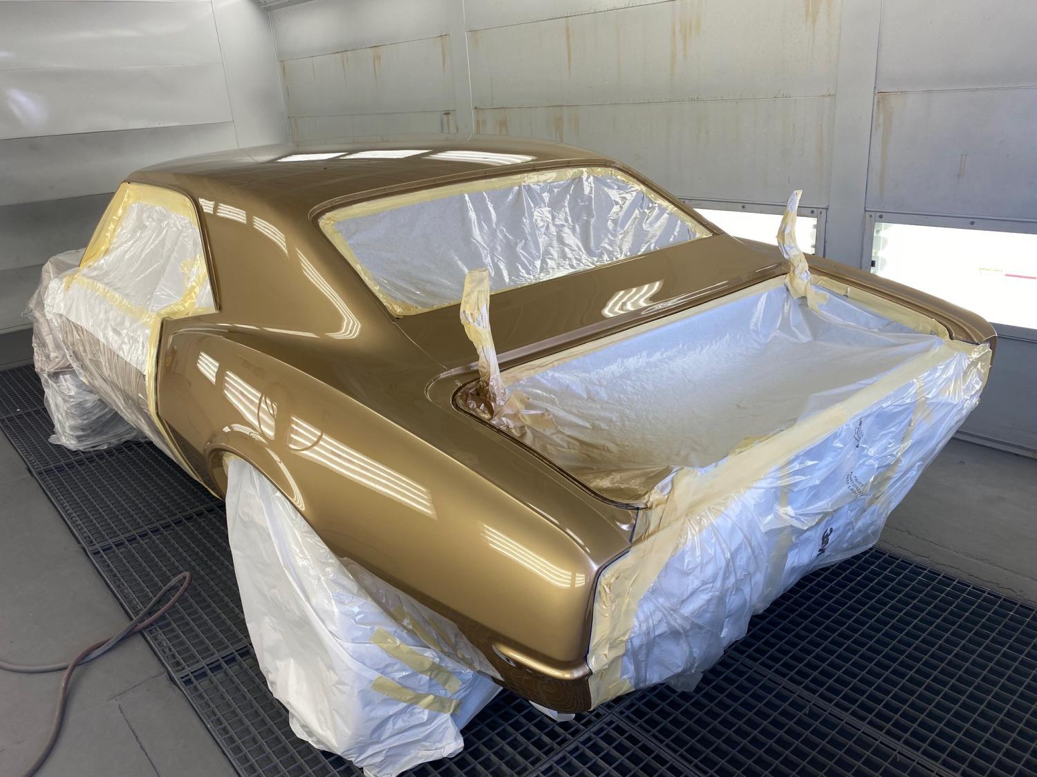

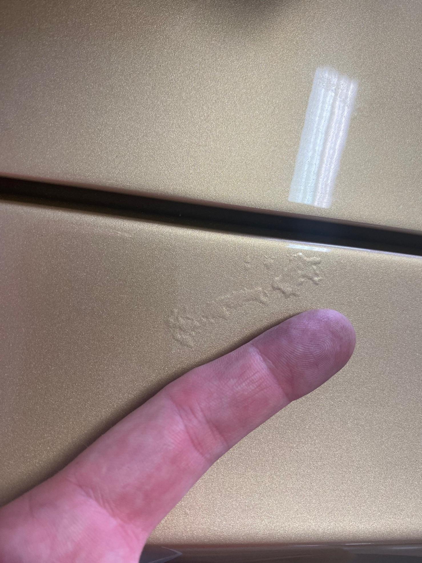

Another step backwards was an issue with the paint on top of the left 1/4 panel. Unfortunately the paint began bubbling. I figure it was corrosion starting... When my painter sanded the paint off we found no evidence of rust. My guess is it was moisture under the paint, maybe another form of contaminant like oil or something. This was stressful because so many of the restored parts are already on the car... Luckily my painter took his time masking everything with cars! He was able to spot the area with paint but had to blend the clear into the roof and right 1/4. Repair looks great but now I need to sand it back down and polish it all over again. My buddy and I spent 4 days polishing this car the last time.... I mean this is FUN right? At least we caught this early on and the paint matches perfectly.

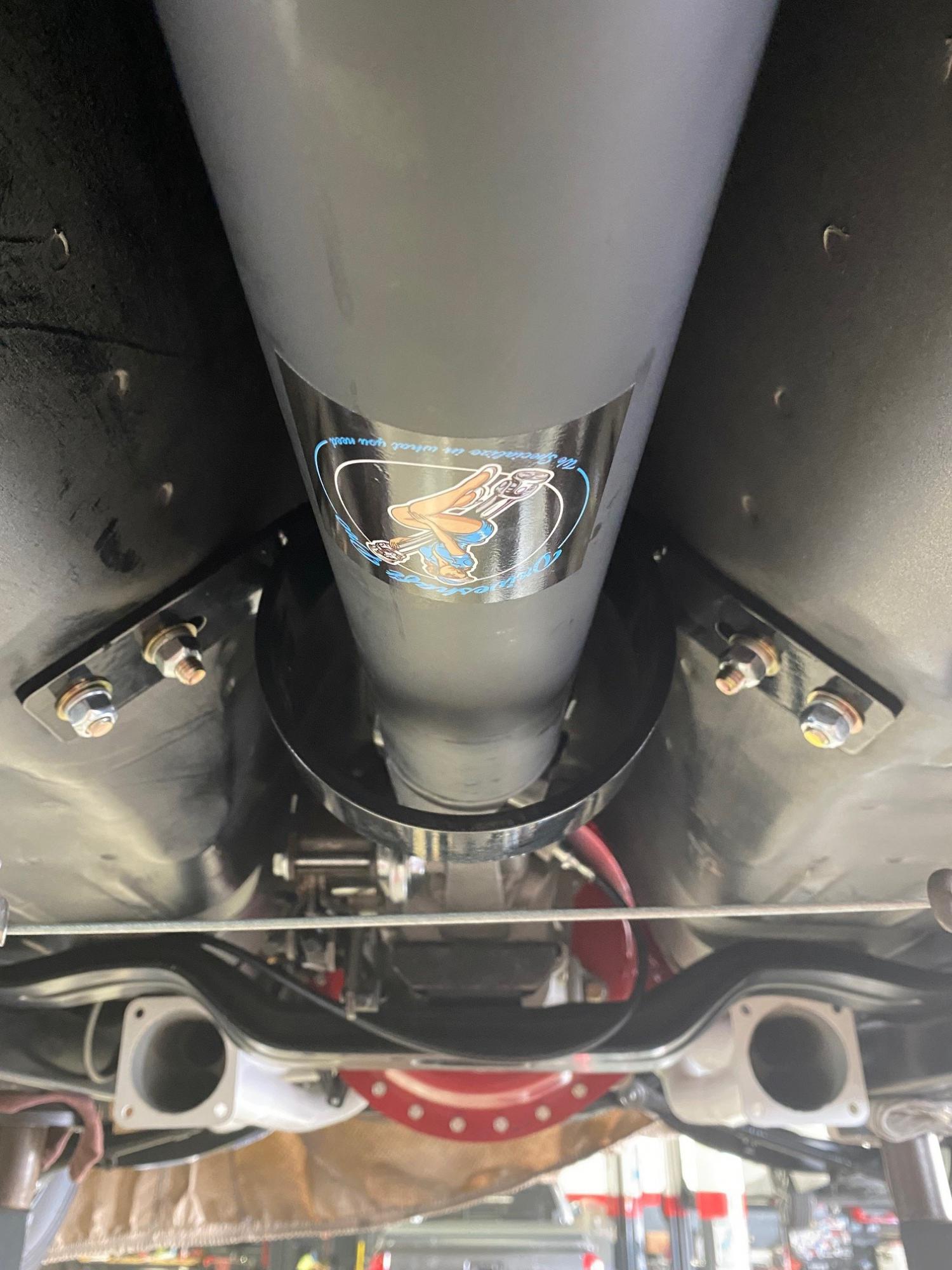

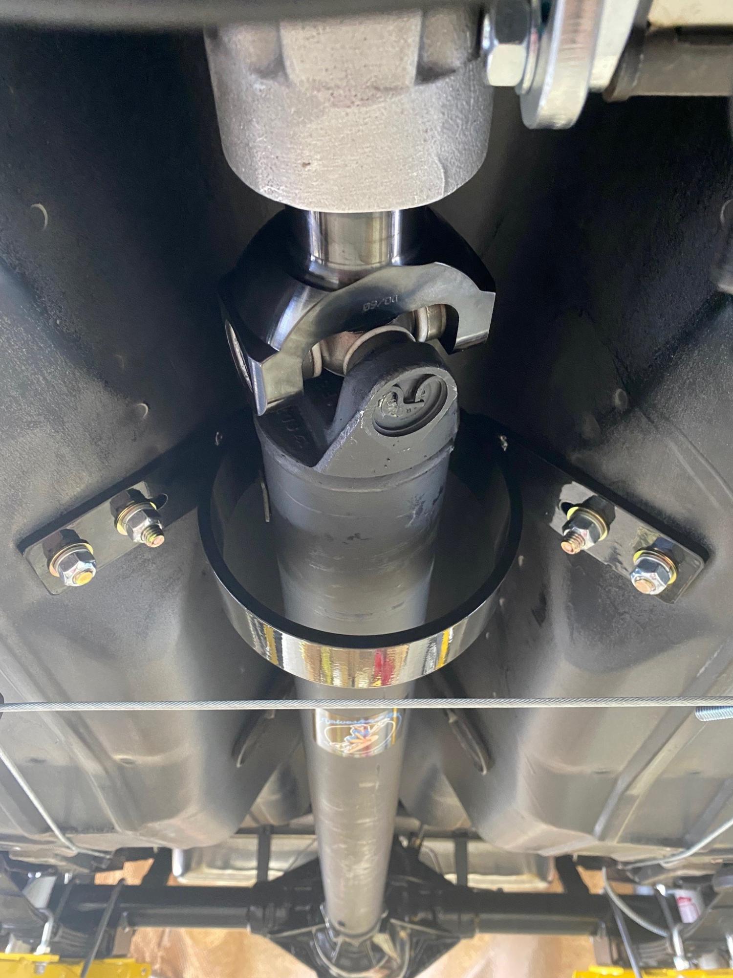

I got my driveshaft built by a local shop here, Driveshaft Pro. 3-1/2" steel with Sonnax slip yoke and 1350 Spicer u-joints. I was reluctant to add holes to my virgin floors for a driveshaft loop but decided it was for the best. I had an old Lakewood universal loop but didn't like how it fit, seemed too many mods to the floor would be needed and there wasn't much clearance with the larger than stock u-joint and drive shaft. I ended up buying a loop from Metco Motorsports which mounts to the tunnel instead of the floor. Lower profile and more clearance as it is perfectly round and has a 6-1/2" diameter.
The Following 4 Users Say Thank You to Chuck_Burg For This Useful Post:
big gear head (09-01-2021), napa68 (09-01-2021), NorCam (09-11-2021), Xplantdad (09-01-2021)
  #240
Old 09-01-2021, 07:11 PM
Chuck_Burg's Avatar
Join Date: Feb 2019
Location: Long Beach, CA
Posts: 587
Thanks: 627
Thanked 1,087 Times in 286 Posts
Loop install...
