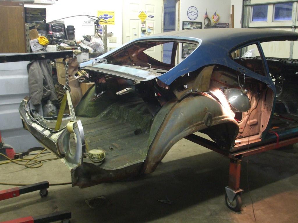

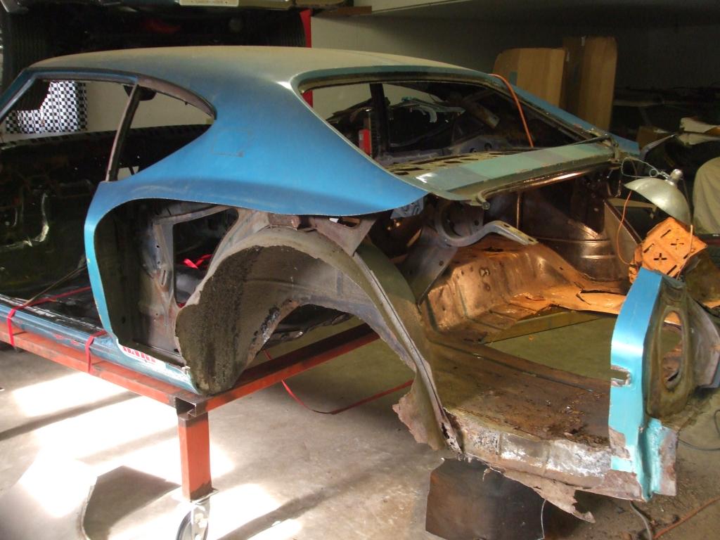

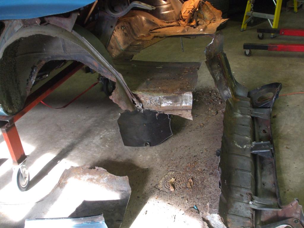

Hiding in the bottom of the right rear quarter.
Left rear quarter cut off.
See-through trunk area
Rear panel lopped off
Wheelhouse removed
Donor rear section being prepped for install
Rick

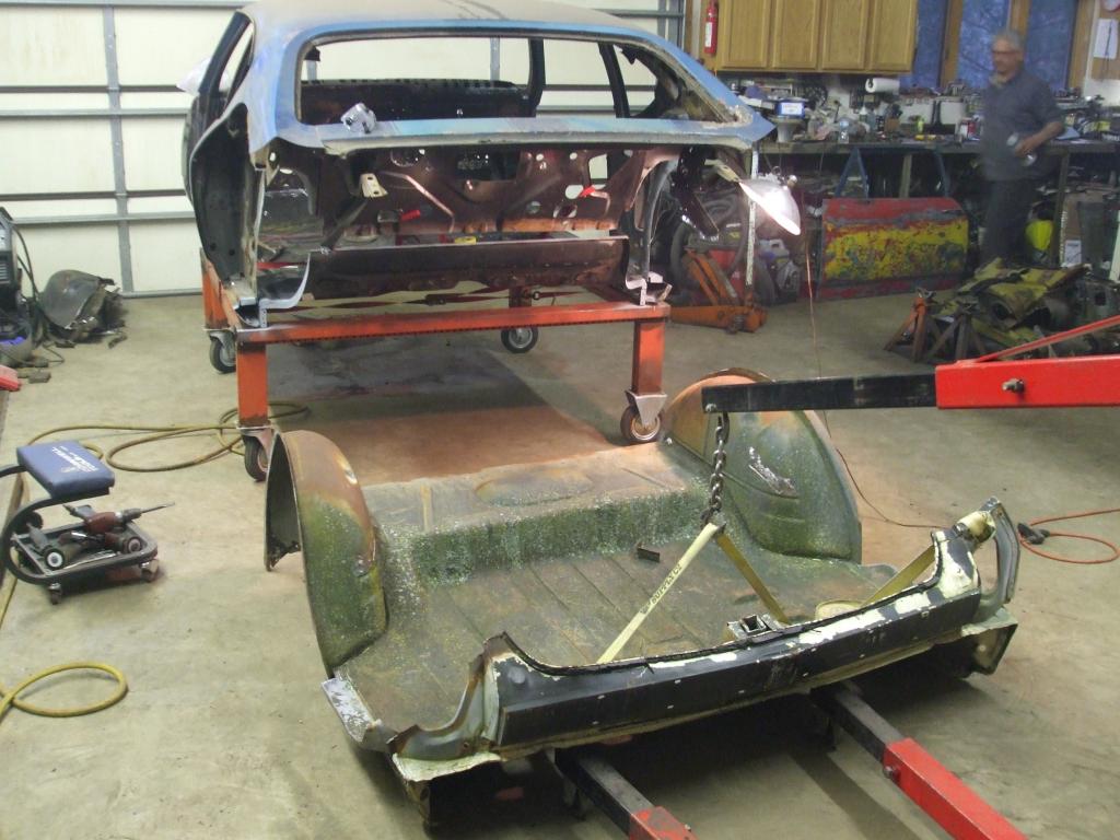

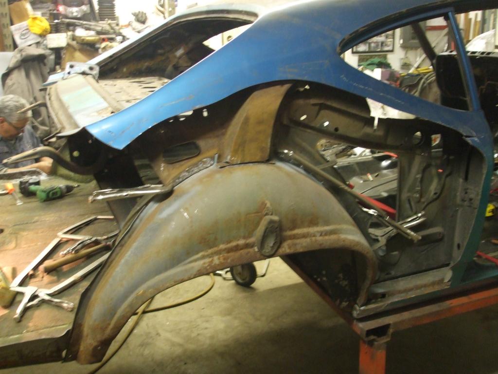

Ready to position rear donor section
Lining it up
Rick

I stopped by Rick's place yesterday. He and his co-worker were hard at it. Rick said it's the deepest he's ever been in a car but he sure seemed like he was having fun.
Below is a picture of Rick's doctor at work.
