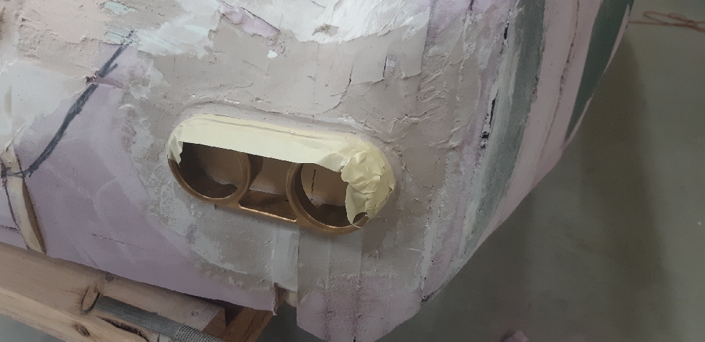

Tail light positioning and I'm liking the lines back here more and more. I'm going to massage a template for the edges of the rear quarter to make sure they are symmetrical. Right now, it looks pretty good. License plate relief and trunk opening are there too.
I'm hoping by the end of next month the car will be filled and primed. I need to make a steel frame with rollers to position this on since the weight of this thing is more than I thought!

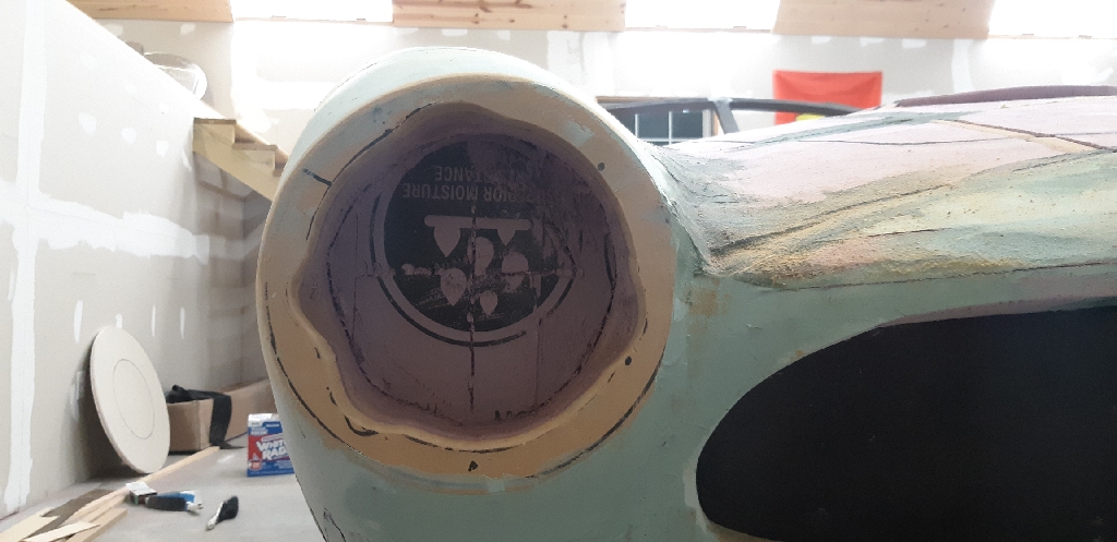

Headlight bucket time! In studying the whole front end, I needed to recess those headlight buckets and also extend the cap a little bit further. This added the extra lip I needed as well as the angle now being correct.
Every little step is a big move forward. This took a good day to get it right. I'm describe it more in detail once I get it fitted up. More to come!
