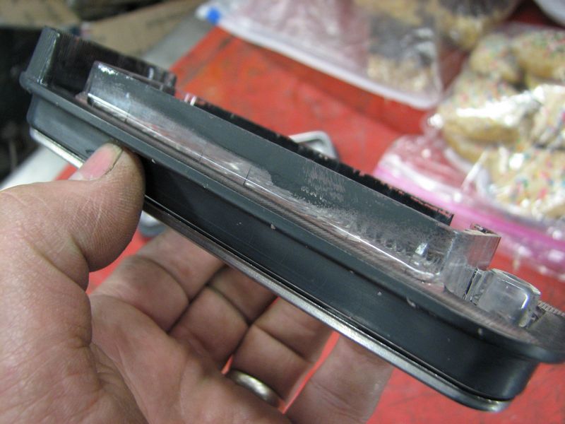

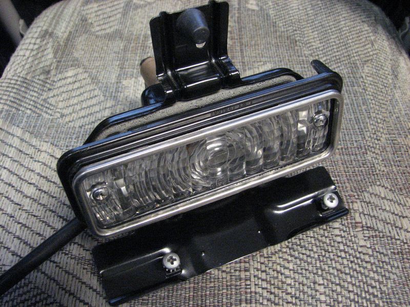

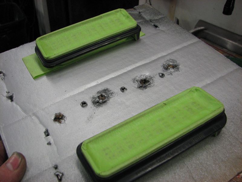

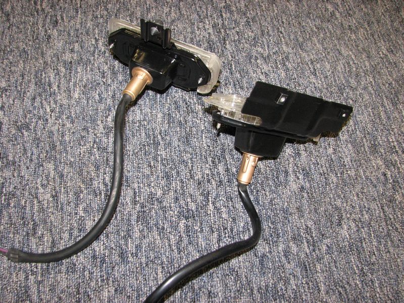

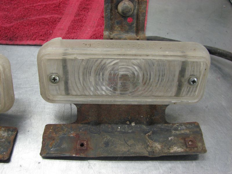

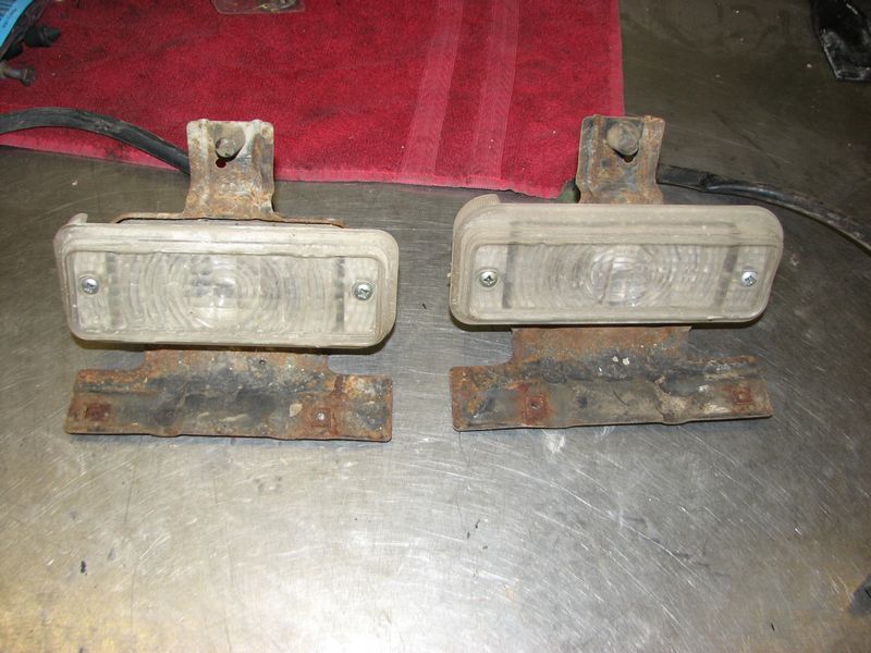

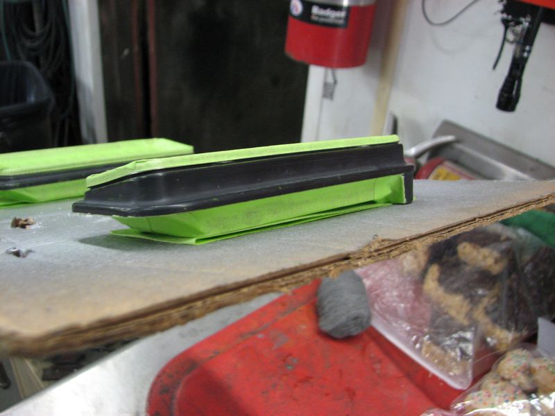

Because we are trying to use as much as possible of the original parts for this car or at least original 69 parts and not reproduction I took some original 69 front running lights and spent many an hour restoring them correctly instead of repops which are close but not close enough. They required a fair bit of effort but I think it paid off. Fortunately I was able to Simple Green the gaskets and reuse them as the repops are again not even close. Through research and help from Phil I determined that the Yenko/COPOs would have the stainless trim around the lens so I located a pair and polished them. The lenses were then restored after many hours of hand buffing and repainted exactly as the originals including the overspray.

A good pair of front running lights are getting harder to find....the attaching screws are usually always rusted and broken off, needing drilling and tapping.

Your transformation and attention to detail is inspiring! What did you do to get those galvanized (or zinc plated) brackets to look like new?

Not sure which brackets you are referring to but if it is the front marker lights they were simply glass bead blasted, bodyworked, swedged nut reattaced, primed and painted. These are plain steel and not galvanized or plated originally.
