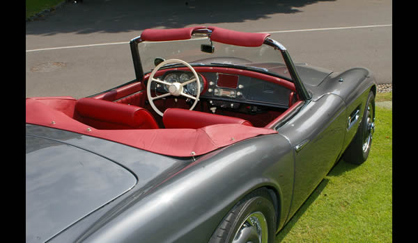

It’s 5-07 Day!!!!
Cheers
Dave

Happy 507 day Dave. The 507 car grows on me more each time I see a picture of one. I'm really diggin that wall art (race track) next the the first photo on today's post. Would love that in my garage.
Phil

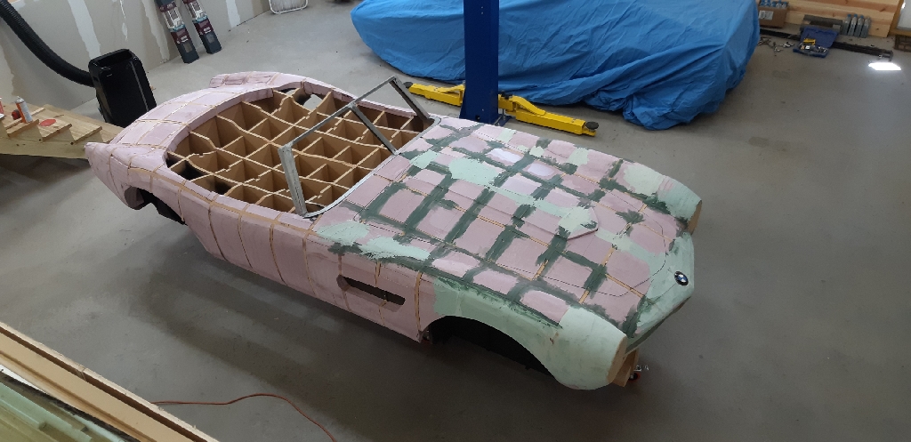

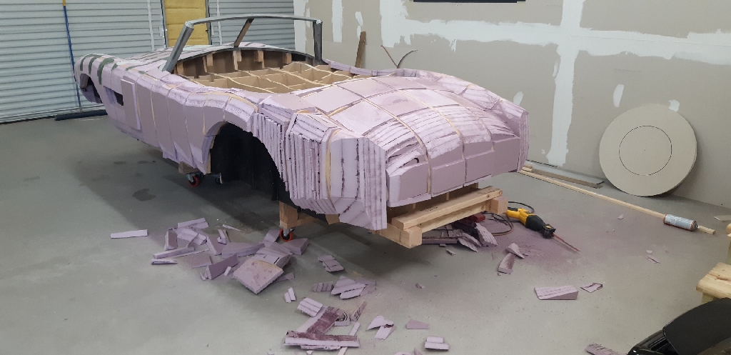

Spent a few hours each day this week in between primer coats drying on the Cuda to get the rest of the foam on the 507. Started sculpting too! Getting to look like a car in a Pinky, foamy, non-metallic way!
I'm on the hunt for the donor car now!
Cheers
Dave

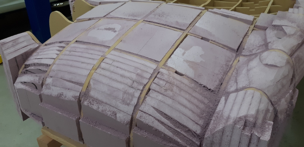

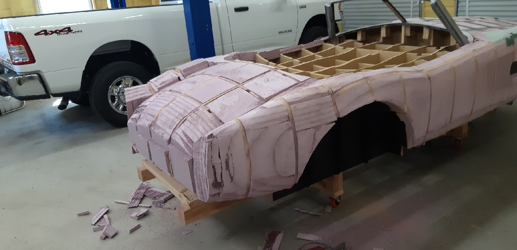

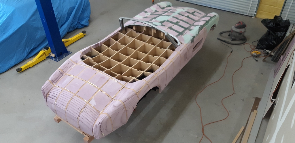

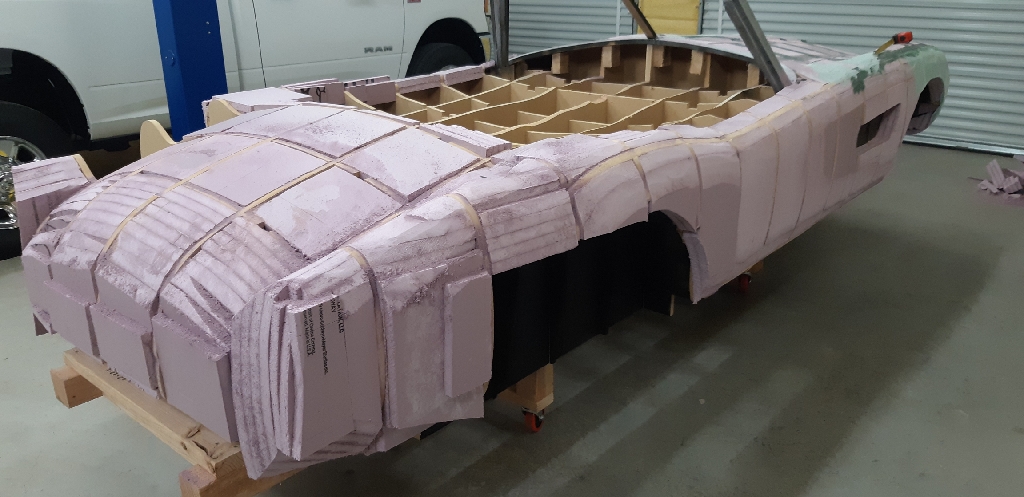

After getting the Cuda blocked out and primed, I jumped back on the 507 and got the rest of the foam sculpted. A couple areas I need to go back over some more since I'm not happy with the lines, but overall, the shape is there!
Up next will be the bodywork. I'm thinking a may glass this with one layer just to hold everything together, then start the bodywork on top of that.
More to come as it takes shape!
Cheers
Dave
