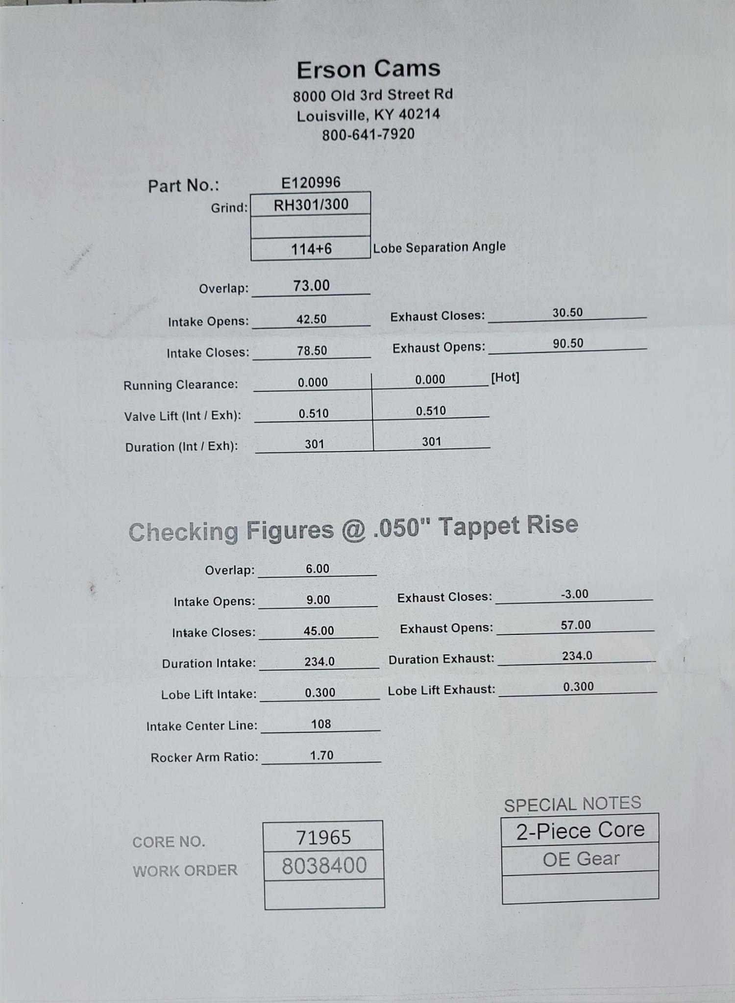

Default Erson L78/Ls6 Roller Cam and Specs
Not in there catalogue online but they do have it if you call

Erson doesn't seem to have any bbc retro rollers in stock. I entered both the part # and then the grind # on their website and get the message that there is no such part.
How the heck do you buy cams that don't exist ?? LOL.
Well, duh, just saw you wrote it is not in their online catalog...

One stop,
Curious what made you go with Erson cams? I know you had used Comp cams in the past.
I’m in the middle of a L89 rebuild and am trying to decide who to go with for my roller cam.
