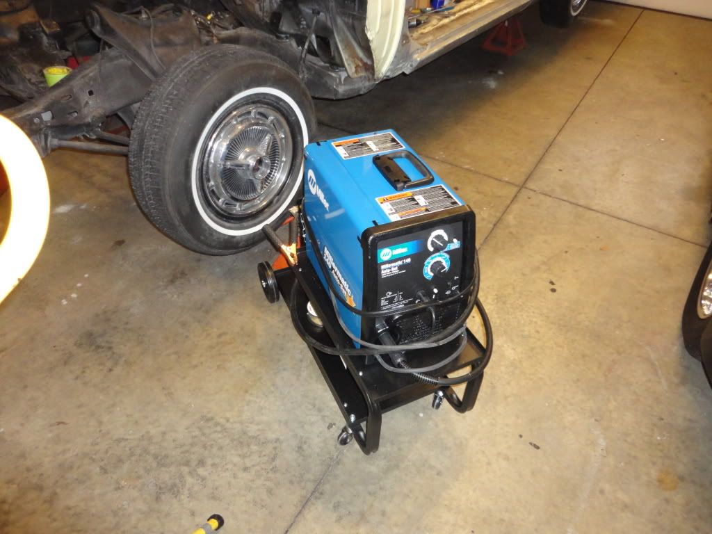

Checked the frame out pretty closely.......Those area's were solid....but...I found a pencil sized hole in the outer frame rail in front of the drivers side rear wheel......started pecking on it and it started to grow.....LOL.....I ended up putting in a couple of small patches after getting to solid metal....I was going to bring the wire welder home from the shop ( my cars are now &quot;Banned&quot; from coming into the shop)but it didn't work out....and.....The Princess left her purse out and I bought a new 115 volt welder for the garage....Wow!! what a machine......Technoligy has come a long way....Zapped the patches in place....Good as new.....sprayed some undercoating and except for the color it's good as new....

I didn't see a gas bottle. Is that a flux-core model?
I have an older Miller Cricket that I still use fairly often (in fact, I used it tonite to tack something on the hood of the '31). Handy as heck! I've thrown it in the back of the truck and done quick repairs on porch railings, basement window frames, exhaust pipes, .......... one of the best investments I ever made!

The Welder is a new Politically correct model........It go's both ways........It is flux core right now.....to switch to gas....add a bottle....change the welding wire and switch two wire in the machine and it's good to go....

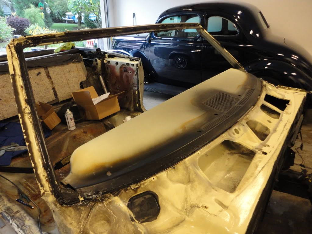

I rebuilt the lower fender mount on the passenger side and took the windshield out........what a surprise....the window channel was like the car was built yesterday......Dodged a bullet there....here are some pic's

The windshield frame is like the day the car was built.....absolutely no rust....
